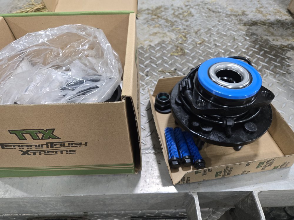

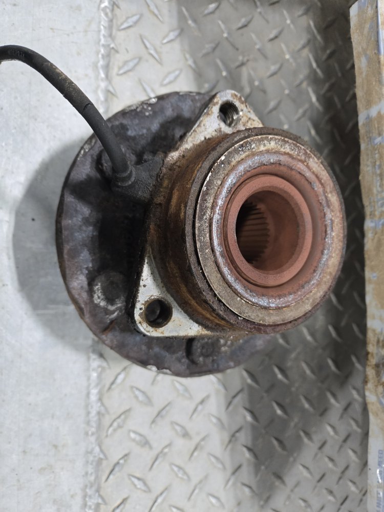

I ended up replacing the passenger hub assembly with a TTX unit, it was roasted!

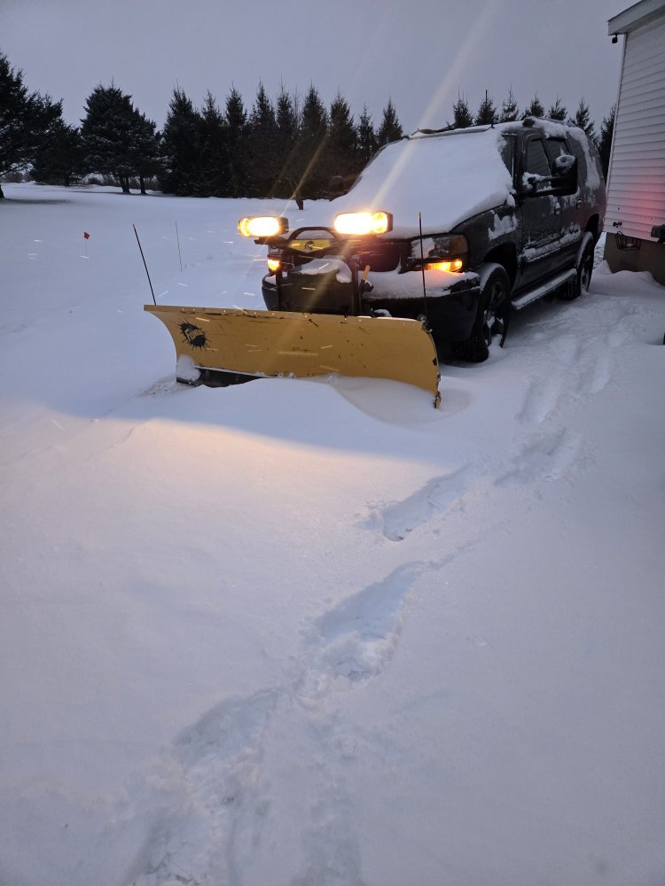

Snow continues. This was yesterday AM:

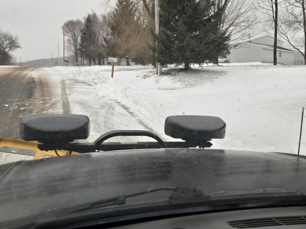

Had to plow again this morning. Pic taken after I got into the company truck.

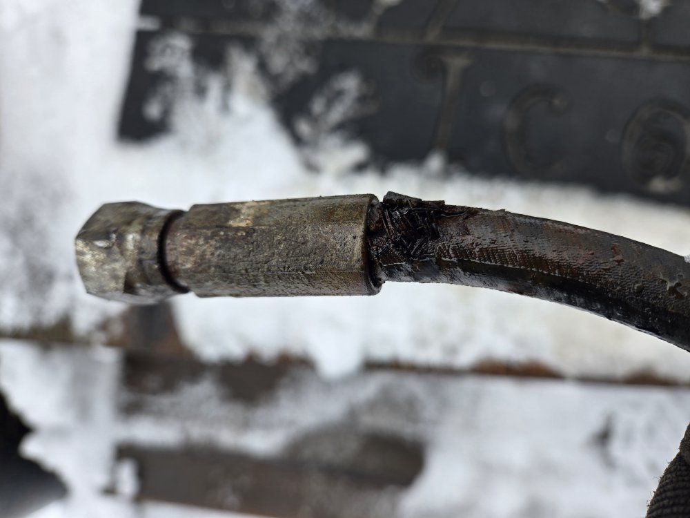

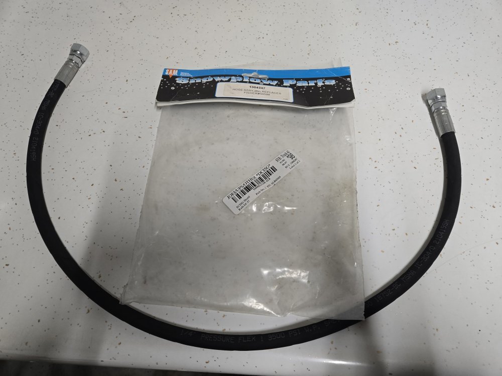

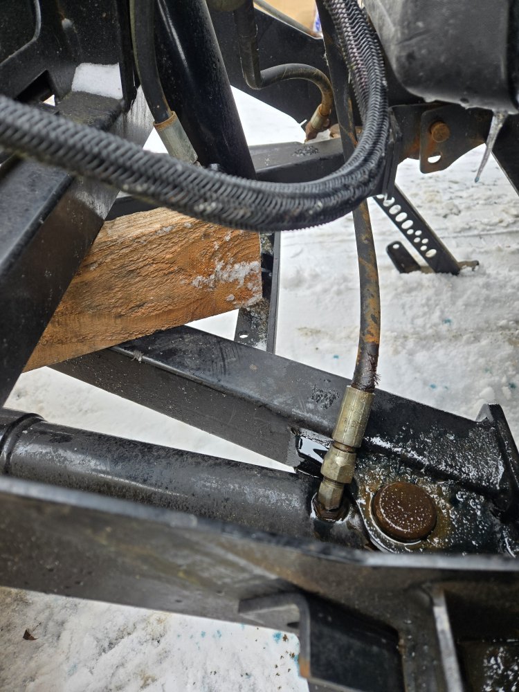

I'm surprised Napa didn't make you the hose! here in my town they are the go to for hydraulic hoses. you take in the old one and they will make it there in the store for you.
My buddy said the same thing when I told him a the custom places were closed. So I went to NAPA requesting a custom hose. Buy by the time I requested 3 feet, plus the 6F JIC crimps it was a $60 hose. Luckily they had the one I bought on the shelf.
$60 for a 3ft #6 hose!! 💩 ain't like it used to be! one would think them using bulk hose and a couple fitting crimped on would come out cheaper than a pre-made one off the shelf... of course that is unless that off the shelf hose is of unknown origin.
