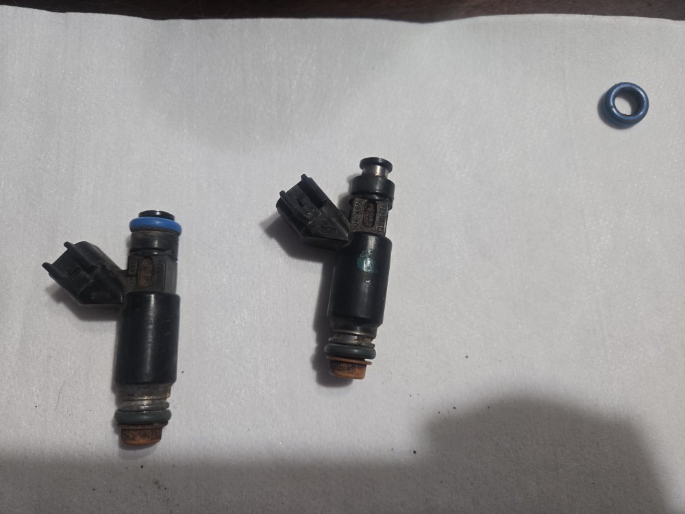

Note, when you go to swap or pull injectors from the rail, have a towel there to cover the holes in the intake port, fuel will come pouring out and some will go into the hole. this will possibly give you a false result when you first start it back up if you don't run it or drive enough to burn out what fuel does go into the ports.
when going back in with them, smear some of that di-electric grease on the o-rings so not to tear them. and if you haven't pulled them before, watch out for the little plastic cups and o-rings on the end that goes into the intake, sometimes they both will come off and stay in the intake.

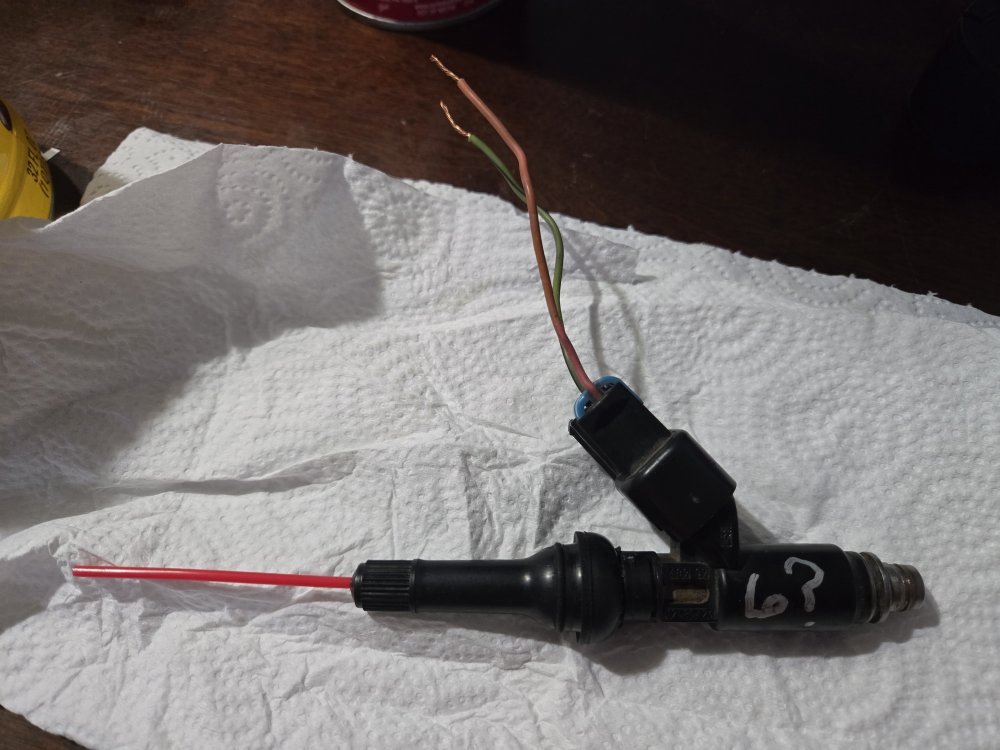

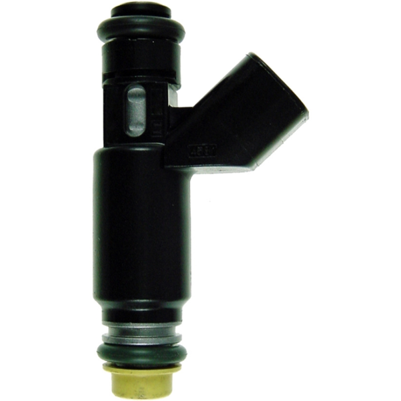

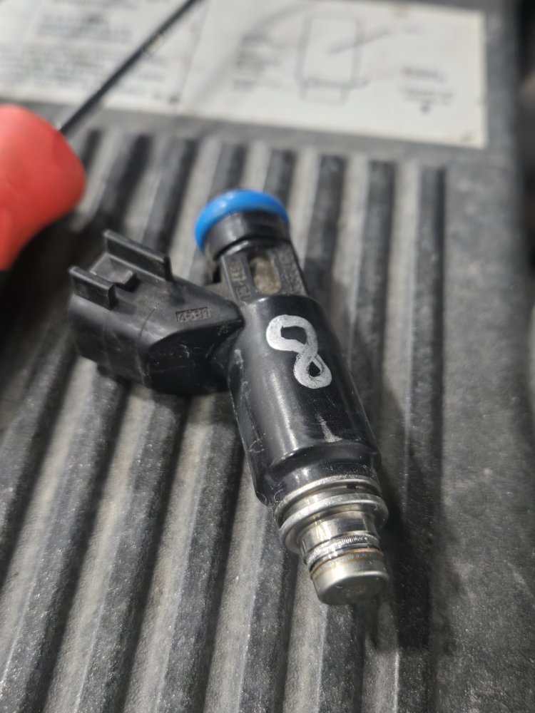

Here is a generic pic of the injector, that little yellow plastic cup and o-ring can come off and stay in the intake.
