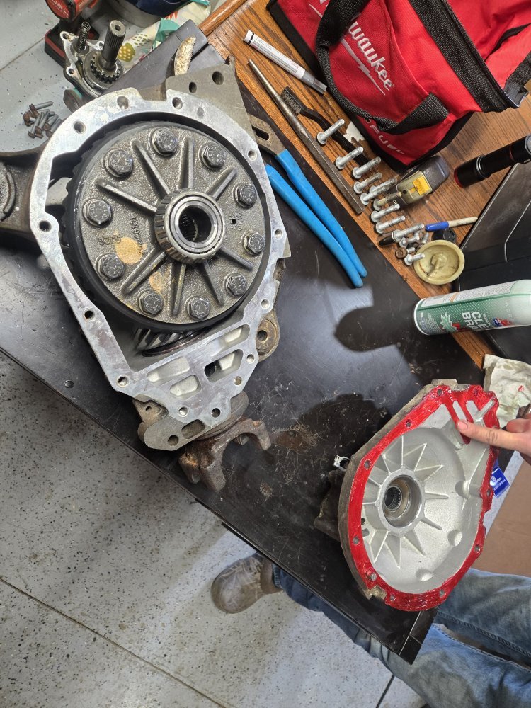

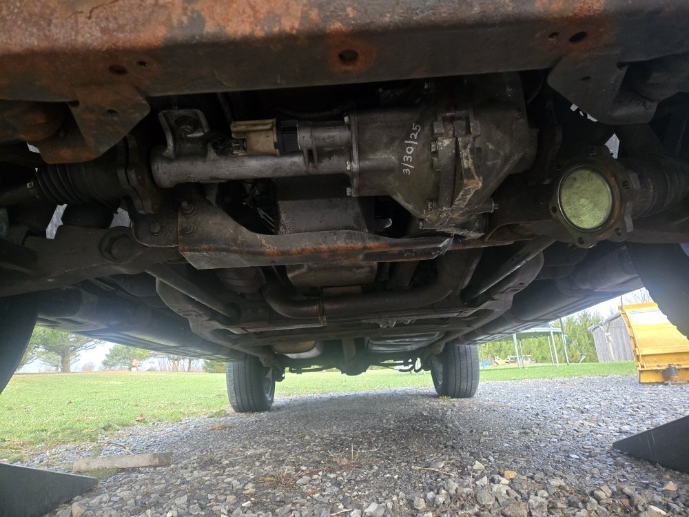

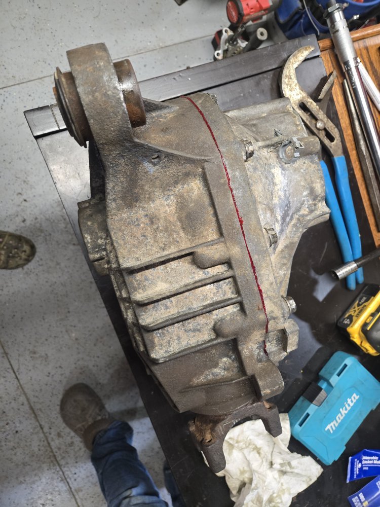

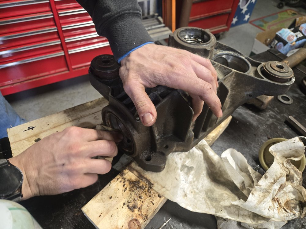

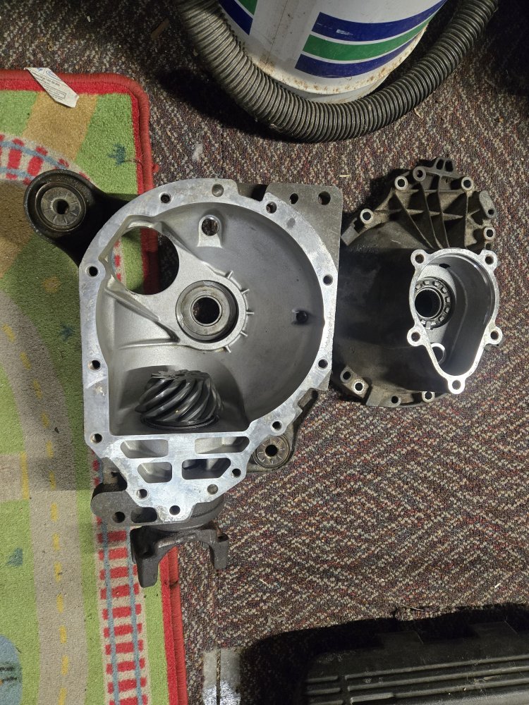

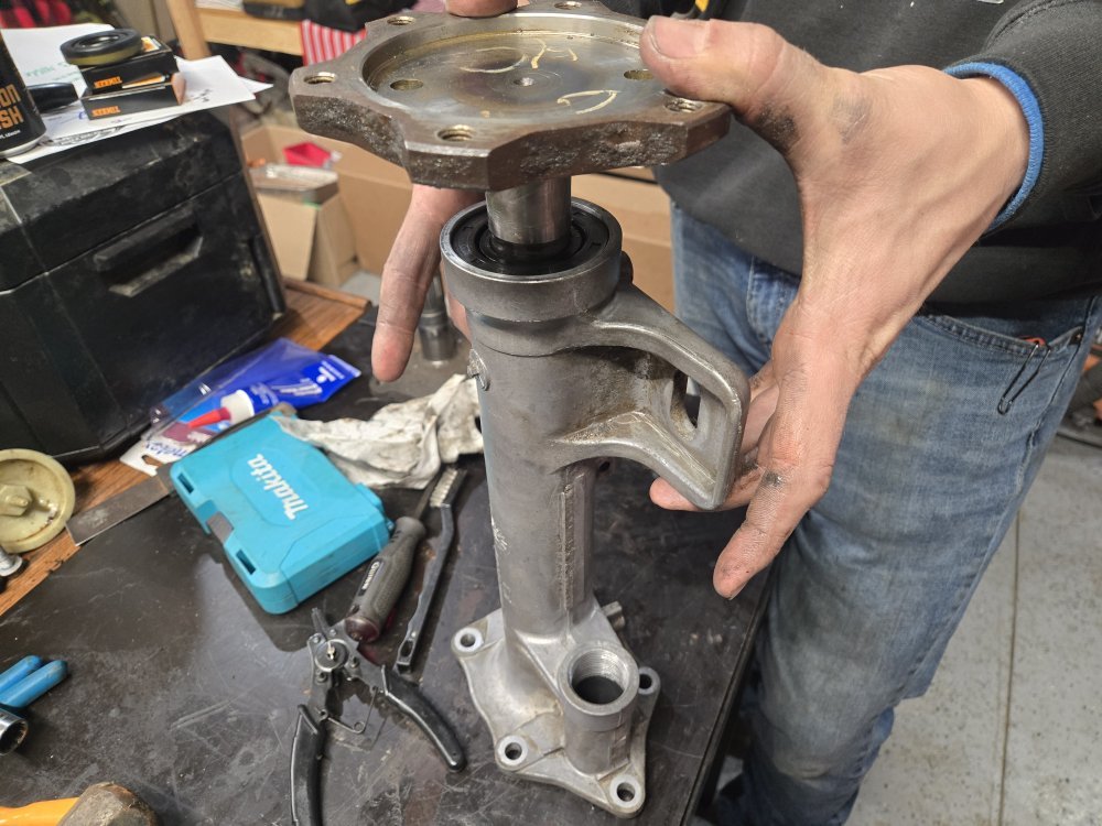

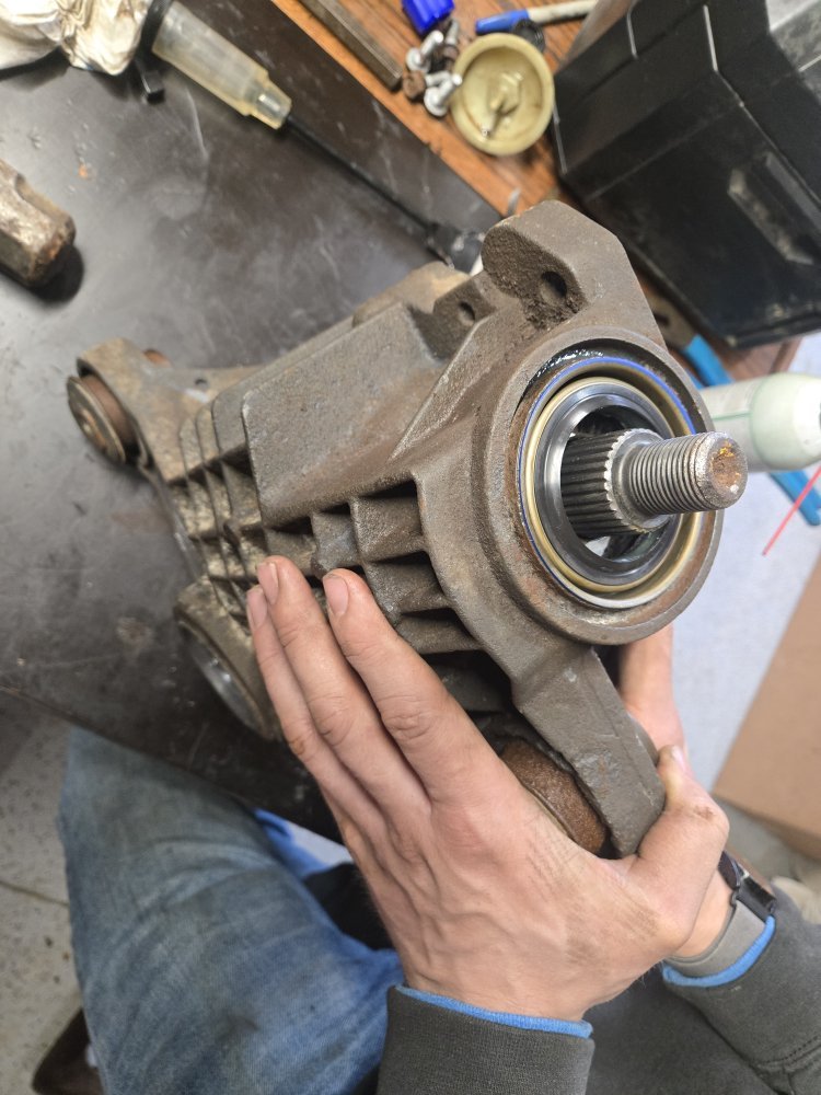

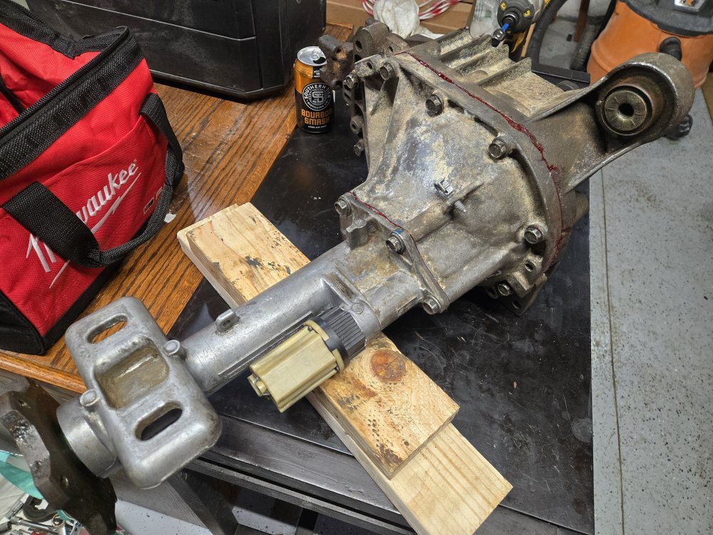

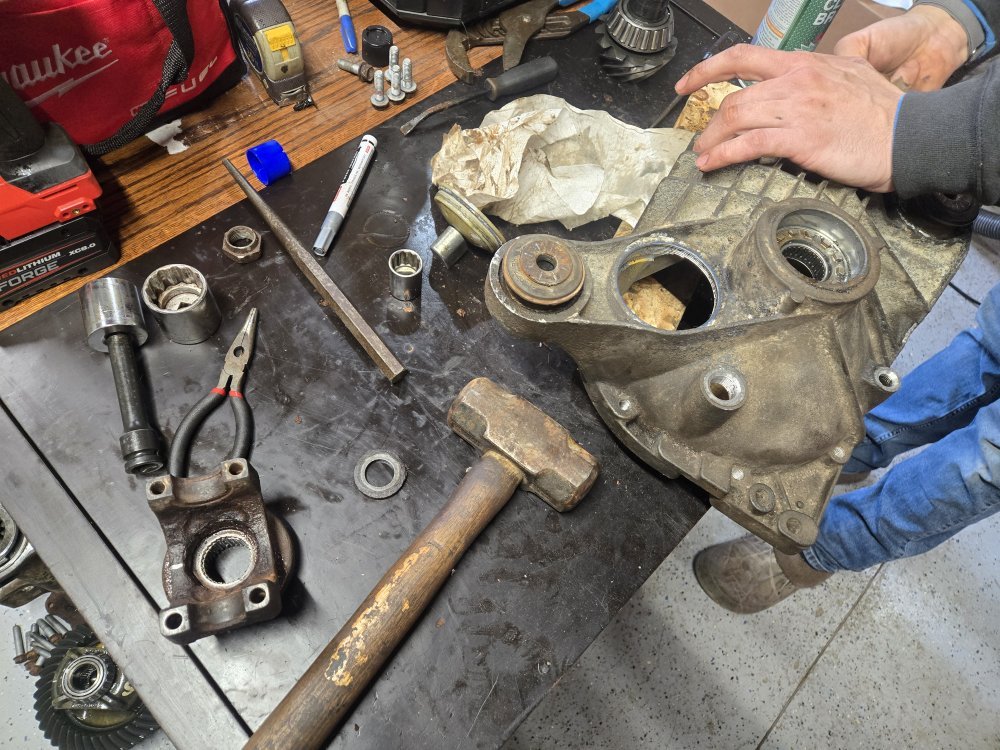

It's together. Got a hodge-podge of parts. I can't find my dial indicator to save my life. We ended up using the donor case, gears, and bearings. Everything was disassembled and throughly cleaned. I pressed out my bushings that were in very good condition to the donor housing. Those bushings were wasted.
We used my internal 4wd engagement bits as the donors were very stripped. Also used my passenger axle tube as the donor was severely disintegrating. Did a thin coat of grease on all bearings to help until gear oil gets spread around.
I feel confident in it, but wish we had more time to do a bearing job and gear compound to check mesh. I couldn't fins issue with any bearings internally on the donor unit. Waiting for the anerobic to cure 24 hours, then will fill with synthetic gear oil.

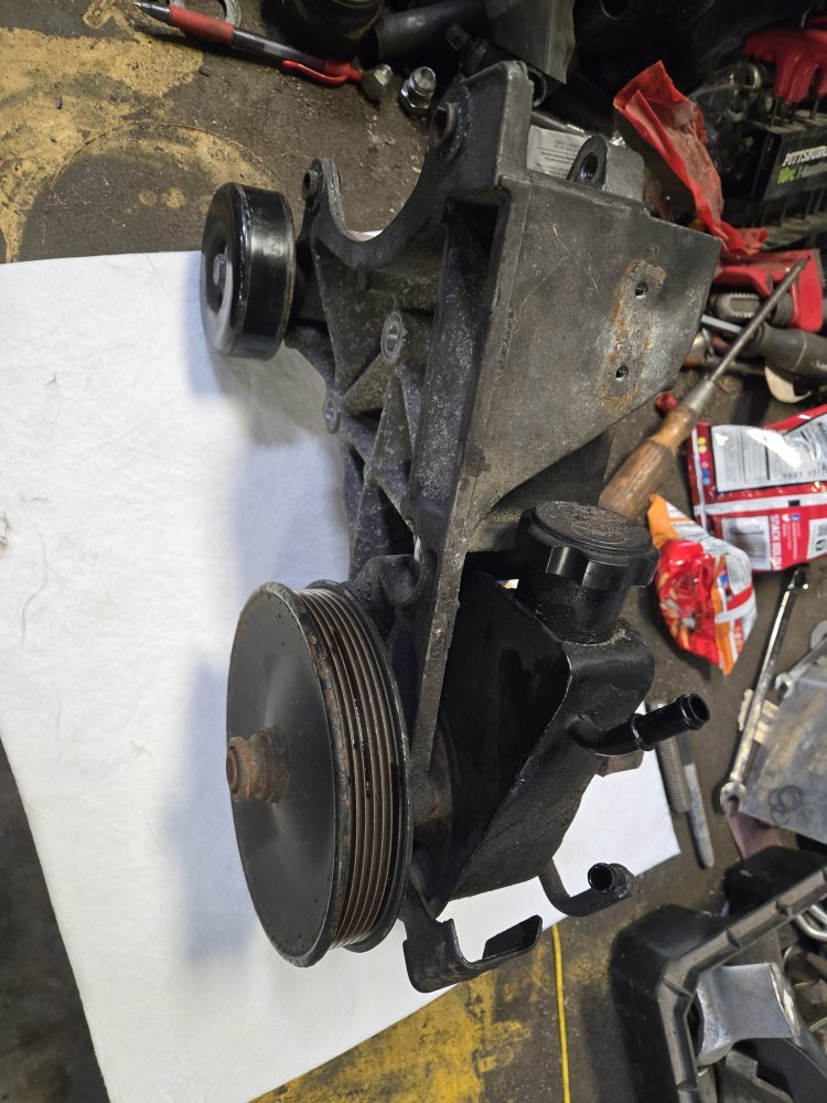

The mutt is in, what a cumbersome piece to install. Test drove went well, all i could hear was rhe annoying power steering pump. I really want to replace it, so annoying being the 2nd pump ive put in. Time to get some miles on, oil change, rear diff fluid swap and t-case fluid check. Fingers crossed its ready to go.
Does that donor have a PS pump you can swap in? just install an inline filter with magnet to save on your steering box and booster, give it a shot. 90%of the time the factory GM pumps that have never been messed with are fairly resilient for many miles!
I think i will be swapping a PS pump, for the 3rd damn time. It's getting noiser, and for a while now low on effort while idle. Fluid is at full and clean.
The first pump was leaking badly, replaced with a Cardone reman, that reman was utter garbage and replaced with a Napa refurb, which i later found out was also a Cardone.
I really don't want to spend $350-450 on a new pump, any other options with success? For some reason the pump my Yukon requires is a bit odd. Non-Y91, and non-BPH RPO codes, which is more than the opposite RPO coded units. I am hydroboost, which may be it but i thought all 04 and newer vehicles automatically had hydroboost on the half tons.

the pumps are mostly the same other than the orifice and pressure valve that lives where the pressure line connects to the pump. you can use a drill bit to check the size of the orifice in the center of the fitting and compare to yours. I would first try it as it is then if it's not to your liking, swap out the orifice and valve + spring and see what it does. iirc it's just three bolts that hold the pump on the engine that are in front behind the pulley.
should be a quick and easy swap so long as you don't need to change pulleys
if the res has an extra return barb, iirc there are metal clips that hold the plastic res to the pump. should be an easy but oily swap too
Ended up with another aftermarket PS pump. This one isn't a reman. It's MUCH quieter throughout all RPM range. I do still have hard steering issues, mostly at a stop while holding the brake. I really need to tear my old one apart and maybe modify/rebuild it.20250409_121917.jpg
