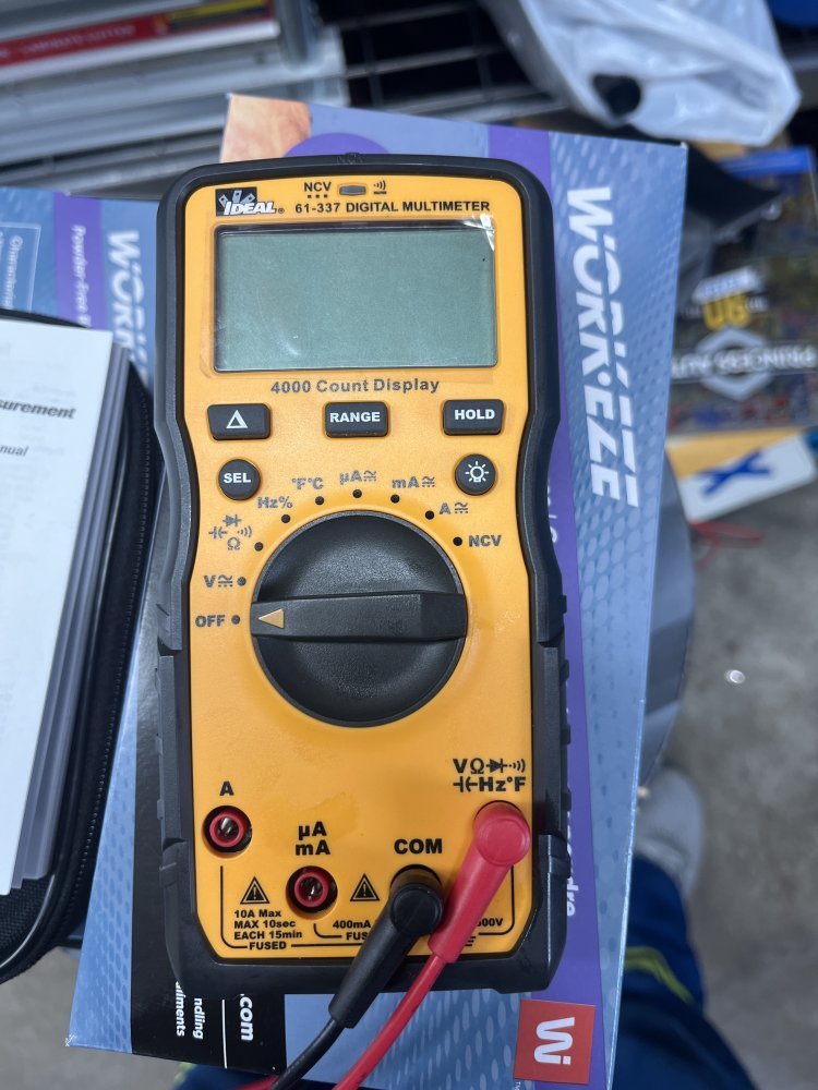

The solenoid has two contacts, one contact is negative from the battery, connect the plus of the battery to one of the multimeter probes, connect the second multimeter probe to the second contact of the solenoid. In this case, the multimeter must be in current measurement mode and the probes must be included in the corresponding contacts of the multimeter. If there is a photo of your multimeter, I will tell you in more detail.

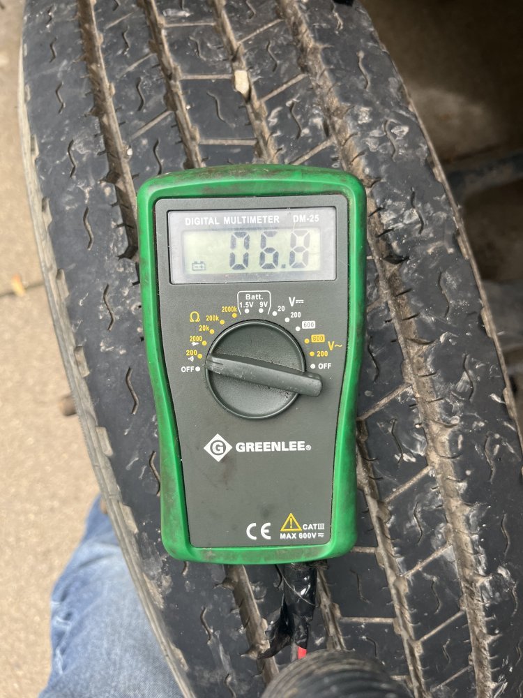

Do you have another multimeter? This one does not measure current. Or you need to purchase a shunt (a resistor with a very small resistance, for example 0.01 Ohm). I think the accuracy of your multimeter in resistance measurement mode is not very good.
Would this one be better I can go buy another one

If you tell me what I need to look for in a meter I will order one
AstroAI Digital Multimeter TRMS 4000 Counts with DC AC voltmeter and Auto-Ranging Fast Accurately Measures Voltage, Current, Resistance, Capacitance, Temperature, Continuity, Frequency and Duty-Cycle. https://a.co/d/86wp6nR
1000V 20A Multimeter Test Leads Probes Banana Plug, Digital Multimeter Probes Electrical Test Probe and 2 Set Alligator Clips https://a.co/d/d44cwjD

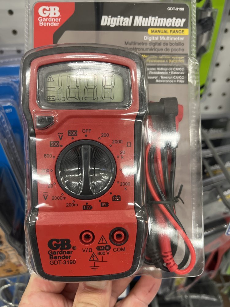

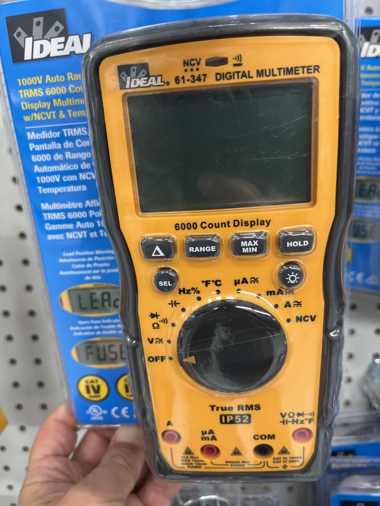

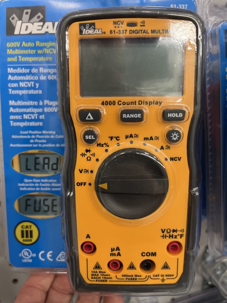

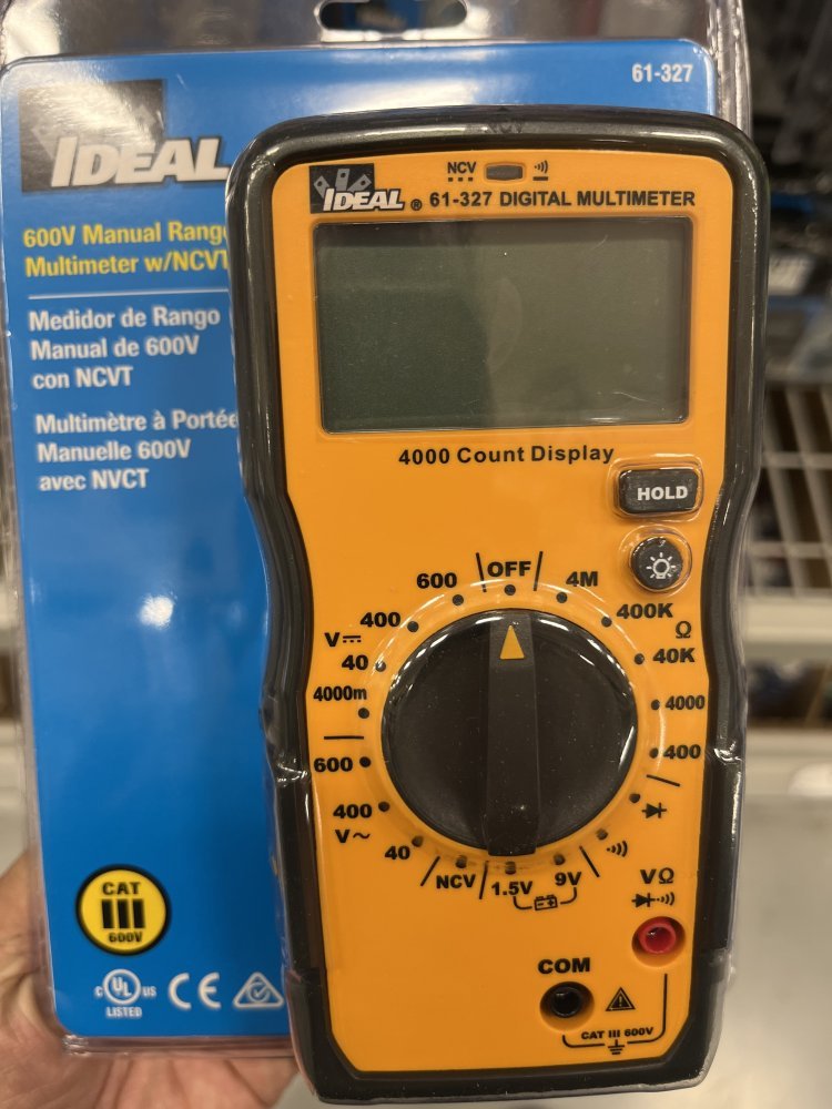

Any of the 4 picture above work as I can get them today at Lowe’s
