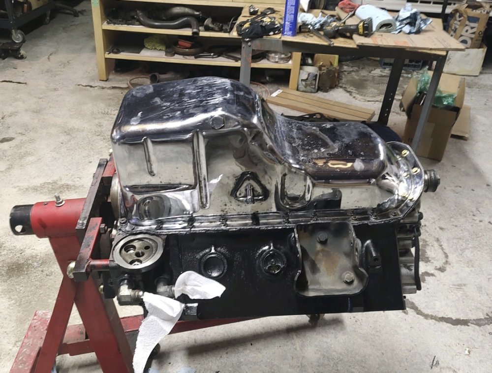

Yeah, pan is close to the HB but, the bolts go in different from what I recalled in my morning fog. Was about to post that. While trying to find a picture of the studs I did discover why a shouldn’t post so soon after waking up having finally slept in past 3:30… I ‘remembered wrong’ the angles of the oil pan’s front bolts (and that I’d used bolt up there vs. studs).
Anyway, here ya go.
I was thinking about finding some studs and nuts for it. I think I have some slightly longer bolts I can use in the front going into the timing cover then fill as many holes in the block with the others I have. even if I am missing a few, I think it will be find to do a test fire on for now.

FYI, those front bolts on the lip of the oil pan aren't needed, the p400 doesn't use them, the holes are there but no threads, and if correct sealant is used no leaks...

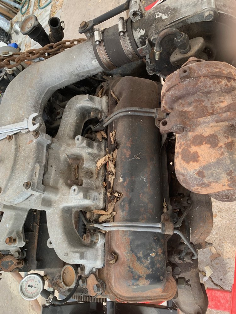

Well I’ve been messing with it off and on this afternoon between doing other things. It’s cranking slowly due to my makeshift cables on it but with me cycling one GP at a time I’ve gotten it to bust off twice but as soon as it busts off it dies and a plume of black smoke appears. I’ve pulled all the GP’s back out and cranked it and all 8 holes are misting a good amount of fuel.
Funny thing is when I kill power to the inline solenoid it continues to mist fuel but slowly Peter’s off enough to tell it drastically lessens the fuel pushing through the injectors but never stops misting completely. This is scaring me thinking that it might be flooding fuel with the solenoid allowing fuel through the return line and just lessening it as the solenoid blocks off the return.

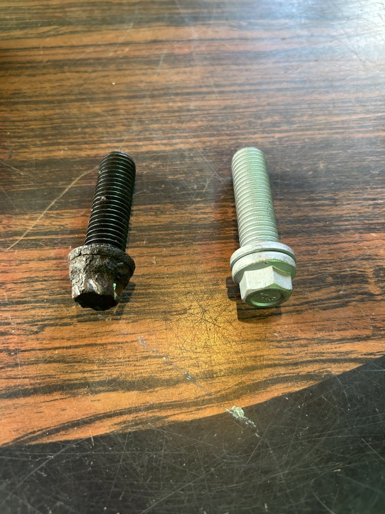

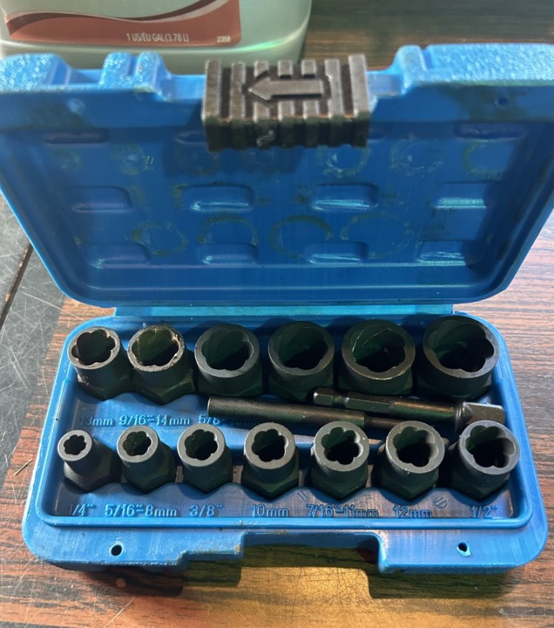

Today I took apart the front suspension on the 96 Chevy.And I have to say without these extractor sockets I would have never got those wheel bearing bolts out.They were in very bad shape.I have new dorman replacements going in when I reassemble everything.This socket set is worth its weight in gold.

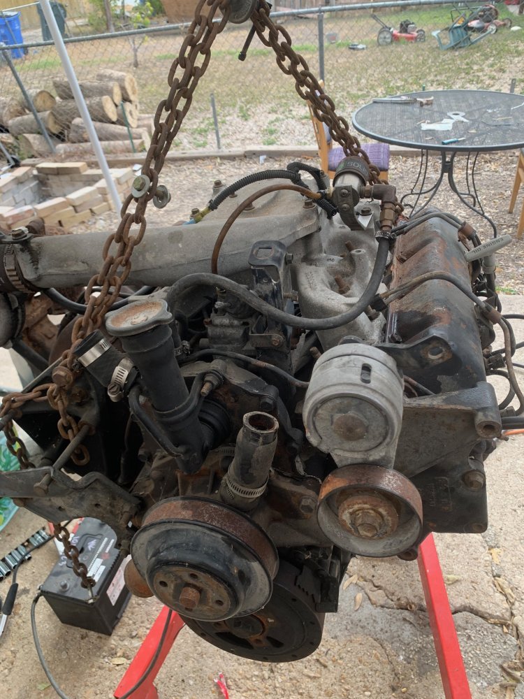

Started this morning with the engine on the stand re-working my makeshift battery cables using junk around the yard. had an old set of jumper cables that the clamps were toast. snipped the clamps off and made ends on them to double up on the cable size going to the starter. wired in a second battery too. Now it cranks much better.
Just fiddling around while I wait for the new fuel shutoff solenoid to arrive. might attempt to cobble up a makeshift harness for the GP's so I'm not touching a hot lead on one at a time before cranking. at least I can power them all at once LOL. Also got a trigger wire on the starter so I can stand back and touch it on the battery. While I'm at it I might try to do something with the turbo oil feed since that rubber fuel line I uses isn't gonna hold up very long. hose is rated for 50psi and I saw 40psi on crank already!
Yesterday while I was attempting to start it, I noticed another oil leak coming from the turbo oil drain pipe right at the gasket where it seals to the turbo, I need to tackle that too and see if I can seal it up and make sure the drain isn't restricted.
