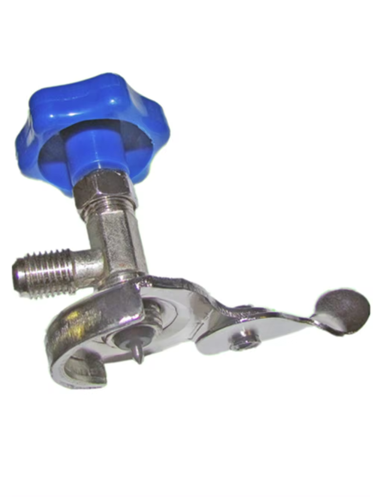

This is the one I use. it punctures the side of the can. it's the old way of charging with cans back when R-12 used the suicide can tap. They changed to a side puncture style which works much better so long as the rubber seal stays in place! when using this one I always make sure I'm not about to pierce the can right on the seam though. for me it's my mind trying to be safe LOL.

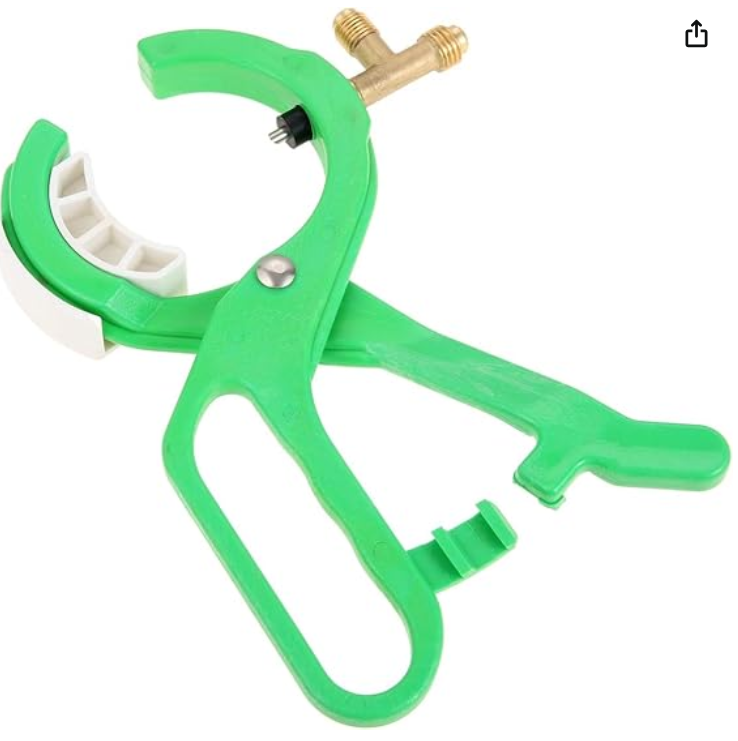

here's a photo of the old one that always blew off the can causing injuries and frost bite.
I will get one of those side can taps on its way.

I have used the suicide versions afore. Still have one hanging round here someplace. 😹😹😹
