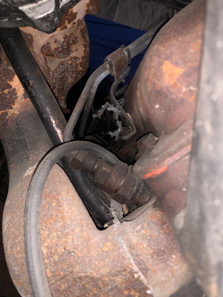

Installed new Rotors and Pads as the old set had developed a bit of a grinding noise on the left. It started right after I had shown my daughter how to retract the caliper piston a bit to get the assy. off when she does her brakes at a later time. Anyway, new set needed breaking in so I went out early this morning, about 4 a.m. so I didn’t upset too many hot heads on their way to work. After several iterations of gradual braking to 5mph the caliper/pad drag was about gone. Much better than before when it was constant and got worse as I sped up. Decided to go for a longer drive south of town to give things more time to sort out. UT 68 is pretty deserted road this time of day. Stopped to get a picture of the Geneva Rock and Gravel quarry at Pelican Point. On the way south, I thought it might make a good shot so on the return home I made sure to stop and see what I could capture. Camera night shot capabilities never cease to amaze.

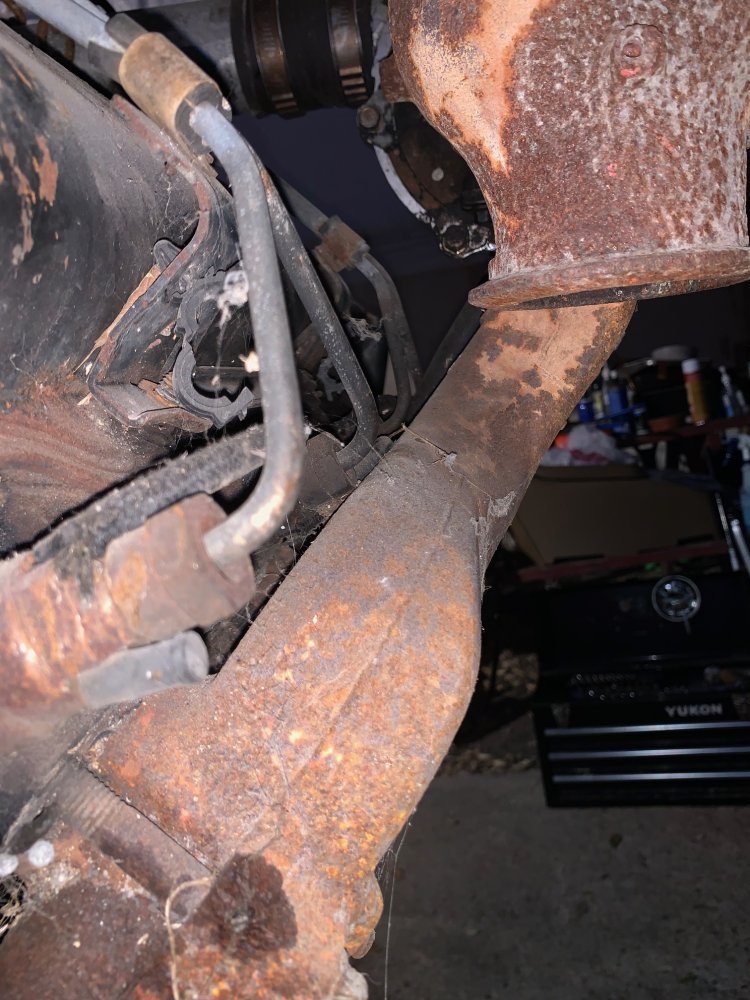

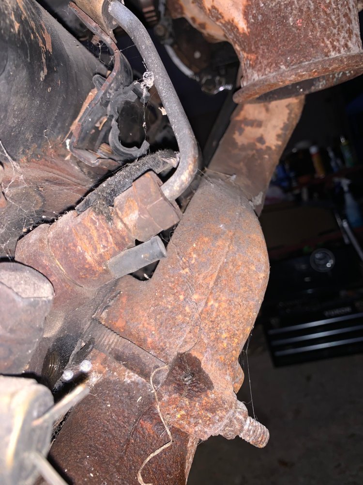

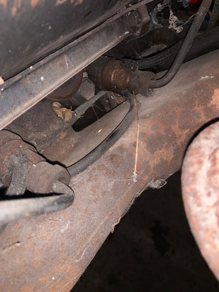

A few days ago I picked up a few front end parts from Amazon for my 96 Chevy truck with the 6.5 goodwrench.Basically it’s a idler arm,idler bracket ,pitman,all tie rods and stabilizer links.I have new Delphi ball joints and two kugel brand wheel bearings.All the front end parts have grease fittings in them which is what I definitely wanted to get.
This truck has been off the road since 2015 and it’s definitely time to get it road ready.Its a rust free truck with new park brake cables,backing plates,drums and axle seals.I stripped it down back in 2015 and started reassembling things when I had the time to do so.

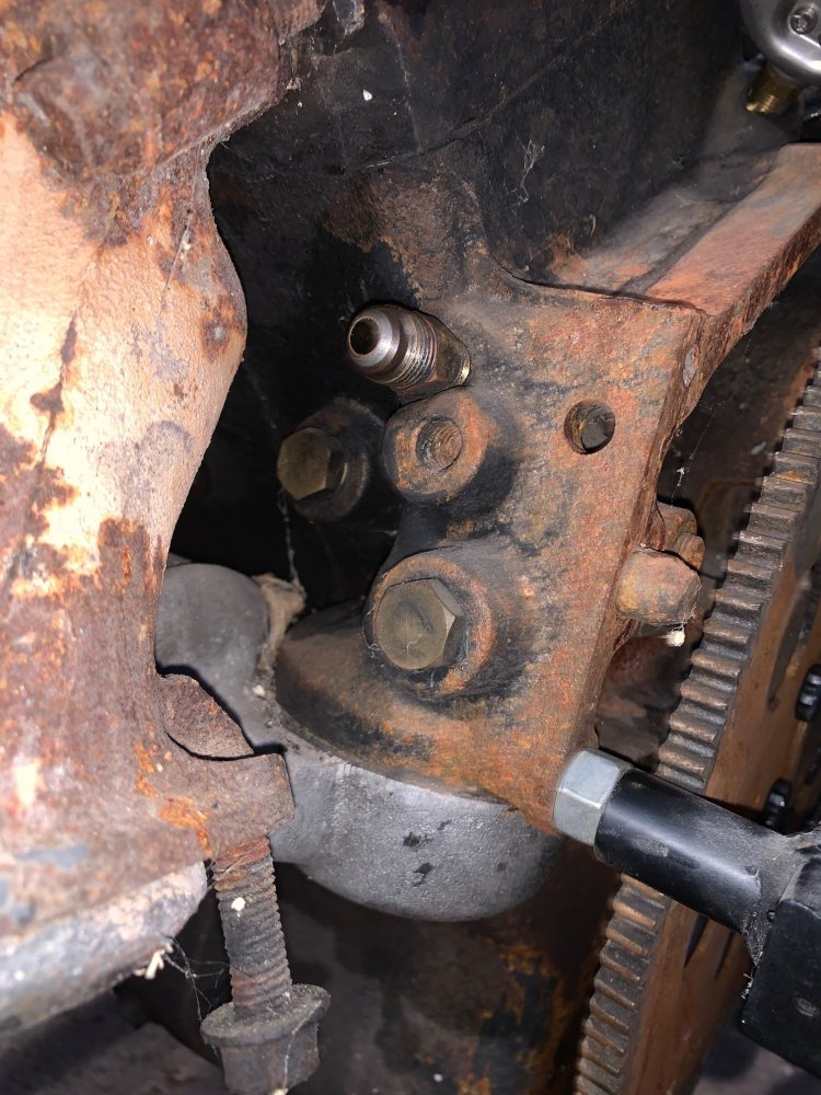

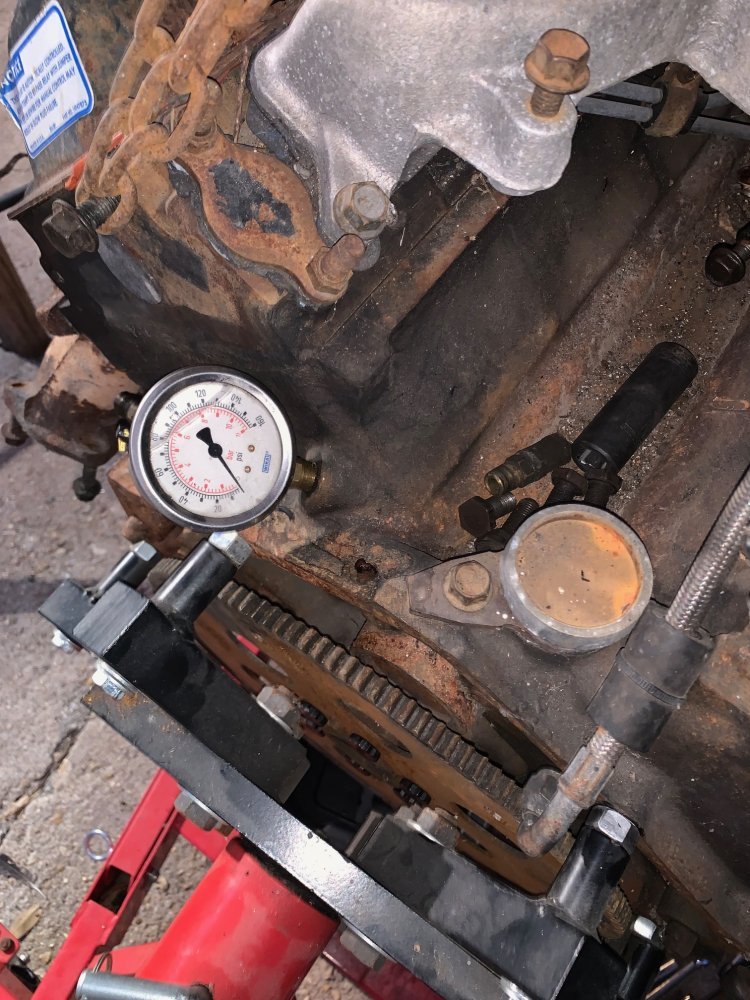

Well after work today I fiddled more with the 6.2 engine. the ARP bolts arrived for the flexplate, got that installed and the starter installed too.
squirted some penetrate oil into the cylinders after removing the GP's for now and took my ratchet on the HB bolt and rotated the engine over a few revolutions. it turned easily with the GP's out. no catches. threaded a gauge into the oil port where the sensor goes. Then I started looking at the other oil port where the line goes to the turbo feed. I had stolen the oil feed line for the 93 since this is what ultimately caused it to get parked by the PO. There was a steel line that connected to a port above the oil filter and ran over tot he valley where the hose connected and went to the turbo. since I don't have a hose for the turbo I am thinking about running a copper tube from above the oil filter over to the turbo and not removing the turbo just yet.

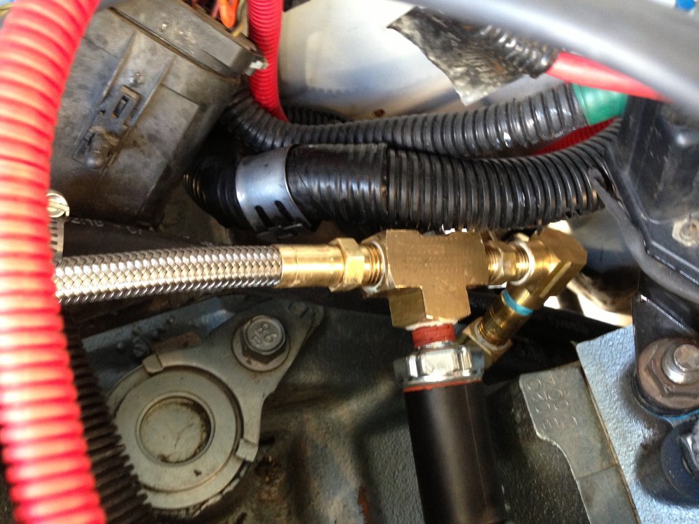

there is two other ports above the oil filter that are plugged off and one that's open which didn't have anything connected. I think that's just a threaded hole but not ported into the engine. I took some photos of the engine showing this area and of how close the injectors are to the manifold turbo side. the line nuts seem to be against the manifold along with one of the return lines flat against the manifold too. This I will need to tend to.
of the photos here, can someone tell me if the oil ports are correct as in the one with the adapter was to feed the turbo and the other two plugged one for oil cooler lines? also are these injectors the long body type or is something off with the exhaust manifold here?

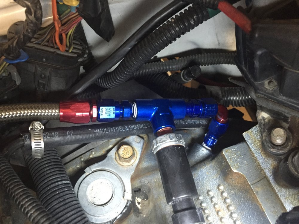

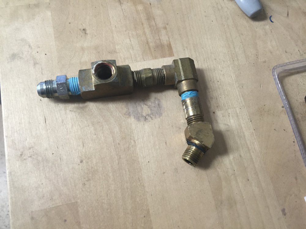

WRT to picture two, shown above, this is where I connected my oil feed line for the turbo. I used a brass 45* with short brass pipes to get things up to where access could be had, T'd it for the OPS and the feed line. The lower port, above the correctly identified oil cooler line ports and where you've currently got an oil hose connector is where I screwed in the sender for my Oil Pressure Gauge's Sender.
On first install, back in 2013 when the engine rebuild was new, it looked like thus but,,,
201202 OPS-TurboFeed.JPG...the hose failed so now there's a 1/4" NPT to -6AM fitting at the "T" vs. the feed hose threading straight in.
Later, I took the brass parts off to try dressing things up with Anodized fittings only to discover that the AN Fittings didn't provide a path to ground for the OPS.
No bueno. Out with the new and in with the old.
