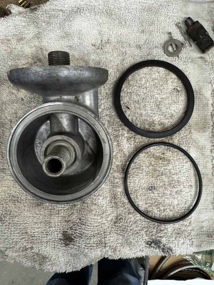

I just checked the oil filter adapter seal kit that I got from Leroy Diesel.
The O ring that fits between the block and the adapter does protrude above the housing groove so it will seal just fine.
The original seal is more like the seal on an oil filter, thick and square.
I guess thats what I was expecting when I ordered the Felpro kit and the O ring in that kit didnt look like it was substantial enough to do the job.
I think I might check the seals on a couple of old oil filters in the drain out bucket and see if one of those seals will fit the adapter, more like the OE seal.

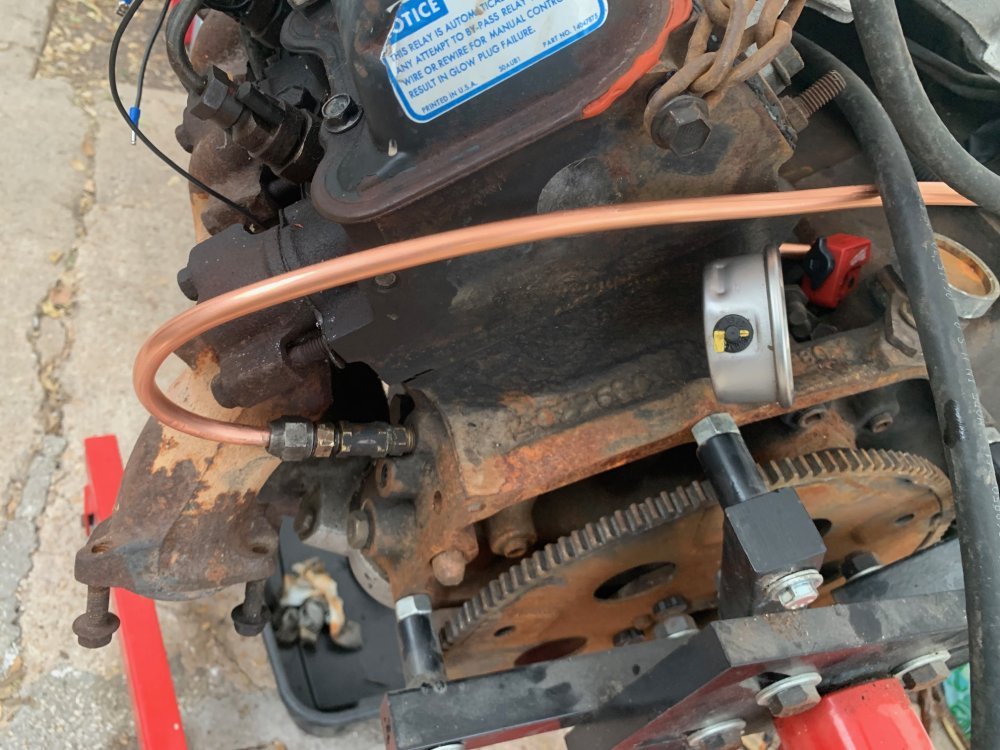

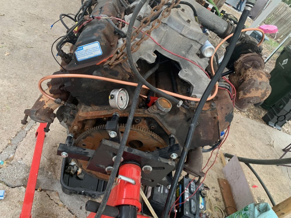

I finally got the copper tubing in place for the turbo feed line. Used the nuts from the old hose and made flares on the tubing. Also sliced a piece of clear tubing I had and used it as an insulator to tie down and secure the tubing. looks decent, but I couldn't bend it as sharp as I had hoped. The solenoid arrived that goes in the top cover of the IP. got that swapped out too but when installing it the top cover didn't "spring" back like I remember when I swapped out the top covers on the 93. I double and triple checked I had it installed correctly, buttoned it down and wired it up.
I plan tomorrow to pull the left side injector lines off and crank on it a bit actuating that solenoid on and off watching fuel from the lines hoping it stops when the solenoid is off.
Here is some photos of the copper oil line I made. also you can see my makeshift harness for the GP's, four spades split out to one wire on both sides. inline fuses at the battery end.
Later if the engine is good, I could make the copper line shorter and look better by using a 90 fitting at both ends, but I also would want to access it behind the manifold when the engine is in the truck too.
BTW if someone happens to have a db2 top cover they can snap a photo showing the angle of the dangle on that lever that would be nice. this solenoid is of chineesium and I don't trust it. the old solenoid was a 24v one and someone ripped out the lever and spring that goes on it. I didn't have any reference to if it was aligned correctly. missing that lever might also have been why if seemed like it was flooding with fuel while cranking and with the other inline solenoid stopping the return line is only slowed down the fuel mist from the GP holes.
Leroy sells the seals as a kit.
What I was not seeing in the seal kits was the size of the original seal.
It didnt seem possible for the skinny O ring to be able to make a proper seal, as compared to the old seal.
It is more like the gasket/seal from an oil filter and in my overthinking, overkill mind could not see how that smaller O ring could possibly protrude far enough to make a proper seal but it will. I’ll run with it.

Hmm, I’m not sure I’ve seen an adapter with that rectangular profile o-ring before. Someone may have used an oil filter gasket in a pinch. I could be wrong though.
Looks mighty substantial to Me.
I installed the OF aadapter, when I removed the oil filter the gasket/seal stuck to the engine side.
I fit it onto the filter adapter and it was a perfect fit.
That could possible be a better option than the O ring.
If ever the O ring begins leaking I will respond with an OF gasket.
