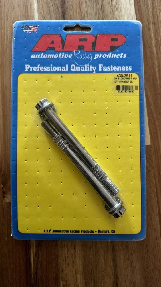

Somehow I missed the info in this post. Thank you. I ordered them this morning. I found the bolts I did have saved after we got home but…3/8”, not M-10. I’d have screwed up and tried these out had it not been for this experience.The part number from arp for the M10 bolts is 430-3511.They fit perfectly.
Not a problem.Glad to help out anyway possible.You’ll definitely like those arp bolts the minute you attempt to install them.They fit quite snug going up into the starter housing.I put antiseize on them just to make things a little easier.Somehow I missed the info in this post. Thank you. I ordered them this morning. I found the bolts I did have saved after we got home but…3/8”, not M-10. I’d have screwed up and tried these out had it not been for this experience.

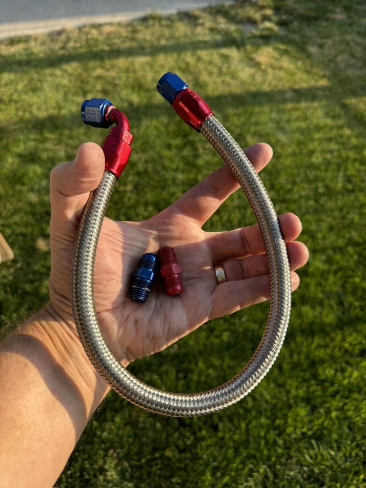

Tow rated to 5000# but one would be really stupid to stress that little power plant for any length of time. Weighs about as much as the truck and on the first tank, got about the same MPGs (20.7 ish) but, lots of idle time trying to unscrew some of the factory settings to what we want and there's not telling if the stealership worker actually filled the tank. Still, not a bad ride.Love this, with the exception of Hitler’s Revengereg.Cut and assembled a 6AN Turbo Oil Feed Line for BigT's new motor. Tested it to 55 PSI with soapy water at all points and no bubbles. Added the x2 NPT-6AN fittings for the motor and the turbo sides too. Otherwise, no bueno.

Swapped in the ARP Starter Bolts and packed up the one I scavenged from BigT when doing the starter cross wire boogie at his place last month. Will bring it, the Turbo Oil Feed Line and the injectors I pop tested (ungood chatter and patterns on most of them) to the salt flats and, when the word comes that his new motor is delivered, will head up there from the Salt Flats.

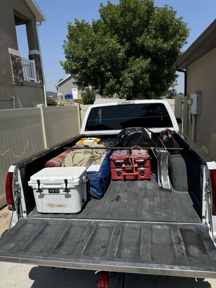

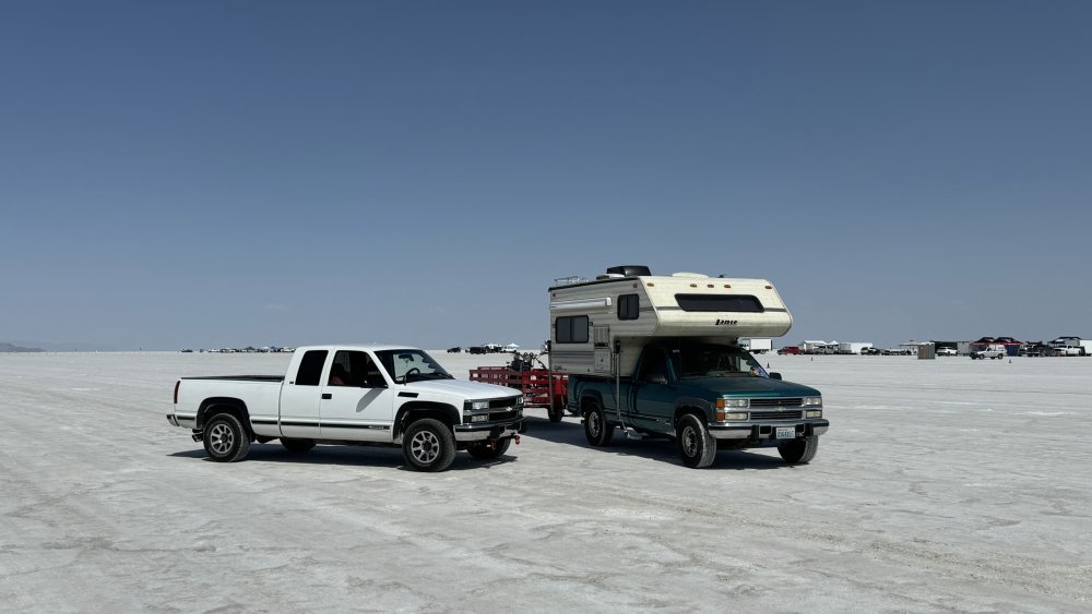

Packed the truck for the Salt Flats. Clothes, tools, EGO batteries, etc. are in the cab.
Will be camping with Heath and a few other folks above the flats through 9 AUG (weather permitting...rain in the forecast starting Tuesday) and during the days, crewing for Mursik Racing and this little VW 1.8 TDI powered go getter. Current record for this class is 130 something. He'll break that and push it up higher.

These might be for the 6.2 blocks that were standard threads, 3/8-16I have a set of those jaws for the vice. And some stuff I don't even remember how to use.
Forgot, until I saw the picture.
ARP Starter bolts 430-3511

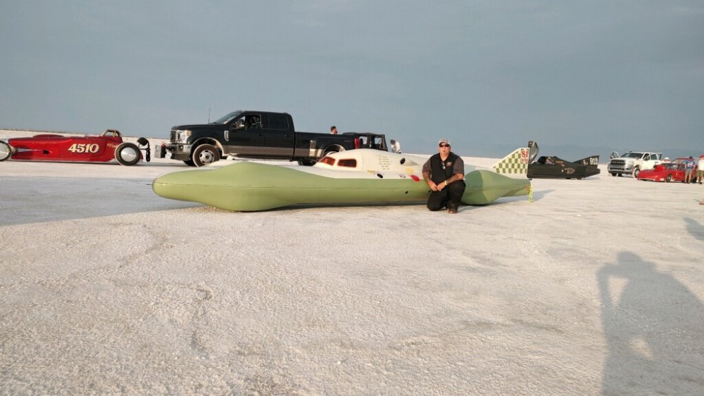

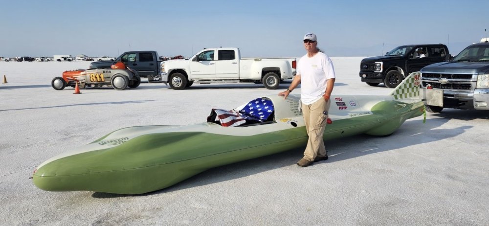

Rest up brotha, because I'm gonna need ya.Hooked up with Bill Heath at Bonneville to crew for Flatliner Racing’s little 1.5L diesel.
Good shake out runs (no record attempts) for next event (World Finals) or next year’s Speed Week in August.
Builder/Owner/Driver with his creation. Paint Scheme inspired by 1952-53 VW “Bus”

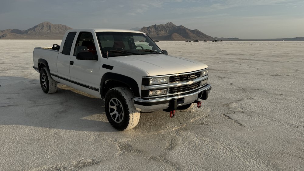

Morning on the Salt is my favorite time

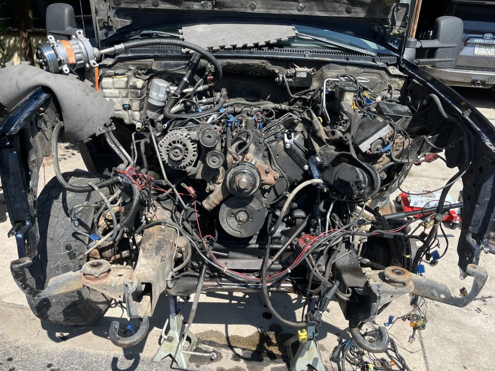

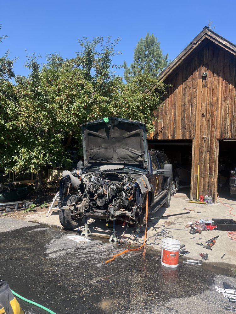

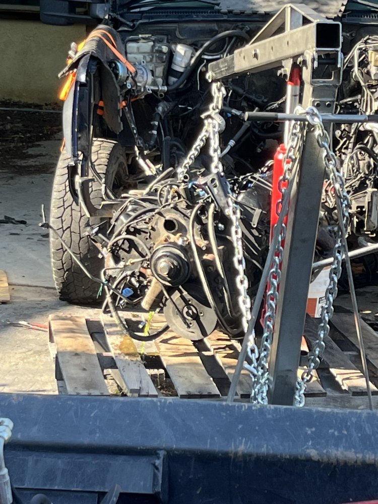

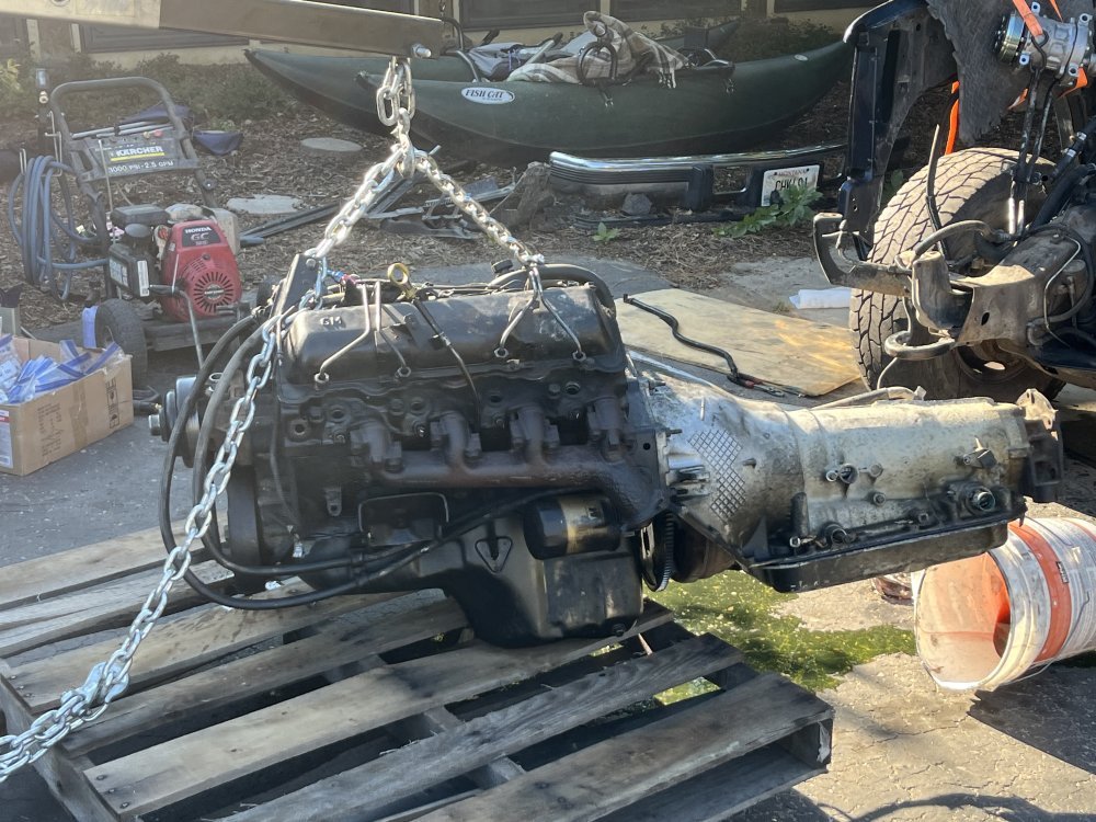

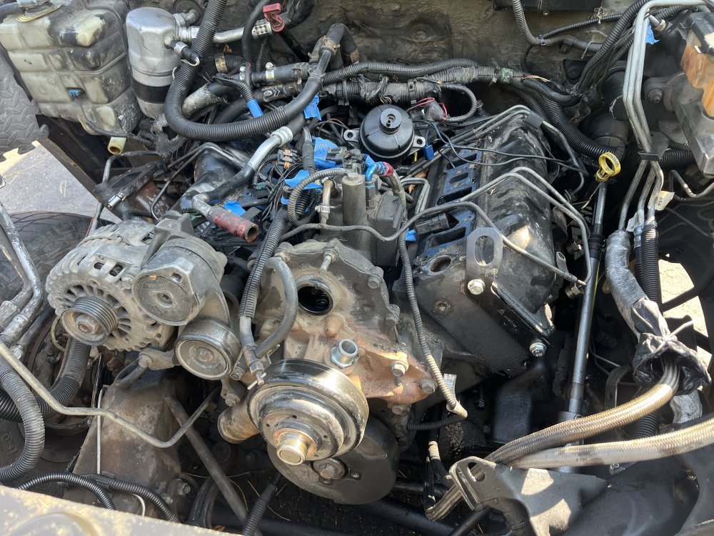

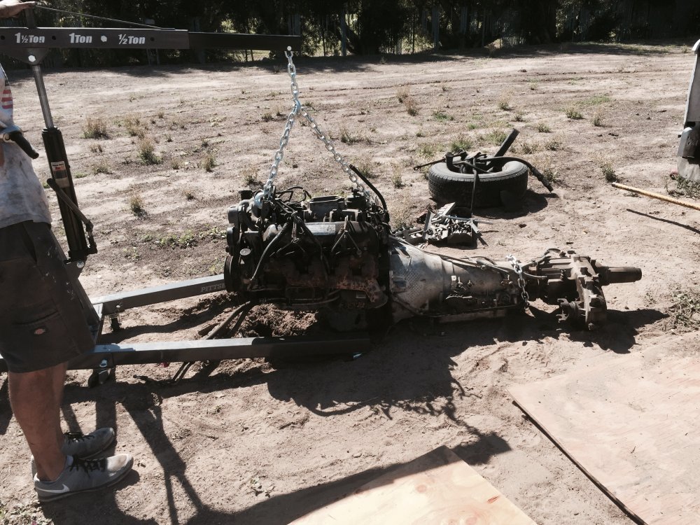

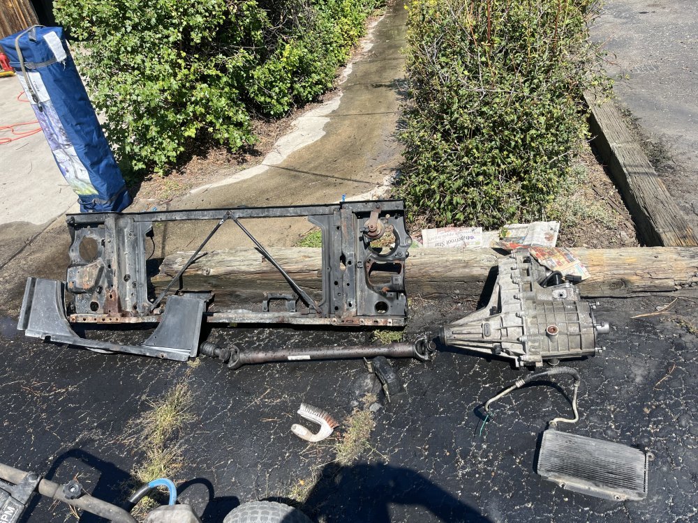

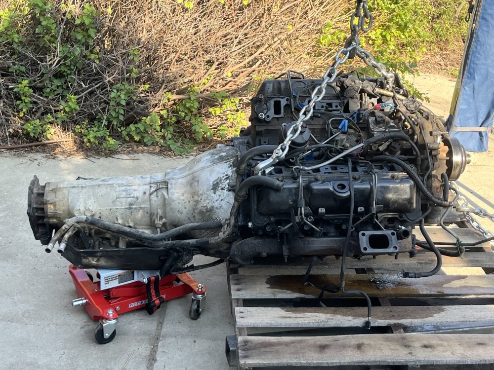

Worked on pulling the engine on the ‘99 Sunurban, but it’s become a bigger job because the engine is seized and can’t be rotated to remove the bolts attaching the torque converter to the flex plate. So we can’t separate engine from transmission and they have to come out together. I will pull the transfer case before pulling the engine and transmission to lighten the load. Will have to pull the radiator core support and we’ll lose the ac refrigerant.

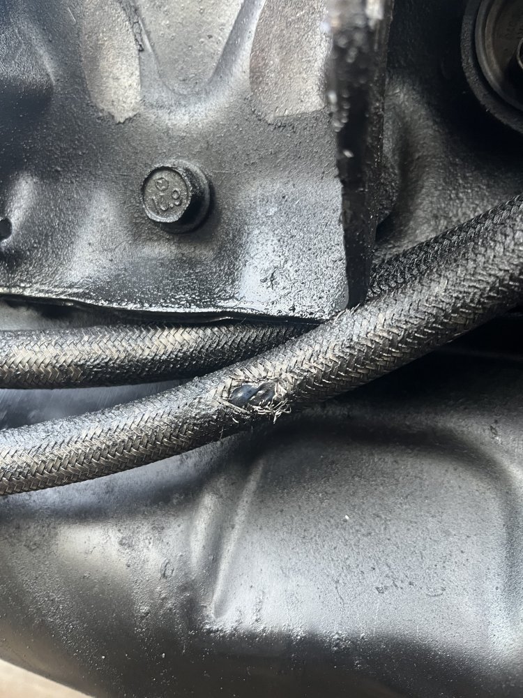

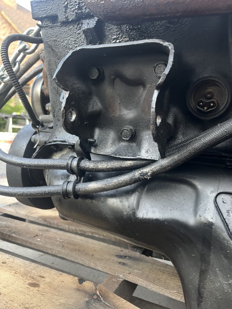

Known cause of death: oil cooler line rubbed through at engine mount. Specifically, found the motor mount bolt (goes through the mount) had lost its nut and had almost fully backed out of the mount. I had the local mech install energy suspension black urethane mounts when I had the transmission replaced two years ago. The passenger side mount and transmission mounts were fine.
