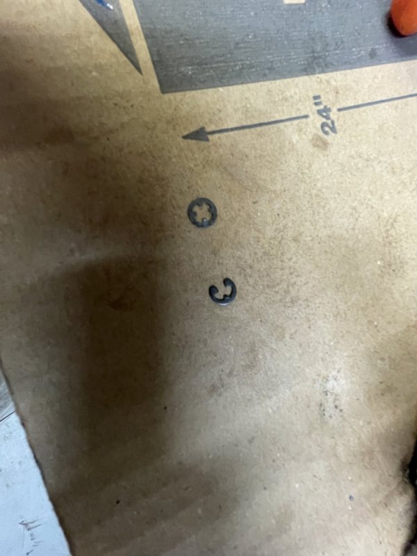

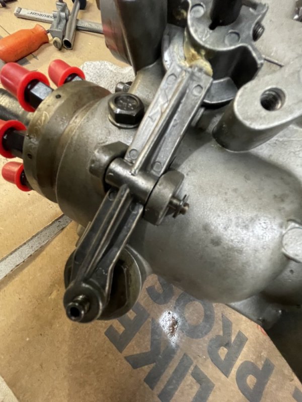

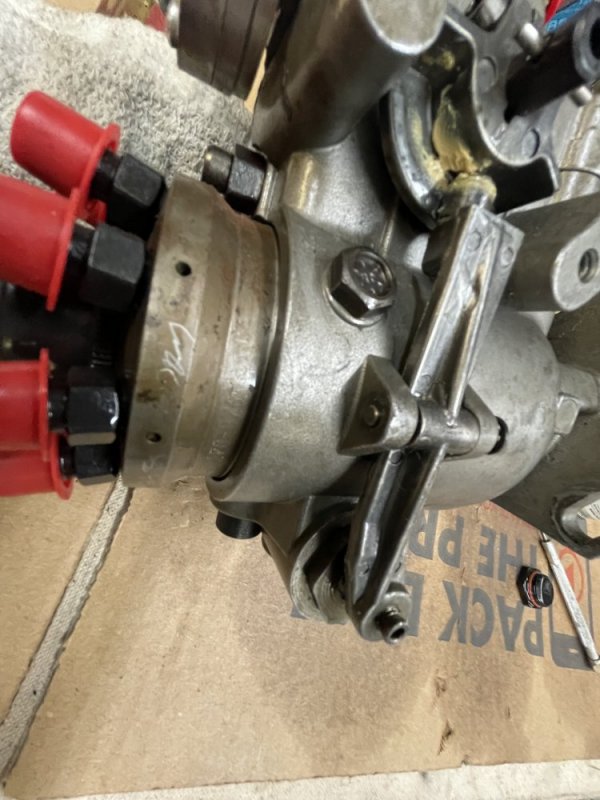

So I messed with the pump a little just know, when I went to pull the pin out of the advance rocker lever I discovered that there was no C clip retainer on one end, I doubt it fell off so it was probably left off. So after removal of the lever I pulled the servo advance plunger, then I took a 45* dental pick and pulled the MECH LLA SPRING, when this happened the servo advance valve sorta laid over on it's side therefore prohibiting it from sliding out the the hole in the plug so I removed the plug and pulled it out. I then moved the servo advance piston back and forth and watched the cam ring moving freely. I sprayed some FreeAll with a red tube nozzle like on a can of brake clean through the advance piston bores to make sure it was clean. So upon reassembly the only thing I thought was a little off was when I put it back together the advance servo piston and its spring pretty much was a press fit to hold them together as one, then I just replaced threaded plug with the spring lined up in it's bore and then installed the servo advance plunger and finally the advance rocker lever. So the only thing I saw off in this whole process was the C clip off the lever pivot shaft and the fact that the servo advance valve spring was not pressed on the the servo advance valve enough to pull it out with the spring. Was it stuck therefore the spring pulled off when I pulled the spring or was it never pressed together like it appears to be the proper fit. Rockabilly please chime in, thx

The spring not being seated on the advance servo is weird. Its a snug fit and I would think it would have seated it self even if they didn't assemble them connected. But as long as you didn't have to physically push the servo out it doesn't sound like it was stuck in there. If it slid right out then I doubt that was the issue. It looks like your timing advance system is in good condition from what I can tell.
