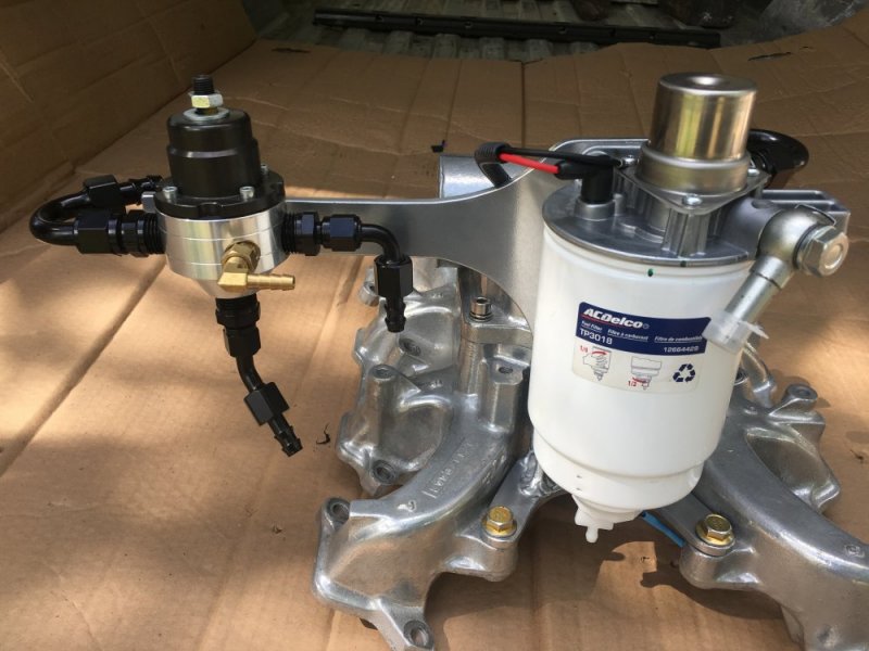

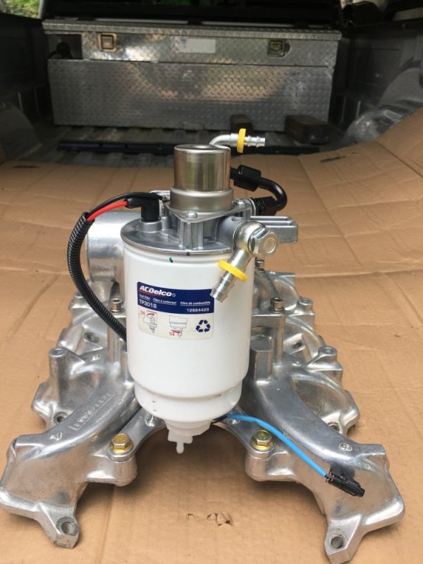

As far as the CDD pump goes about the most technical info I got out of Wes was that the in cab adjustable 150 cc pump eliminates the internal transfer pump and requires a boost referenced return fuel system with a 150 PSI 175 GPH lift pump. I would just need some more info and pros and cons and maybe what my other options are if I don't want the elaborate fuel system even though I have half of the system already made.
Interesting. I never spoke to him too much about the in cab fueling adjustment. But if the timing is locked, then you really wouldn't need the transfer pump anymore.
I know the older tractor pulling guys are big on removing the transfer pump on their pumps. But for a driver, I'm not sure I would eliminate the advance system and transfer pump like that. But you have to give and take if you want that much fuel. I'm shooting for 150cc on my personal truck, and I've got a few tricks I'm going to try to keep the timing advance functional.
Yea, that's my fine line here, this isn't a race truck, it's a driver and I'd like to stop working on it and just drive and enjoy it for a change so I don't want to over complicate it. That's why I would just like to talk to him and figure out the best setup and go from there.

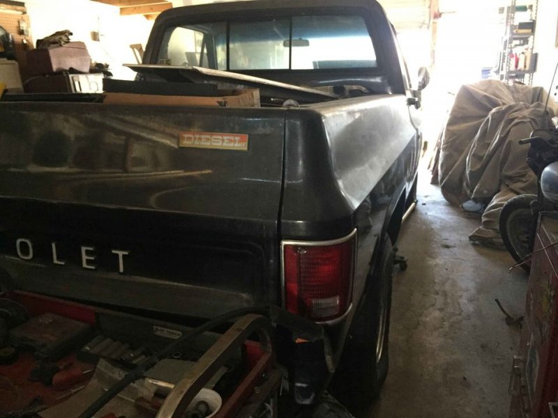

I have a serious problem, I can't get a IP for my P400 build and I want to go buy this and build a 6.5 hot rod truck with all of the xtra 6.5 parts I have! Someone help me!
