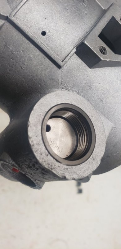

I have the pump off, can I just move the lever on the side of the pump back and forth to see if the piston is stuck?
Take the cap off from the opposite side of the LLA armature. And see if you can push the piston towards the armature. Thats the direction it moves when it advances. If it moves then it could be a worn out bore that wasn't reamed properly. It might be bypassing the piston.
Reaming the housing is a poor repair im my opinion. I have a machine shop that fits them with a steel sleeve. That fixes the design flaw of the advance piston bore. 20201015_204345.jpg
FYI this pump housing has less than 500 miles on it and the head and rotor have never had the transmission put in gear, maybe 1hr of run time max. It was a new DB2833-4974 pump not rebuilt.
