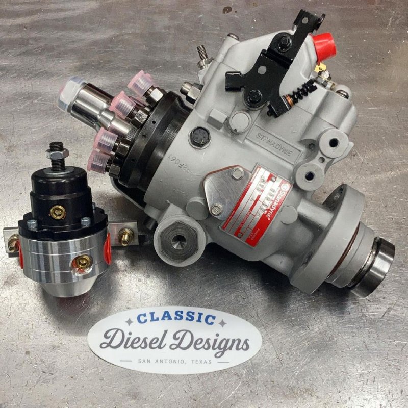

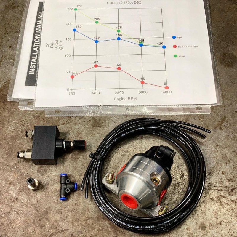

And so how does this work with his in cab fuel adjustment option? Or does he lock the timing on the adjustable unit? I would imagine not if regulated by fuel pressure.
The in cab fueling adjustment is changing inlet pressure. Only works on his locked pumps. Higher inlet pressure helps with higher RPM fueling on rotary pumps.
Transfer pump pressure is around 10psi at idle. If the timing isn't locked and you put 40psi of inlet pressure to it. The timing will advance
