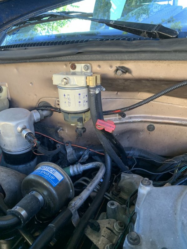

Well. I got to test the fuel lines and found no leaks! But after about 20 minutes with having 15psi on the line by the lift pump toward the engine I saw air pushing through the IP into the clear return line!! Is that normal?
Also since I had air now when I put it all back together I wanted to prime the air from the lines by running the lift for a bit. Well when I bypassed the relays to run the lift. I discovered that the lift has power but is not running. Ahh 😨
Yes Normal. The rotary vane pump in the IP isn't leak free.

No air should go through the fuel system of any noteable amount. A bubble the size of a bb after running for 30 minutes getting trapped is ok. But this- no. That is way too much air in that video.
There is absolutely a leak somewhere allowing too much air in.
Either
1. clear line from the ffm to the ip and id the ip faulty, or pre ip air comes in
2. Pressurize system and find leak.
If the lift pump is identified as bad- replace it and continue examining. If not upgrading to a better lift pump, buy the AC Delco EP158.
To elaborate on how I went about checking for leaks was by disconnecting the steel line behind the lift pump. Threaded an adapter into the lift with a hose and regulator to my air compressor. Set the regulator to 15 psi and started looking closely at all the lines from the lift all the way to the IP. I didn’t see anything leaking at all. Only after about 20 minutes or so while the 15 psi was on the line I noticed bubbles flowing out of the IP into the clear return line so I pulled the air pressure off. Connected the fuel line back on the lift pump and went to prime the air I had forced in with the compressor out and found my lift pump isn’t working. In checking why I found there is power but no ground
When trying to prime the line. I put a jumper wire on the OPS which energized the add on relay to the lift pump. Tested the connection at the lift with a test light and had power but no ground.
