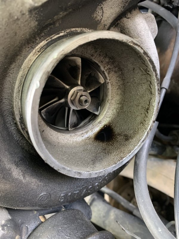

Well I got out there today and pulled the air cleaner and found that there is no snorkel in the fender but I discovered something that I don’t particularly like. I was spinning and playing with the turbo impeller and found that the shaft has some side to side movement. Not sure how much movement is considered to be ok but I can not only feel the movement but can see it also! It’s also coated in oil from the cdr valve.
Oil from cdr is normal. Gm says it ok, but all other manufacturers say oil spray (or anything else) shortens turbo life.
As to freeplay- NONE. If you feel it move- it is done. If you let it go to far it may kill the engine. As turbo man says:
ITS TURBO TIME!
If the turbo lets loose worse case scenario- it can grenade and actually kill you. The parts could go in and stick in valves destroying them, piston if it gets through valve. With the shaft out of the way, all that oil normally lubricating the turbo can feed the engine as unrestricted fuel and cause a run away.
What else- maybe it just rattles doesn’t make proper power (sound familiar?) and eventually just stops spinning.

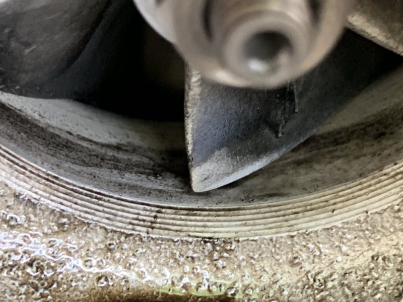

Is the compressor wheel rubbing the housing? A picture of the turbo inlet will help. You can feel a little play in turbo's as the oil pressure comes up and zero's it out. But the clear wear limit is the wheel rubbing the turbo housing. The compressor side oil seal letting go is an engine oil fed diesel runaway.

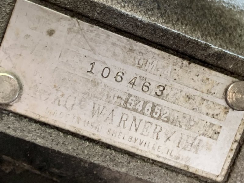

Here’s some photos of the compressor wheel and data tag. I really thought it had a GM-8 but I see the tag shows GM-4

It doesn’t really look like the wheel is touching the housing but by me just using one finger in the wheel spinning it round and round I can feel it seem to catch tension and then free up but not on every revolution, it’s more at random.

Is the compressor wheel rubbing on the housing? I can't tell from the picture.

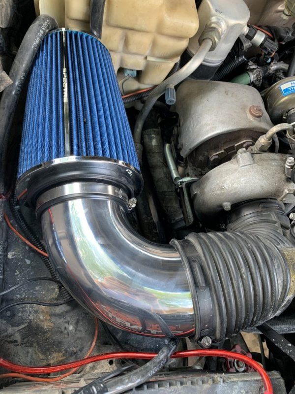

I went ahead and installed a Spectre cone air filter in place of the stock filter. I’ve noticed a decent difference even with a turbo that showing signs of failure. Pickup is better and getting higher boost on light acceleration. Y’all guys are right. It’s time for a bigger turbo. I’ll post a photo if it in a bit
Here’s the photo. One thing I noticed while I was out on a drive, I took an on-ramp that has a decent incline and it boosted almost immediately to 12 psi and stayed there, I was at 60mph in no time :)
