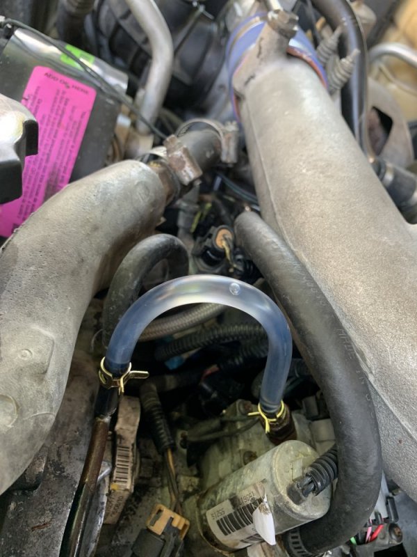

Ok, I got the clear line installed. started it up and didn't see any immediate air in the line, but time will tell after I watch it for a few days. Although when I shut it off a small air bubble floated up from the steel return line. I ran it twice and both times after I turned it off a small air bubble came back, not from the IP side but from the steel return tubing.
I attached a photo of the bubble that floated up after shutdown and also a couple of videos taken with my phone. sorry if the audio is bad. I was using my remote start so I could film it. the one video also shows how bad the blowby is from the dipstick tube with the engine at or close to 185-190 degrees. the other video I has taken right after I had installed the new injectors and new to me turbo. I noticed an unusual knocking noise that seems to be coming from the far back passenger side. maybe from the #8 injector. I was curious if this is normal or something I need to worry about.

The way you describe the little bubbles after shut down, you’re fine. What you would be concerned about is a small trail of bubbles while the engine is running coming out of the IP. You have NO ISSUE in your fuel supply system at this point for air intrusion.

Oh yeah! Saw the video- at start up and at 0:49 mark- HUGE VOLUME OF AIR.
Solve this before doing anything else.
Pressurize fuel line to 15 psi from tank foreword with truck engine off. Find and fix the leak.
