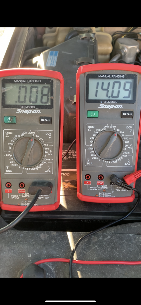

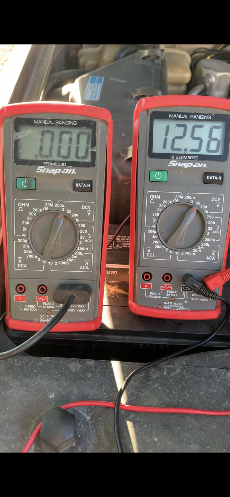

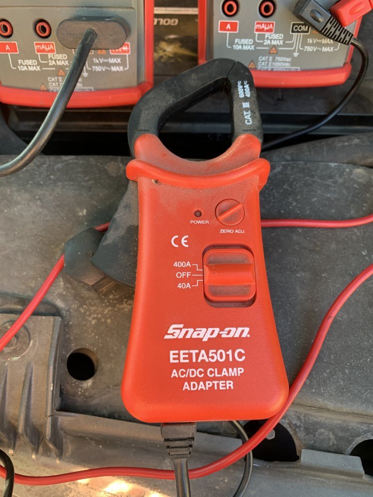

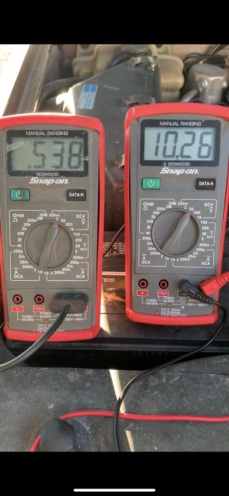

Right now it’s still starting in the first try. Just noticed this seemingly slower cranking recently.
Remember, the cables can look good and be corroded internally. I've load tested at the business end of the cable and found bad cables beforeI will get on it this weekend checking the batteries, cables and such.
