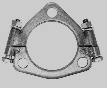

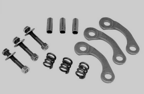

@Stoney back when you were replacing your tranny, did you try those flange repair kits on your crossover pipe? I seem to recall you mentioning those three bolt flange repair kits like these.
View attachment 71744 View attachment 71745
When I replaced the CO pipe on My truck, broke one bolt, left side flange.
I messed with removing the exhaust manifold but the couple of bolts I tried to remove were seized in quite tight and I figured that I’d most likely break several of those too.
Decided that drilling all the way through and adding a nut to the top side of the CO flange was a lot simpler.

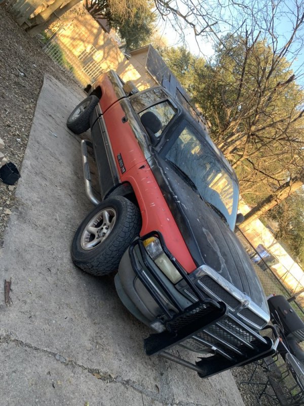

haha! she's been sitting under the pecan tree for a gooood while. 99 model and just about the last of her kind to still have the old cast iron 318 v8. lol she's out lasted just about every vehicle we've had :) gave her a bath with the power washer and topped off all the fluids, ready for her state inspection and license renewal. She'll be my DD for a little while so I can park my beast and get some much needed work and tlc done.
I forgot to post an update on Ole' Betsey.... my future son n law took her to work one day week before last while his Challenger was in the shop for a coolant leak. as he was gettin on the on-ramp of the IH-35 freeway she gave him the "death wobble" !! He babied her home and had been parked in front of the house since. I have to get underneath and see what came loose.
