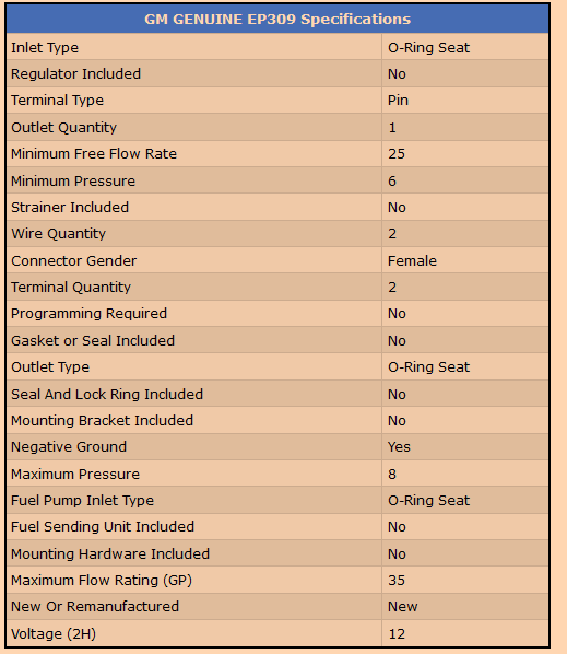

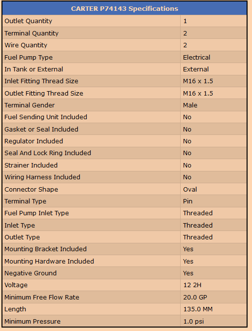

looks like the EP309 is 35gph and 6-8 psi and the Carter P74143 is 20gph and 1 psi since it still worked when I replaced it, I might just swap it back to see if that temporarily fixes the problem.

Fuel pump question. Which one is best for my truck? Looking online the EP309 is rated at 8 psi max and the EP158 is rated at 14psi max. I looked at my old pump and it’s a EP309 but i tried it and it won’t pickup any fuel from the tank.

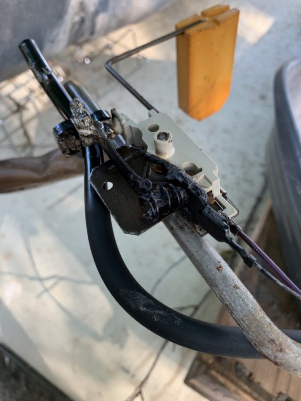

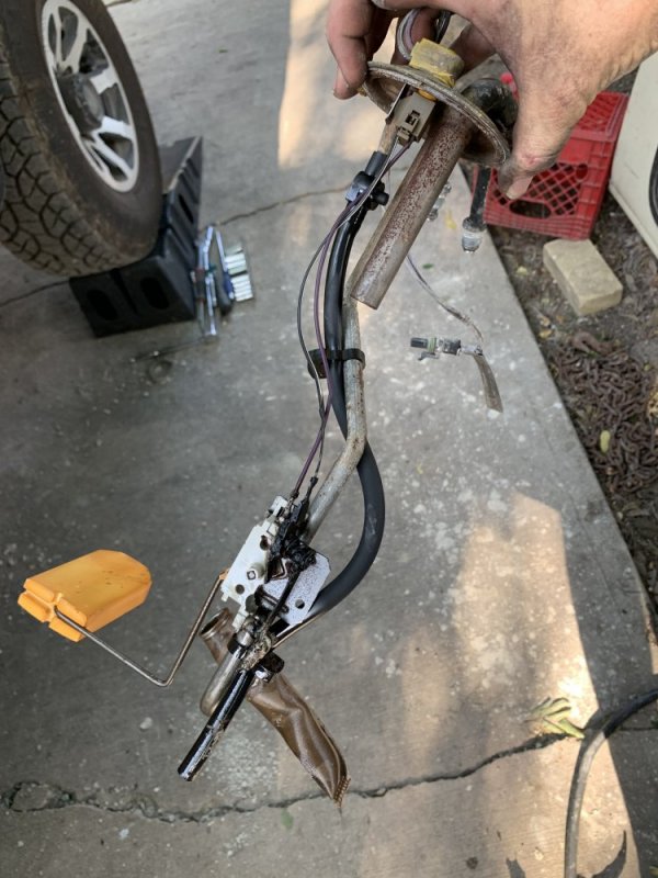

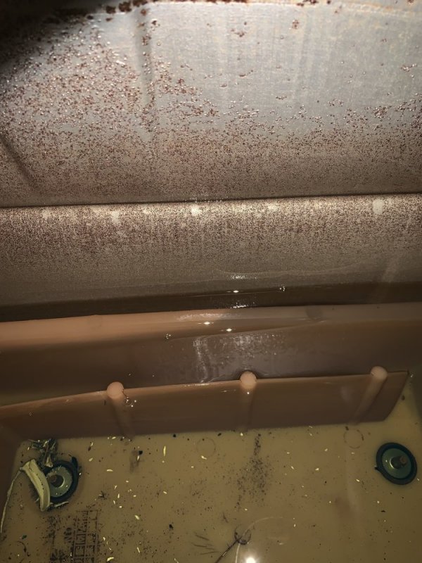

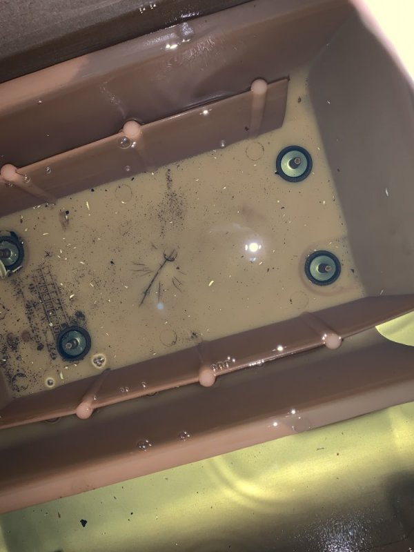

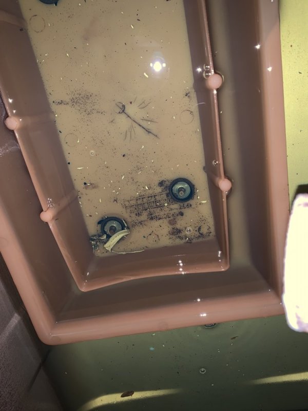

And the saga continues. just got the tank dropped and well... it doesn't look good. even the sending unit piece is melted. the top side of the tank was covered in what looks like powder from a fire extinguisher. the upper part of the inside of the tank has surface rust, but isn't as bad as some I've seen before. what on earth would cause the gauge part of the sending unit to melt as if it somehow shorted out!. I'm guessing at this point I need a new tank. this I think is a 24 gallon tank, if I do replace, will a larger tank bolt right up without any mods needed? and will the same sending unit work? here are some photos I was able to take with my phone of the inside of the tank and of the sending unit. I didn't see any problems with the pickup tube it self or the rubber lines that were connected to the pickup tube lines.

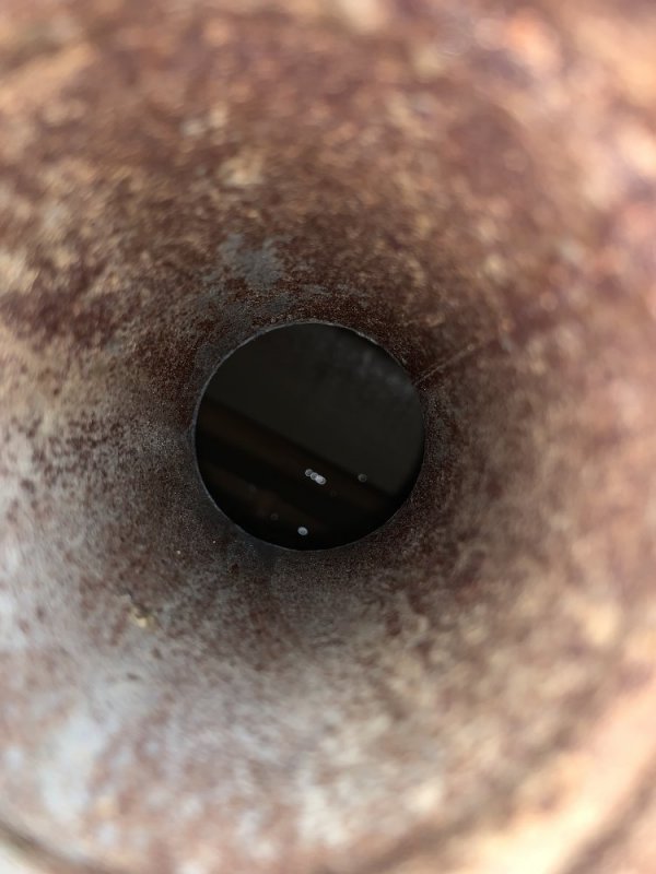

the really rusty photo is the filler tube in the tank. I will have to get my mirror to have a look at the top side, but feeling it with my fingers it didn't feel like the filler tube was.IMG_1814.jpgIMG_1815.jpgIMG_1816.jpgIMG_1817.jpgIMG_1818.jpgIMG_1819.jpg
I may be wrong on the size tank, looking on Advance Auto by application it shows two tanks. a 25 gallon that measures 14x48" and the 34 gallon that measures 14x62". I measured mine and it's 13 1/4" tall at the highest point (by the lockring) and 61" long from crimped edge to edge. it also looks to have about 1/4 tank of fuel in the tank and I was thinking it was about empty going off of my mileage reaching 300 miles per tank (gauge has never worked) looking at the pictures on their site, it looks the same as the 34 gallon.
yeah I'm pretty sure it's a 34 gallon tank. looking more into it the measurements and all plus the amount of fuel left in there.
I got my mechanics mirror and had a peak if the top side in the tank and it's not bad at all. there is a bit of surface rust that has formed but the worst area is the inside of the steel fill tube.
what should I do? run it or get a new tank? rockauto shows a Spectre 34 gallon tank for slightly over $100 and I can order one through Advance for $117. but again it's not GM branded. I really don't want to spend $400 + from the GM dealer for one! I did a google search on the Advance part number and it's a Dorman tank that they're offering a limited lifetime warranty which most likely doesn't cover rust lol.
aside from the question to reuse my tank or not, I was reading up on what might have caused the gauge sender to melt inside the tank. I remembered on the old school vehicles there was a power resistor mounted on the inside of the firewall that was for the dash gauges. on my truck I have had the instrument cluster apart to repair the tach and I also have another donor cluster from a gas truck I had used some parts from to repair mine. I noticed that each gauge has a resistor mounted on the power studs inside the cluster. I have not messed with the fuel gauge but I am wondering if something in the cluster may have caused the sender to burn. I took my multi-meter and checked the power output at the harness where the sender plugs in and I'm getting 8.74 volts and will also make my test light glow. my fuel gauge also always stays just below 1/2 tank reading. when I cross the two pins in the connector the gauge moves to the point where it can contact the gauge needle below it. when I go to install my new sending unit I really don't want to burn it up too. is there something I need to check at the cluster before hand?
I also want to add that when I repaired my cluster before, there were several noticeable giveaways that someone else has had it apart. the section where the SES light and STS light are, the plastic divider that directs the glow from the bulb was broken out with pliers along with other pry marks where someone tried to pry the cluster apart. I ended up using the light divider and other plastic pieces from the donor cluster to make mine whole again. should I start by swapping out the fuel gauge with the one in the gasser cluster or will it use a different resistance for the sender?
