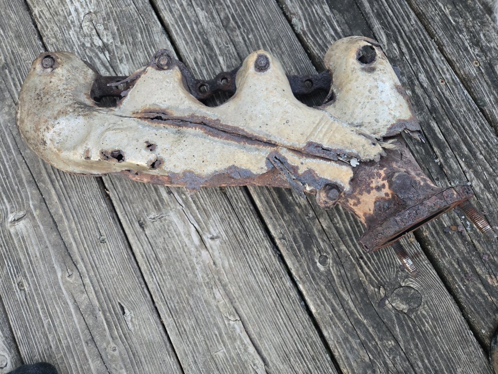

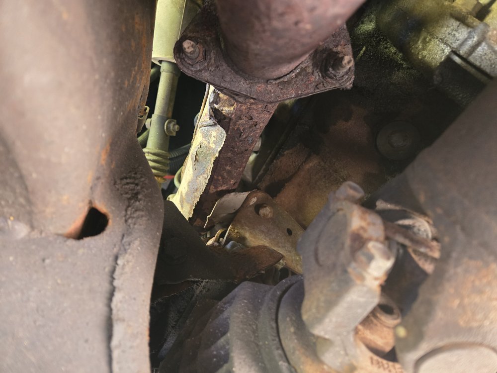

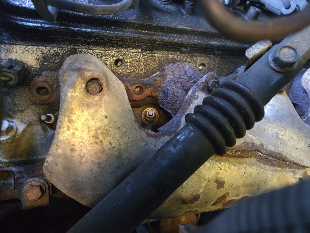

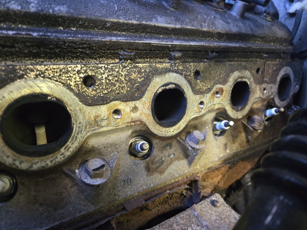

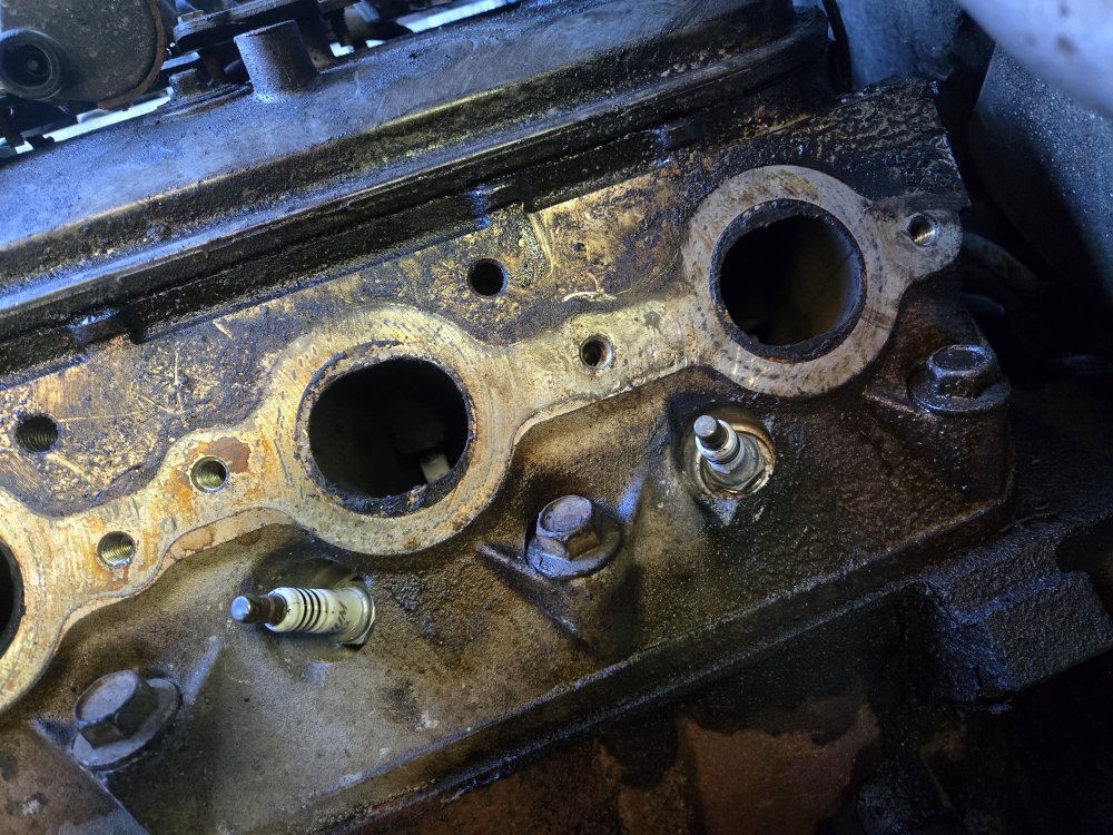

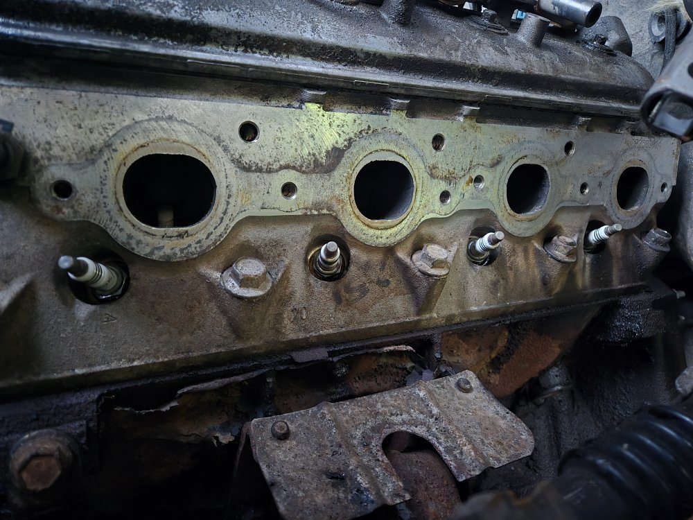

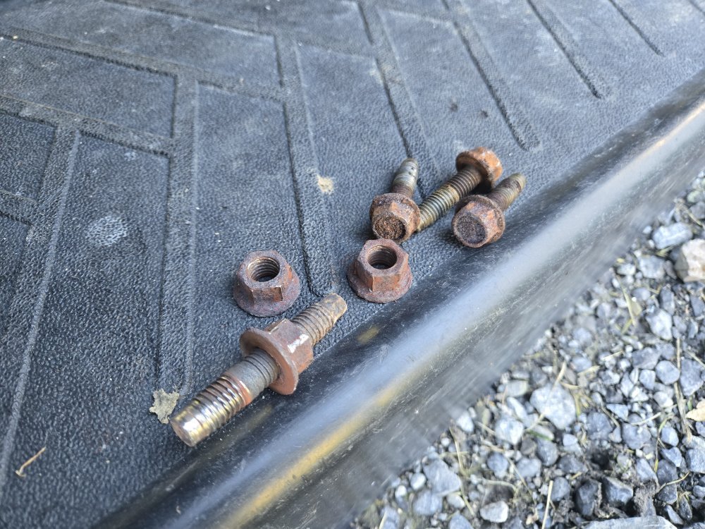

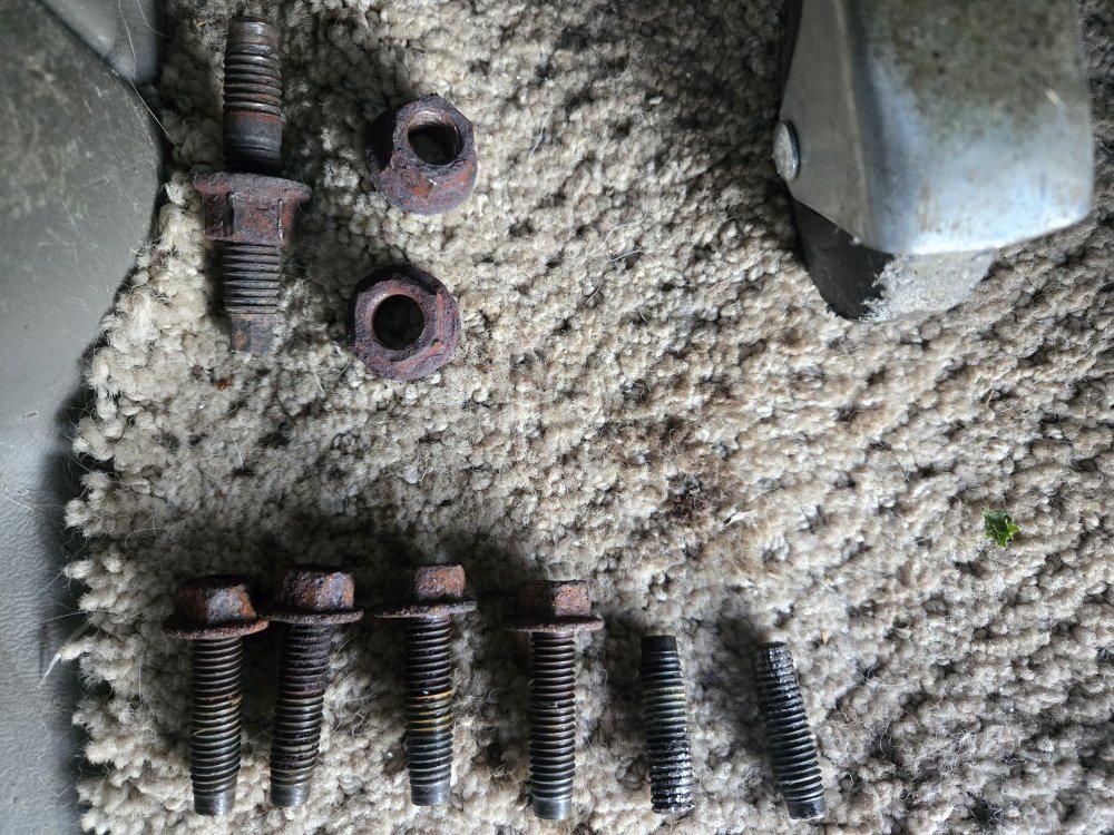

I have a cold tick on the drivers side, both rear port bolts have the heads snapped off. One has been gone since I bought it. Today we un-bolted the downpipe, and 6-remaining manifold bolts. I need to play the lotto, none of them broke.

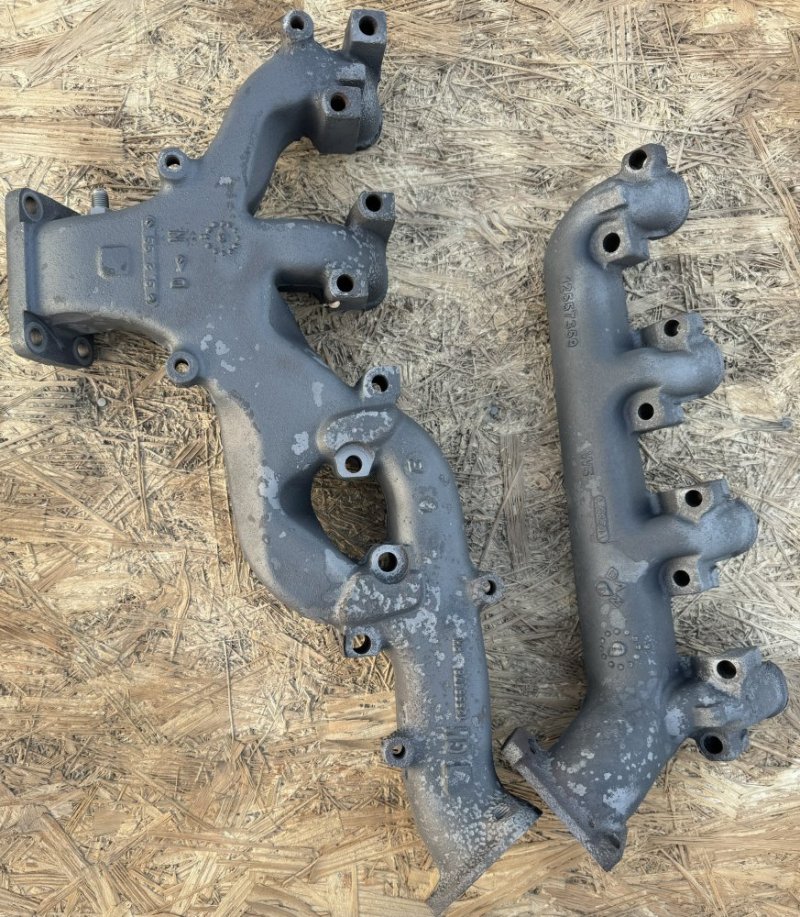

I plan to order a new exhaust manifold, what are the chances of reusing one? Ive never done this before. I will also order new MLS gaskets, bolts and studs.

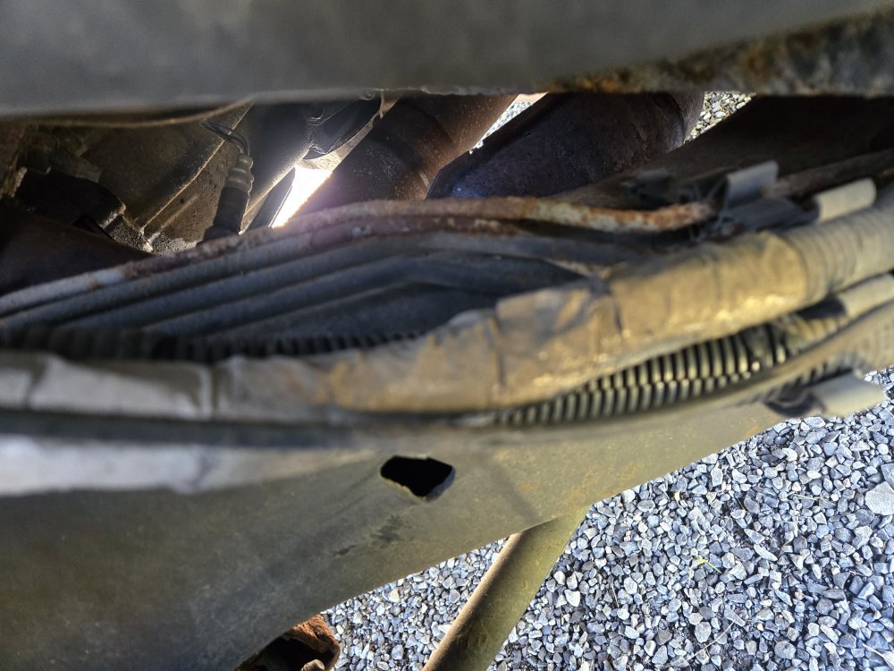

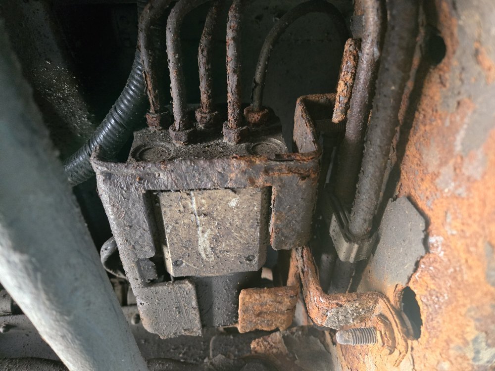

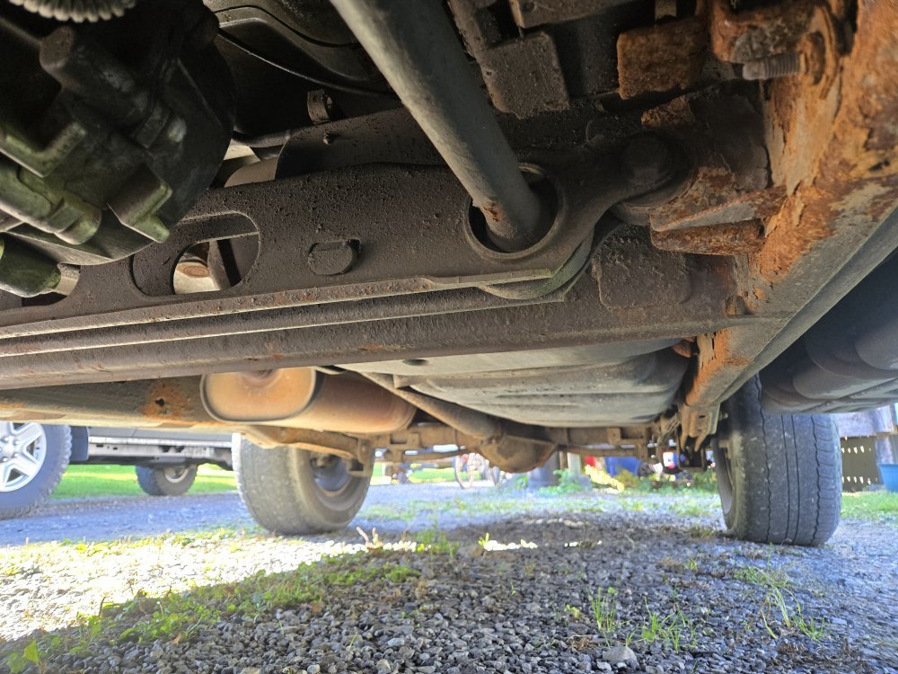

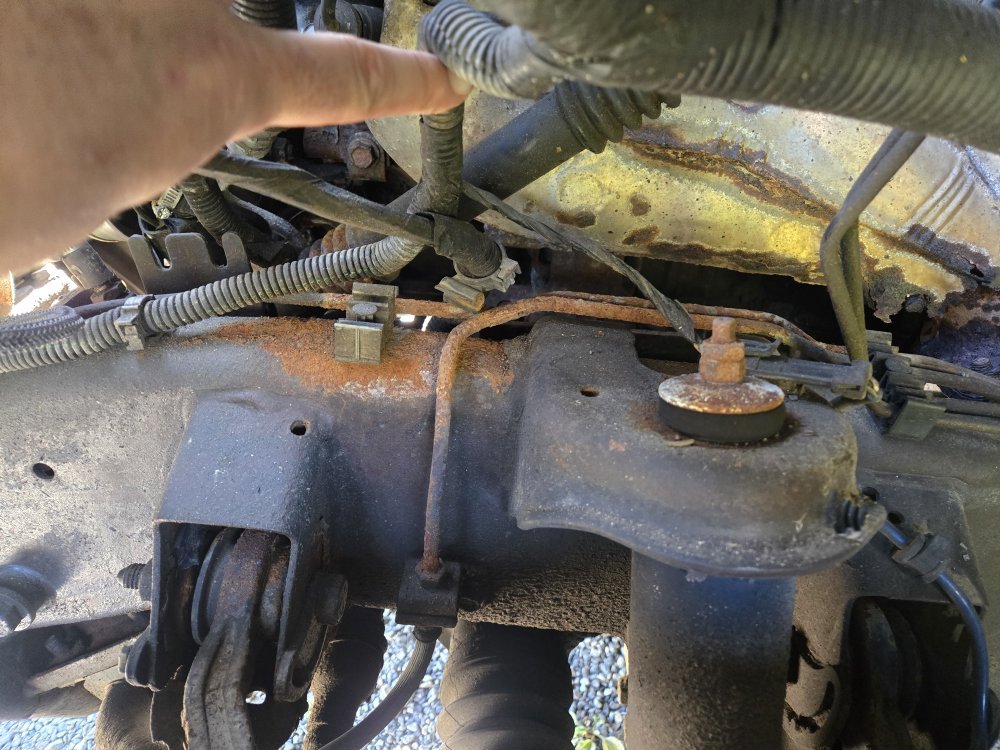

I also did some inspecting, I've got brake lines I am really not comfortable with. Where are you guys getting your present, coated lines?
reusing the manifold shouldn't be an issue. if the studs are broken at the doughnut, grind them flat with the manifold, center punch them and drill out starting out small and work up till you just see the threads. Then you should be able to use a tap and chase the threads out. go back with stainless hardware and use some high temp anti-seize. iirc the nickle anti-seize is good for up to 2200 deg.
on the brake lines, yeah those look a little on the crusty side! I would try your best to save on the line nuts, most likely they are metric thread. get you a roll of Ni-copper or whatever they call it now brake line that easily bends and wont rust and a flaring tool. on the line nuts, you might have to break off the lines so you can sue a 6 point socket and save them. if the steel line is rusted solid in them, use a drill bit the same size of the line to get them out so you can reuse them. drop all the line nuts in some acid or vinegar to desolve the rust. phosphoric acid will eat the rust in no time.
bleed the system as best you can with a helper, then you'll need to connect to the ECM to get air from the ABS pumps. That might mean a trip to the dealer or a shop that has the power bleeder equipment.
I have reused and resealed mine on 07 5.3 multiple times the bolts just don't seem to want to stay tight. I did have to replace the PS Mani original was cracked. I have a large belt from belt sander I lay on shop take and slide to manifold surface on to true it best I can seems to work fine.
We succeeded in removing the 2 broken studs. Vice grips and a quarter turn at a time. The manifold itself is solid, heavy rust scale. The heat shield is wasted......

The exhaust manifolds on my 6.5 cleaned up nicely.
Then took them to a big bead blast cabinet and knocked the rust off the flange that bolts to the exhaust ports.

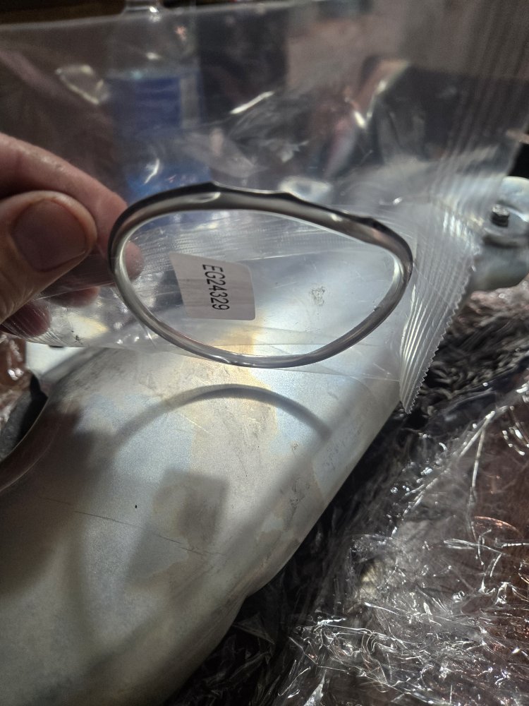

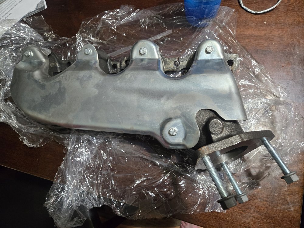

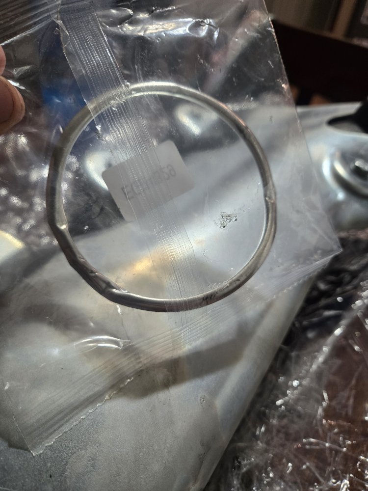

Manifold, gaskets, and O2 came. Love it when the manufacturer skimps out on packing materials to save $3.
The manifold went for a ride loosely creating swiss cheese holes in the box and roasted the downpipe crush ring gasket. Will have to find a new one locally, then fight with Dorman on a replacement that will most likely go in the basement and collect dust for years to come.
