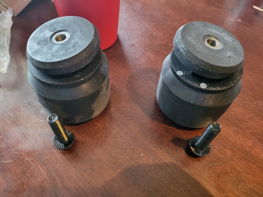

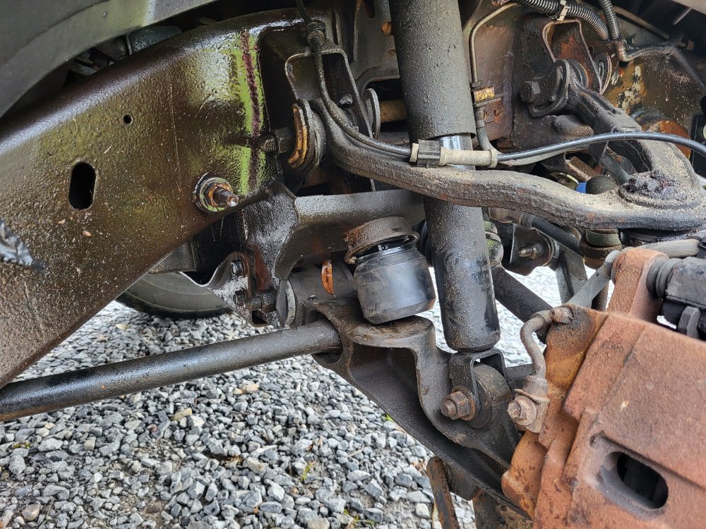

I found out today just how correct you are. I had these on my 94 K2500 and never even noticed them, but my t-bars were cranked as well.I used to sell & install Timbrens couple decades ago. There are times they are the perfect answer. Other times they ruin the ride. If they are only in contact when you add the temporary load, they will be ok. If they are in contact all the time you will not be happy

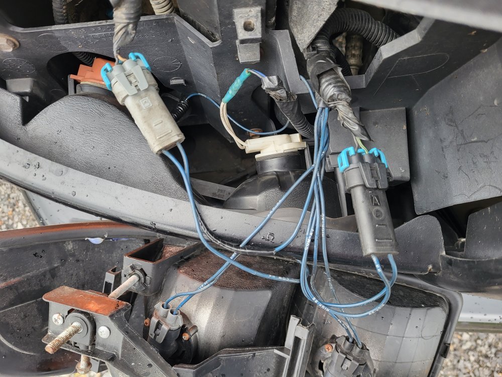

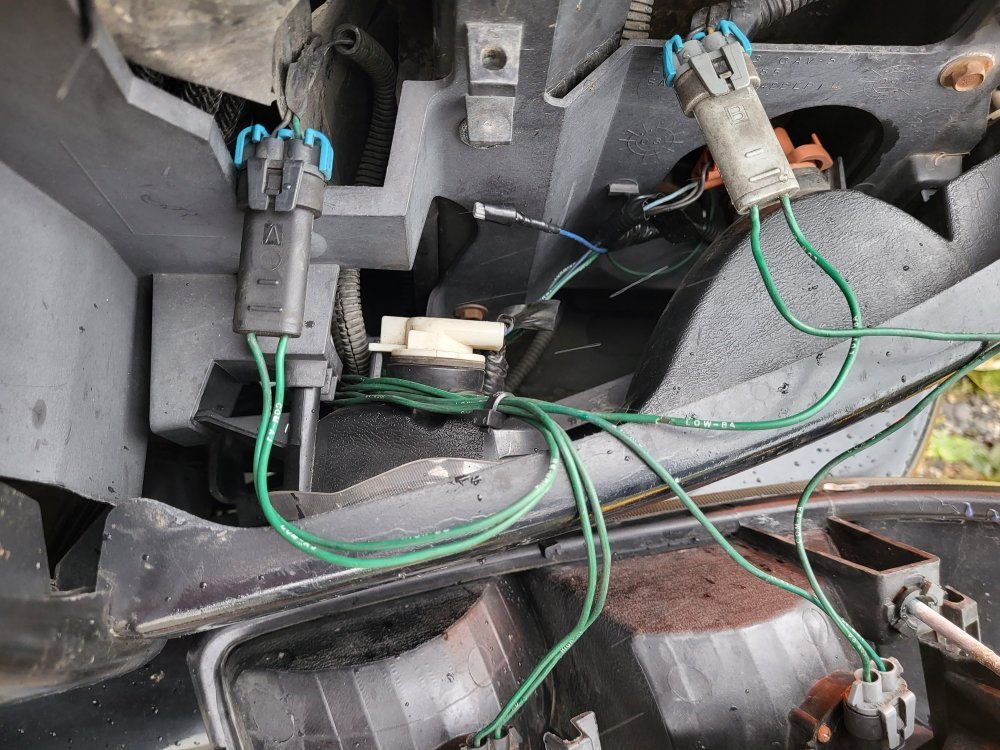

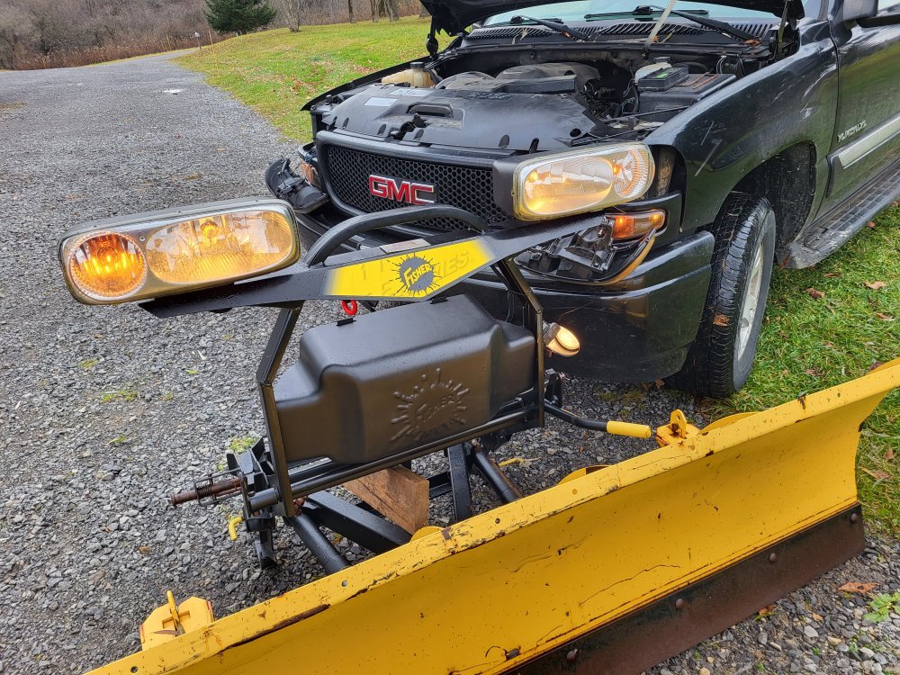

Still going! Only update is fixed the dim low beam issues. Helps to get the polarity right on the Fisher to truck harness! No real big snow events as of this season, just nuisance events for CNY. - Crosby Nash and Young ?
Agreed, I would not have done it this way. I did get another pigtail from a truck at the JY for just in case. If there are any visual issues found I will use some nice solder sticks to get the replacement back on.When I have broken weather pack terminal connectors, I use the appropriate tool, release the terminal from the busted weather pack, remove the pig tail from the good WP and shove the original terminal into the new weather pack.
I dont like clipping wires and splicing in pigtails.
I did find that the NAPA store and Oriellys here has many of those latching connectors in stock.Agreed, I would not have done it this way. I did get another pigtail from a truck at the JY for just in case. If there are any visual issues found I will use some nice solder sticks to get the replacement back on.
