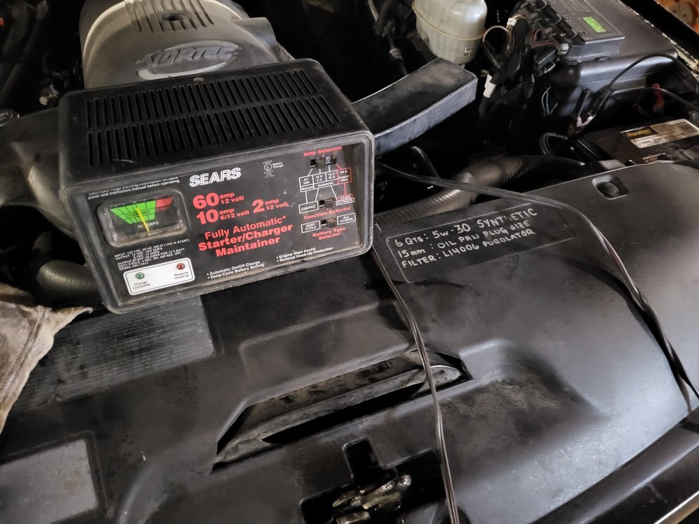

Having an issue with slow cranks. Voltage was 12.34 the other day, when the vehicle is running I am charging over 14-volts per dash gauge which I know isn't entirely accurate. The alternator is a Delco Remy 160-amp unit replaced about 2 years ago. When running I slapped my meter on it and am getting 13.7V so its definitely charging. Thinking I have a drain or the battery is taking a dump. Planning on pulling the battery and getting it load tested next.
