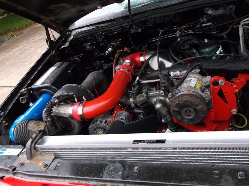

Ordered some boots and clamps from siliconeintakes.com again, gonna finally use my Peninsular upper intake.
Got the intake on. Wasnt sure what to do for IAT, MAP, and boost pickups, so I went right into the back of the manifold. Its pretty sloppy, but works. It will get redone in the near future. For some reason, I am now seeing 22psi on shifts, which I never saw before. If anything, I would think that increasing the size of the upper intake would reduce boost (on the idea that when volume increases, pressure decreases) anyway, it seems to go just as well as it did before.
I am typing this from Cape Cod, I drove up the Mass Pike, to 495 to Rt. 6 on Sunday, averaged about 68mph on 90 and 495, and about 55mph on 6. 156mi on 6.6gal of fuel, 23.6mpg!!!! I was happy as a clam to see that number.
Here's a pic of the intake. Don't laugh lol
Awesome mileage! If you felt like it you could pull the lower intake and drill and tap it for your sensors, but yeah the rest of the install sure looks nice, good job.
Cool. I didn't know those upper manifolds could be mounted that way. I thought they had to point to the left or right like in leroys pic.
Ordinarily, yes. However, they can be made to mount as I have it by using some sort of adapter. Leroy makes them in the form of an aluminum box. My friend's dad writes CNC-type files for a living, and was able to draw up a file for my adapter. It was then cut on a plasma table into a piece of 3/16" steel.
