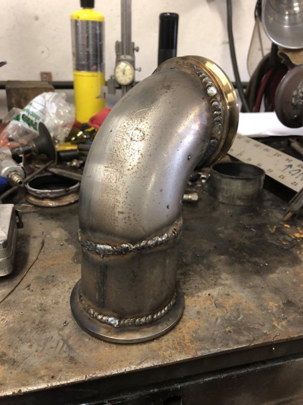

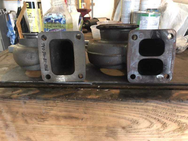

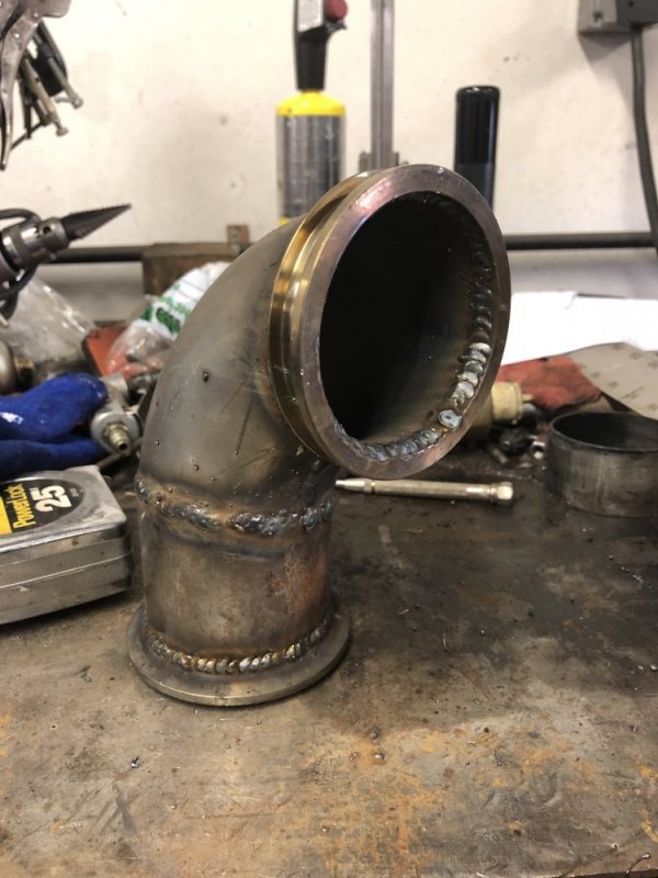

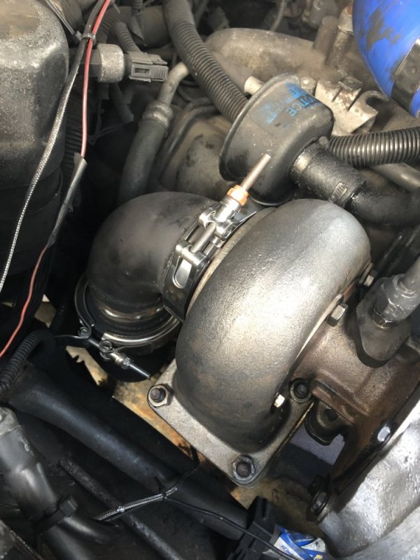

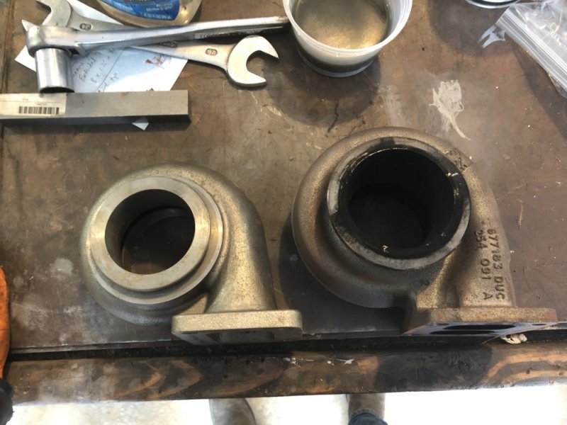

I got some good work done today. I installed my T4 0.81a/r open scroll turbo from Boost Lab and fabricated a new down pipe adapter elbow. I cut the divider out of the BD Diesel T3/T4 adapter as well. Turbo side flange and clamp from SDP and down pipe side flange and clamp from Quadstar. All in all about a 3hr job, not bad at all.
The goal was quicker spool, but without overboosting on the top end. Mission accomplished. I get about 5psi at 2000rpm versus 3psi from the .91 divided housing. Even though the new housing is smaller, the open scroll seems to make up for the difference in size. Peak boost is 23psi. 20 is pretty easy, 23 you gotta push it. I was able to crack 1000* when lugging it on a hill in OD - 1900rpm/68mph/9psi. Other than that, it operates between 600 and 900* mostly. 5-15psi happens in the blink of an eye. I ran out of time to drill the manifold for drive pressure, probably try and tackle that next week. All in all very happy.

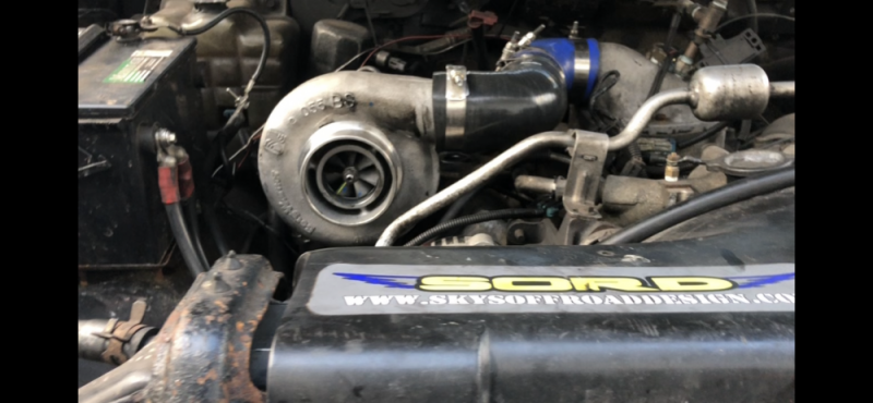

Update on the new housing. I love it! Boost comes on more quickly as hoped, and there is a slight increase in boost on the top end as well. I get about 3-4psi at 2000rpm in normal driving, and 23-24psi on the top end vs 20-21 psi with the bigger housing. I reset the max temp. reading on my EGT gauge, and in the 2 weeks since the swap, the max temp I have seen is ~1025. I have only been able to crack 1000 by lugging it on the highway and not giving the truck enough pedal to downshift. Cruising at 75mph and roughly 2200rpm I get 5-6psi and about 700. So all in all, it runs great! I've put probably 800 miles on it since the swap and I'm very happy.
