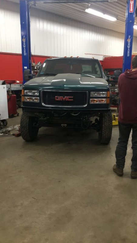

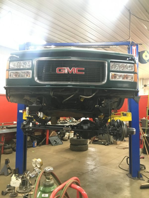

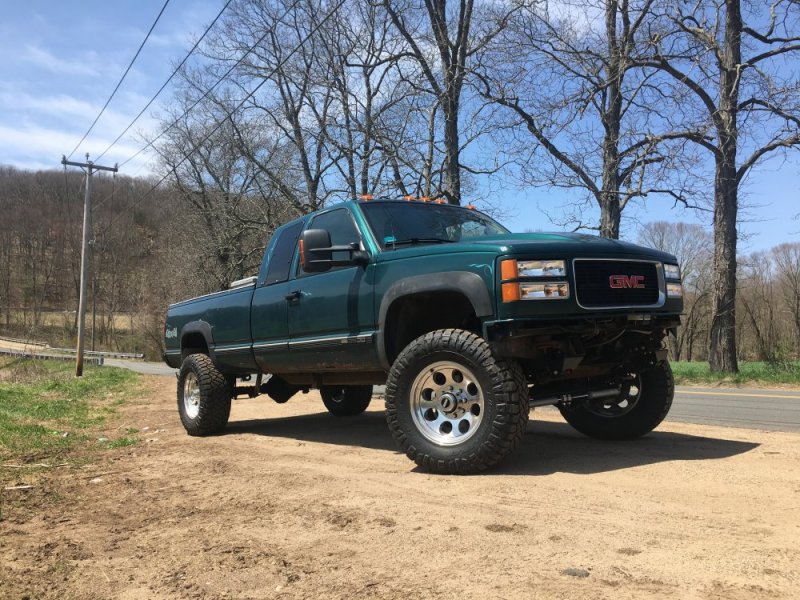

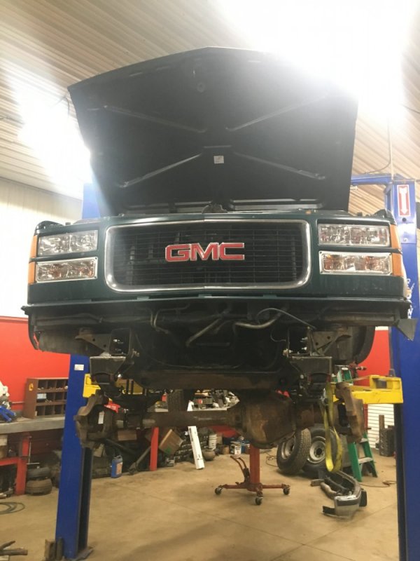

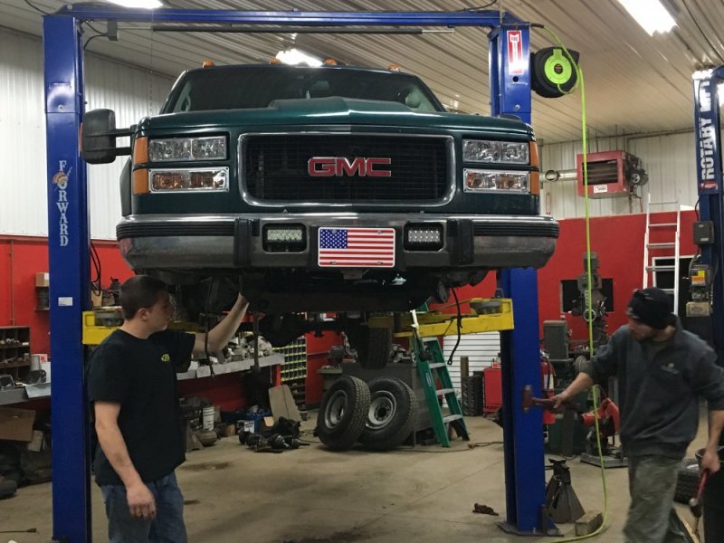

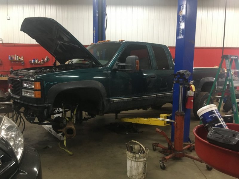

The solid axle swap went fairly easily. It took about 3 weeks of hit-and-miss productivity to get it done. I spent a little more time waiting for parts than I would have liked, but that's how these things go. I'd like to start by publicly thanking Brent (owner) of Valley Truck and Off-Road in Ellington, CT. I dealt almost exclusively with Brent on the whole SAS project, including the purchase of the axle, (almost) all parts, the wheels and tires, etc. as well as being fortunate enough to use shop space to do the conversion. Initially I was looking for a 90's OBS Ford axle with ball joints. This was the plan due to the sky-high value of king pin axles and the relative surplus of ball joint axles near me. However, I struck gold when Brent had an '86 F350 dually axle in stock, 4.10 gears. So we tore that axle down and sent it over to Pete Hany at CT Axle & Spindle (also in Ellington, CT) for a rebuild and re-gear. With the Duramax on the long-term schedule, I wanted to keep the truck 3.73. With the 0.72 6th gear in the ZF, the 3.73's, and 35's I will have a nice cruising speed; somewhere in the area of 1800rpm/75mph in 6th. If there is a scenario where the truck is towing heavy, I can drop into 5th and be 2200rpm/65mph or thereabouts. I knew that the 6.5 was not going to enjoy the big rubber and tall gears, but I figured it couldn't be that bad.
While Pete was working on the axle, we set to work getting the ORD kit in. If there are any ORD guys on here: your kit is excellent! We had barely any issues fitting up the brackets. I will say that if you want to SAS without going too high, the ORD kit is the way to go. I went with 2.5" Sky Jacker lift springs for a square body, with an add-a-leaf as well. The springs sit about dead level. My option was to use the Sky Off-Road kit which nets 5" of lift in the brackets alone. In order to achieve the height I wanted, I would have needed to run stock springs with a wicked negative arch. I know form follows function, but negative spring arch isn't for me. As you'll see in the pictures, the 3" lift from the ORD kit with the 2.5" lift springs got me to a good height. The truck fits the 35's quite well, and is still a manageable height for doing "truck stuff". By the way, there is a 5.5" block in the rear, traction bars to come.
While the grille was off, I had to look at an eyesore I wouldn't see normally: a crusty power steering cooler. I had already planned on a new steering box at this point; I felt like my stock 223k mile unit deserved a retirement and I didn't want to subject it to 12.50" wide rubber. So we decided to enact the dangerous phrase "since we're in here we may as well..." and we rebuilt the entire power steering system. I decided to go with Red Head steering gear, to the tune of about $350. I know there are mixed reviews on Red Head, but let's face it - there are mixed reviews on everything that has ever existed. Brent is a dealer for Red Head and I can go to him with any issues I may have. So we did the Red Head box, new stock P/S cooler, new cooler hoses with push-lok fittings, new power steering pump, and new lines/hoses going to and from the box and pump. The truck handles the 35's with little difficulty.

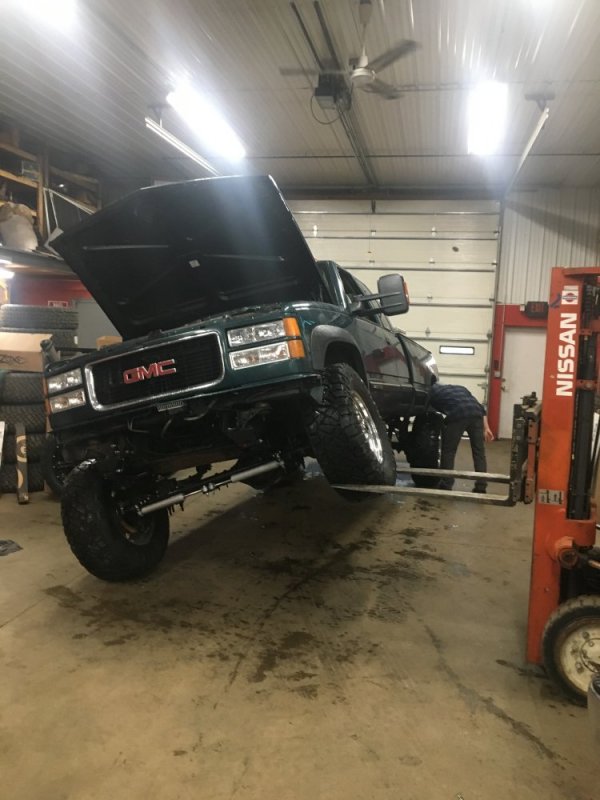

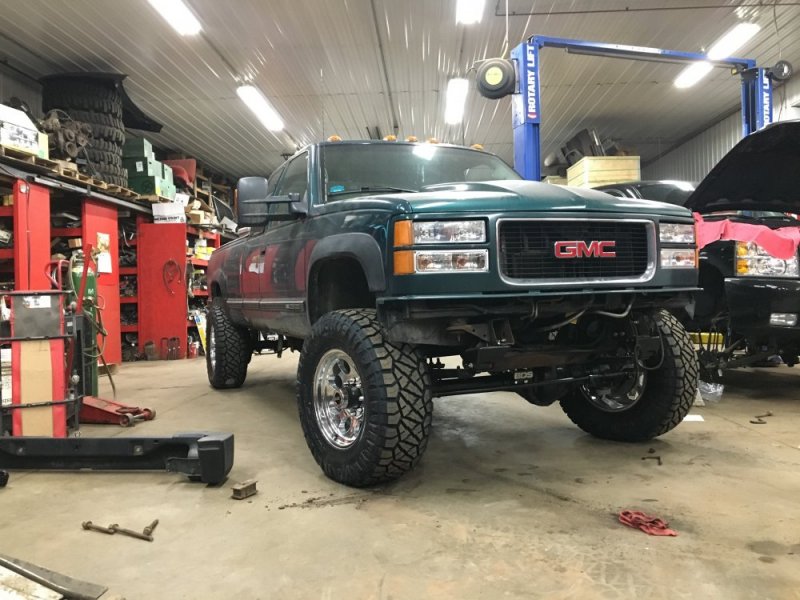

Once I got the axle back from Pete, we hung the springs, bolted in the axle, and installed new Warn locking hubs. From there, it was mostly basic reassembly. Needless to say, I was quite happy to see the truck come off the lift and hold its own weight. We went with crossover steering, using a custom upper king pin cap that Brent had in stock. All Moog joints, and a custom drag link made from DOM by a local machinist.

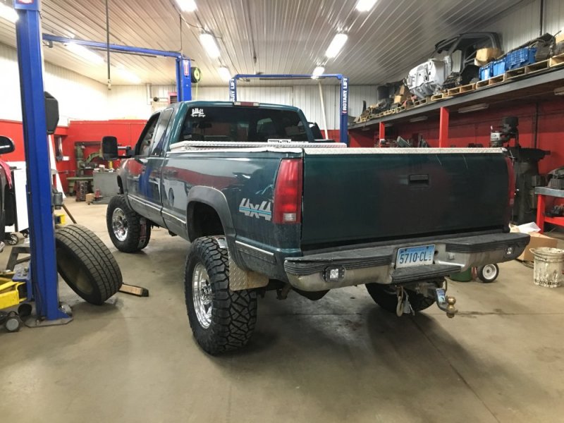

I was very happy to drive the truck and get used to the new height and road behavior. So happy in fact that I drove the truck for about a month with no shocks. All spring, all the time haha. It actually rode pretty well, though it was definitely bouncy. On good pavement it rode as well as it did when it was stock IFS with the keys cranked. I drove the truck quite a bit like this, until one when I looked at the truck and noticed that the bed seemed to be crooked. A quick inspection revealed a broken passenger side rear spring hanger. Great. Let's rebuild the rear suspension, why not?

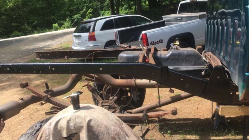

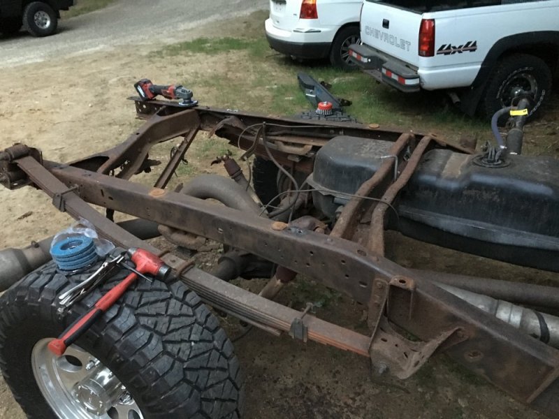

With the help of some good friends, I pulled the bed and set about grinding the frame for new mounts and paint. For anyone that has done this, you understand how miserable a job it is. For anyone that hasn't: be glad. This part of the build isn't that exciting or interesting, so I will be brief. All new spring hangers, all new shock mounts, Chassis Saver paint on the frame. Made new cross members, put the bed back on, and shipped it. While the bed was off, I decided I'd replace my rotted-through passenger cab corner. Why not, right? So over the course of 2 weeks, working only a couple hours at a time, I got it done. I'm pretty pleased with myself on it actually, as I had never done body work before. So cab corner, new rear suspension (stock, original springs reused) painted rear frame and under cab. Done. 3 months gone. Didn't get to drive the truck at all from late May to mid August.
So at this point, we have a lifted truck, new cab corner, rear shocks (no fronts) and everything is right in the world. I drove the doors off the thing at that point, and was really enjoying the truck.

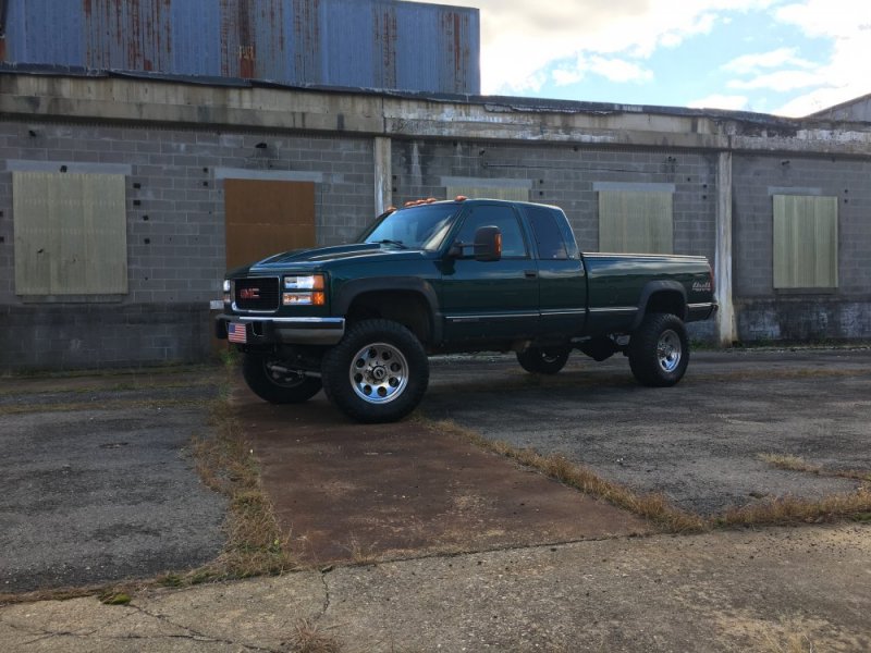

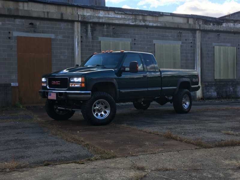

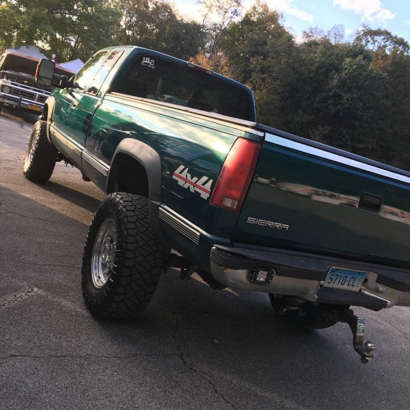

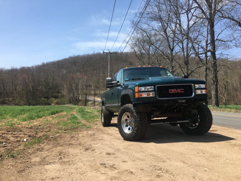

Before starting this section of the update, I'd like to mention that the wheels and tires are Nitto Ridge Grapplers in a 35x12.50-18 around Pro Comp 1069 alloy 18x9 wheels. Okay, continue.
The next couple things that happened with the truck were aesthetic and cosmetic. My current plan (as it has been for about 3 years now) is to transform the truck from a "kid" truck into an "adult" truck. Basically, a clean and simple truck on the exterior with tasteful modifications.

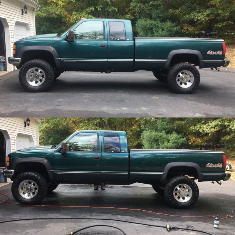

Next up was something that I had thought of doing but never gotten around to: a good cut and buff. Let's just take a moment to say thank you to GM for using some darn good paint in the 90's. With the help of my father (who is very experienced in the field of auto detailing) we washed, claybarred, buffed, and waxed the truck. I will let the pictures speak for themselves.

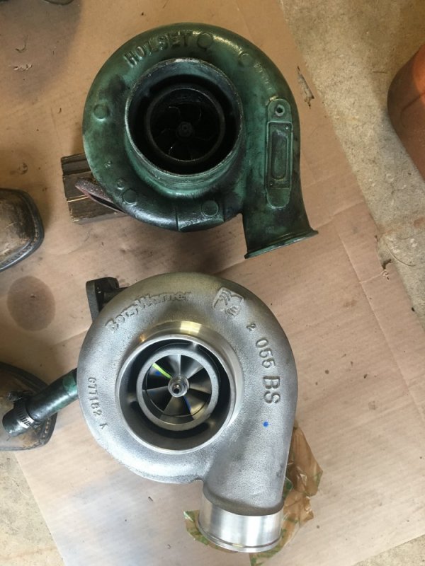

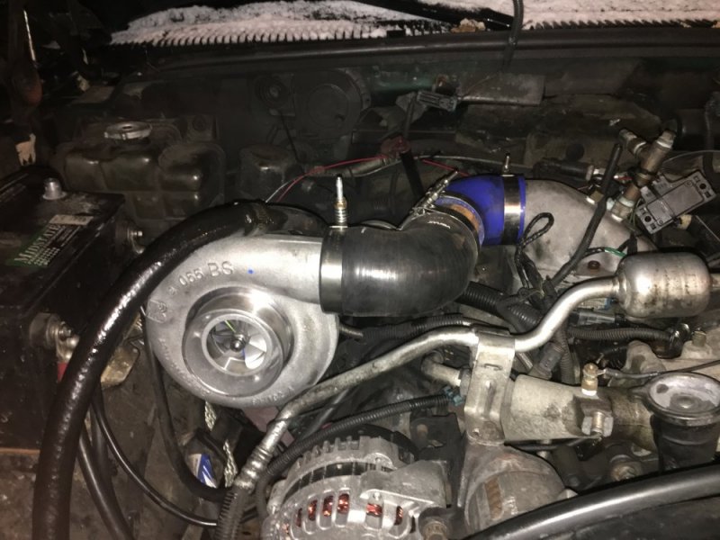

So, with the PA trip 3 weeks away and not wanting to have the truck down for too long, I began evaluating my turbo options. My thoughts as follows:
-S300 box turbo: only available T4, will need additional work to fit, not a lot of data on a 6.5, but $699 new and a proven turbo
-Quadstar Super 54: designed to fit, I know it will work and run well, basically drop-in, but $1200+
-eBay: cheap, but hit or miss quality
-rebuild my HX40: not a project I wanted to take on
-used Holset

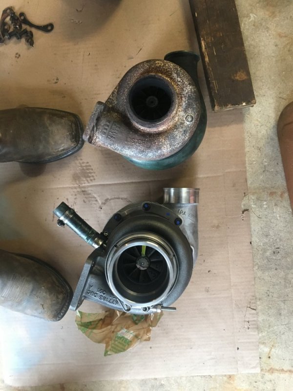

Initially, I went looking for a used Holset. I figured it would drop in to my current setup, and save me a couple bucks over going with a new turbo, and I could sleep at night knowing I still had a name brand turbo as opposed to a chinese unit. So I found a tight H1C locally for $100 that I picked up. 300,000 miles off an 89 Dodge but no shaft play and spun nice and smooth. Long story short, the CHRA didn't want to come apart, and I cracked the compressor bearing housing. My fault, but frustrating nonetheless. So I was out $100, and back to the drawing board.
I wound up going with the S300. Ideally, my truck is studded and I go with a Quadstar 60, but I wasn't able to spend the money, and my truck isn't studded so I didn't go that route.
Details on the S300: 60/68/0.91 T4 divided, non-gated. It runs pretty well all things considered. Being the that the truck is an auto, I can kind of get away with a bigger turbo than if it were a stick. However, the 3.73's and 35's do not work in my favor. Going from a 60mm hot side to a 68mm and from the 16mm housing to the 0.91 which visually appears to be bigger meant that it was going to be laggier. And it was. Basically, the turbo spools well if you kick the truck in the nads a little, but if you roll into it on a hill and it doesn't downshift, I see about 10psi and 1000* and climbing. Hottest I've had it is 1200, that was on the highway pulling a hill at about 7200/2000rpm. The key to keeping the turbo happy is rpm. Over 2200 and its a happy camper. My setup, unsurprisingly, does not yield good lugging. No big deal, just give it more skinny pedal and get more smiles per gallon.
I've put probably 2500 miles on the S300 so far and its a decent option. I haven't run a Quadstar turbo, but I would imagine the S300 is inferior as it has not been optimized to work on a 6.5 platform. Based on the turbos I have run, I would rank them best to worst: 60/60/16 Holset, S300, HX35, ATT.

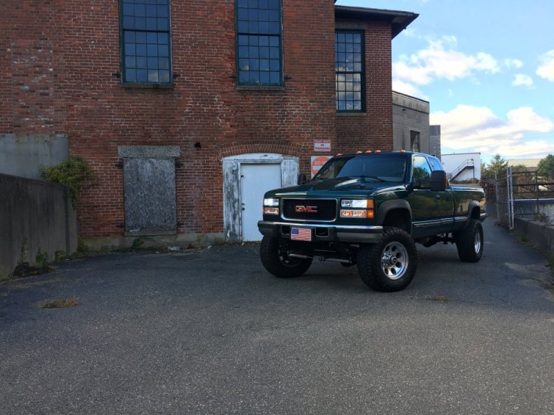

To return to the timeline briefly, the truck made it to PA and back without a hiccup. I got it on the graffiti highway in Centralia - which is really cool if you've never been. Averaged about 14mpg on the trip, some backroads driving and probably 3/4 highway going 75-80. Par for the course as far as I am concerned.

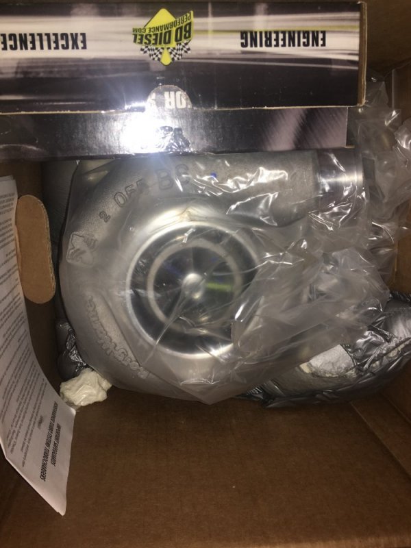

Okay, back to the turbo. In an effort to see what I can do with this thing to make it better for a 6.5, I have ordered and now received a new exhaust housing for it. I went with an 0.81 T4 open scroll non gated housing from Boost Lab. I opted to stay T4 because of the increased flow over a T3, but the tighter 0.81 A/R for hopefully a quicker spool up. Again, I know that cm2 and A/R are apples and oranges, but for what its worth, the 0.81 its externally smaller than the 16cm2 housing that came off the HX40.
Short term plans include installing a drive pressure gauge through the EAS system on the Edge monitor, and swapping the new exhaust housing on.

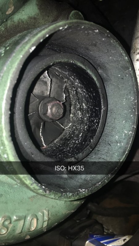

Some nice movement there.
Turbo fail sux. Did I miss, what was the cause?
Not sure. I’d be willing to bet launching in 4wd for the first time didn’t help it. It also has about 100k on it with unknown origin parts. It was originally bought off eBay as a new/reman HX40/H1C hybrid. A friend of mine had it on a 93 12 valve and put probably 60k on it. Hard miles too. The thing was getting tired id imagine.
