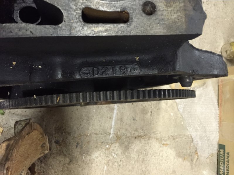

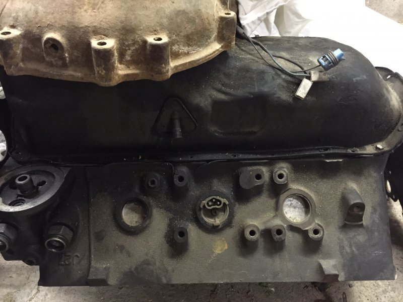

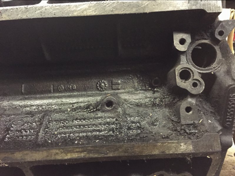

Cool thanks. I had to go look in my shop...
Incase these valley pics help anyone else. Out of a 99 gmc savanna van. I used the manifolds,turbo,injectors, camshaft from this. Definitely not optimizer parts anywhere on it.

Will, what about the mains on that block any shots, is the block damaged or? There are stories that the center mount turbo blocks do suffer from some cooling issues but I have no idea about the actual facts on that.
