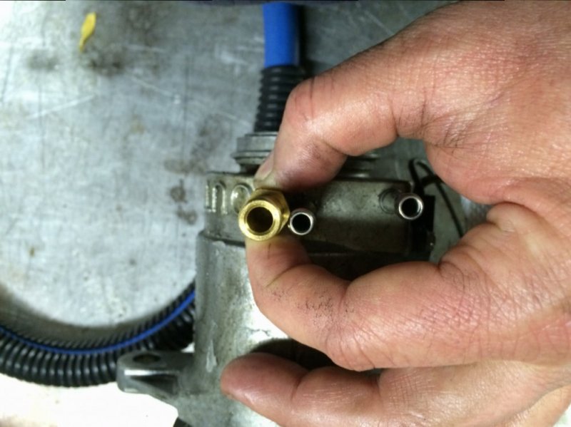

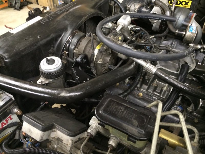

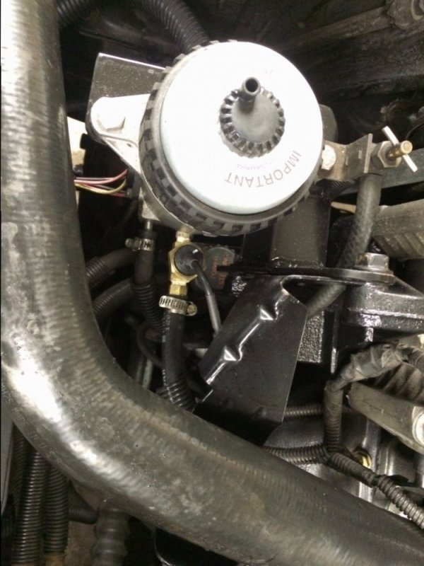

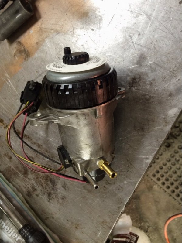

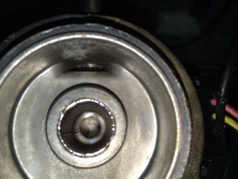

This isn't exactly what you asked, but here is what I did in case it helps. I did the Feed the Beast mod to the FFM (including slightly porting the inlet) so it now uses 3/8" hose. I then remote mounted it so it was easier to access for filter replacement and to inspect for leaks. I also have a spin-on filter between the tank and the lift pump. I have no fuel starvation issues.
