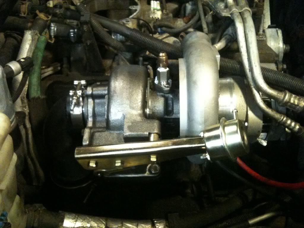

Once you cut the flange off the turbo outlet it is 2.25 and the 6.5 manifold is 2.5, you can see the size difference in this pic
yes i can see that now. Bummer i need to order a new reducer. So im gonna need a 2.25" to 2.5" reducer?
I made the mistake of ordering a 3" to 2.5" reducer

IT'S ALIVE!!!... as of 2:00AM last night, but I was too lazy to post at that point.
The sound of the turbo spool is ridiculous! I think it will suck in flying birds a quarter mile up in the sky. Granted this is with no air filter yet and just a quick unloaded goosing.

Awesome pics! Nice job and good call on smoothing out those burs! I should have my turbo tomorrow or tuesday! but i must wait for the rest of the stuff to arrive.
The downpipe is from RaceDayMechanic. Highly recommended, one of the few things I could actually bolt on straight away without any modification :)
Thanks! The boost nipple wasn't that bad. The wastegate machining was horrible! They left a lot of junk metal on that area. Granted a little cleaning and it was in good shape... Just be careful of debris and make sure it is super clean before installation. Other than that the Turbo unit is pretty nice, not sure why QC could not be a little better on those two issues as to blemish the "out of the box" quality on an otherwise nice turbo.
