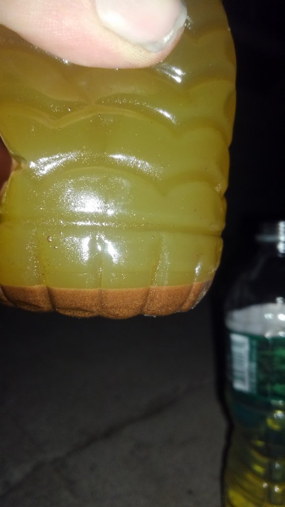

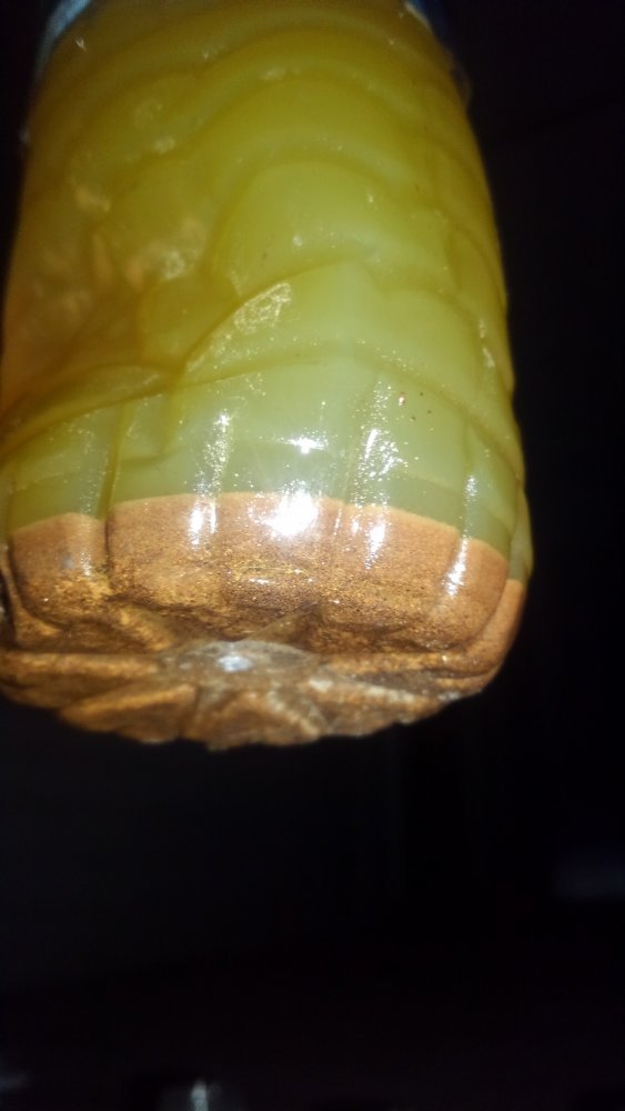

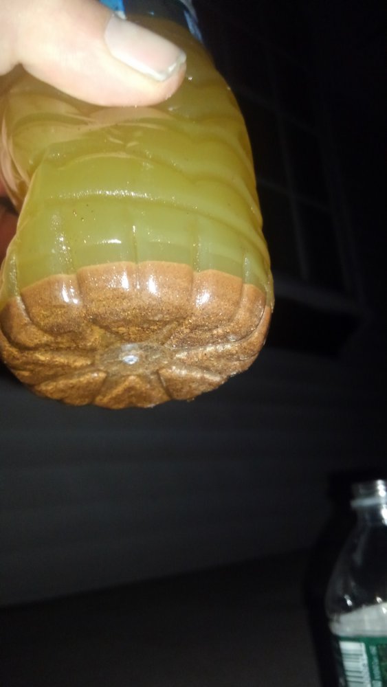

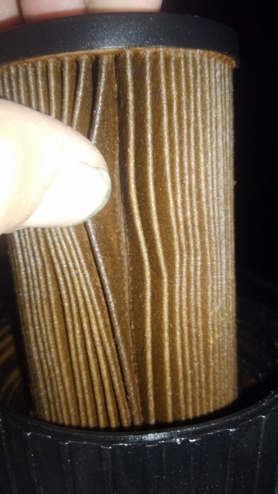

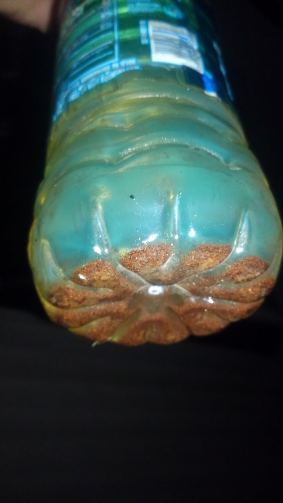

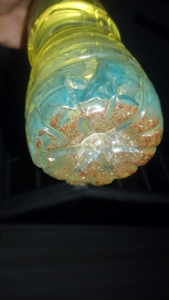

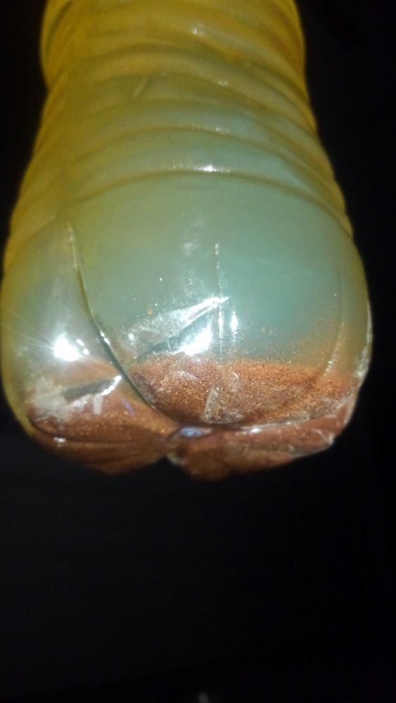

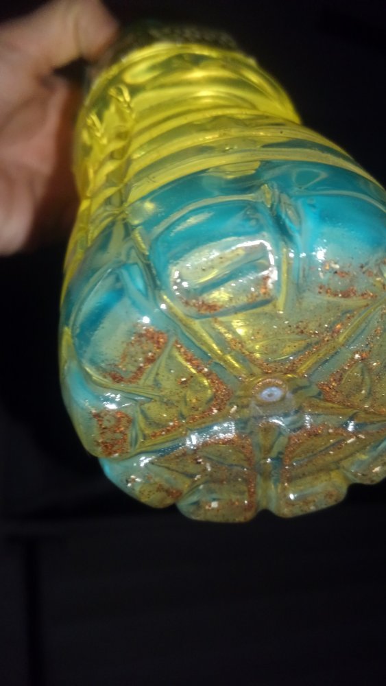

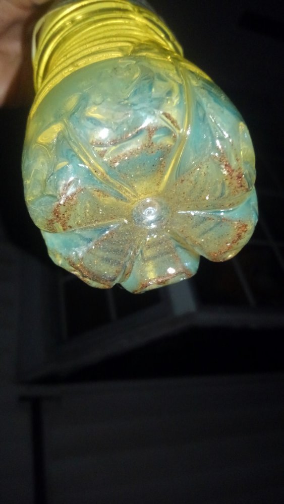

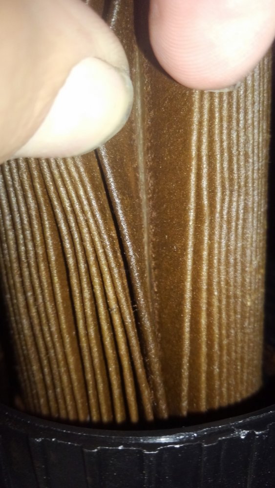

So I dumped the little bit of fuel out of the tank today I was supposed to have a boat tank delivered by 2 so figured I'd get the big tank out.. drained it fuel was really welrd cloudy but not like slimy cloudy.. just looks dark.. this may sound like dumb question but are the diesel bugs brown? I then was told the boat tank would be coming till Monday so had to put the tank back in the truck.. I put fresh fuel in it. No tranny fluid or anything.. just some of that diesel tank kleen ... Which is clear so won't effect color.. I siphoned out the filter housing multiple times. Kept refilling it with fresh diesel then resiphoning it.. every time I dumped fuel it ,it stirred up crap off the bottom..so I kept getting more and more crap out.. mostly brown crud ( possibly rust) and little silver flakes, which is problem from the original tanks liner that disintegrated.. filter was dirty and a little gritty, but not slimy or anything. Obviously I put a fresh filter in it..

Those are each 16oz water bottles.. I siphoned fuel out of the filter housing and put it in a bottle.. filled the housing with more fresh fuel and repeated multiple times that's why so many bottles.. you can see the worst ones were the first I siphoned.. but the pics are not in order . Got less crud each time.

@DieselAmateur . Where I'm kinda confused right now with the guys is how do I clean the injection pump and ffm? After getting all that crap out of the ffm today it makes me wonder if any of that got past the filters and to the pump... That's A LOT OF CRUD. especially since I'm not sure if it's rust or bugs or what . I'm putting in all new fuel lines (rubber) from ffm to the tank once I get the boat tank. To eliminate any possiblity of rust in the future .. I thought about new metal lines but can't find them local and probably extremely expensive anyhow.. I figure rubber can be changed easy and if contaminated in future can just roll it up and put it in a bucket of gas overnight..

That looks like sand and a little rust particles. are you able to pull the FFM off the engine to wash it out with some gas or carb cleaner? I know you will probably have to pull the intake to do it. if not you can rig up a 5 gallon bucket and attach a house hold vacuum to it's lid. then put a 3/8" fuel line or clear flexible tube through the lid to the lower part of the bucket so that when you run the vacuum cleaner it draws only air and not fuel. use the small tubing to suck all the stuff from the inside of the FFM. DO NOT use any carb cleaner or gas with this vacuum setup as the fumes can get into the motor area and go boom!!
all you can safely do to clean the IP out is after the FFM is clean, install a new filter and have fresh clean diesel flowing out of the filter housing. disconnect the return line from the IP and attach a long hose and drop it into a bucket. turn on the LP and let it run a bit till the fuel coming from the IP return line is clear. afterwards you can start it up and again let it run till the fuel coming from the IP into the bucket is clear. when you start it up, keep an eye on the return line you disconnected from the IP on the engine because there will be some fuel, not a lot, but some will push out of there from the injectors.
after everything is nice and clear, reconnect the truck's return line to the IP and you should now have a fresh clean supply of diesel to the IP and back to the tank.
@Will L. @WarWagon correct me if I missed something here.
