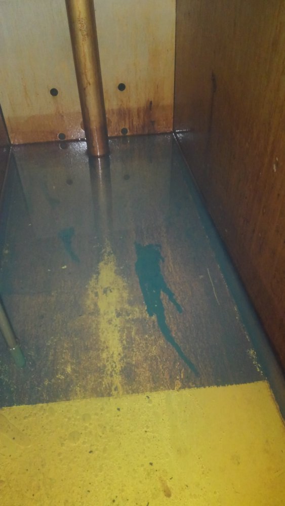

Very clean. Operating room clean. Probably better than that. The hospitals I've seen weren't as clean as you would think/hope they would be.If you unscrew the inlet fuel fitting from the IP the screen is part of that assembly. Just make sure the area around the fitting is clean so you don't get dirt and crud into the IP
Have you checked that filter lately?@dbrannon79 I'm going to try what you said with vacuum.. I agree the stuff in bottles looks like sand.. but that makes no sense..I can't believe that stuff got past the inline filter..![]()
@jrsavoie ...not since I put it in about 5-6 months ago.. I'll buy one and another regular filter before I hook up the boat tank. And put in the new fuel lines.. regardless of what it is, it shouldn't be in there so gonna go ahead and swap everything..

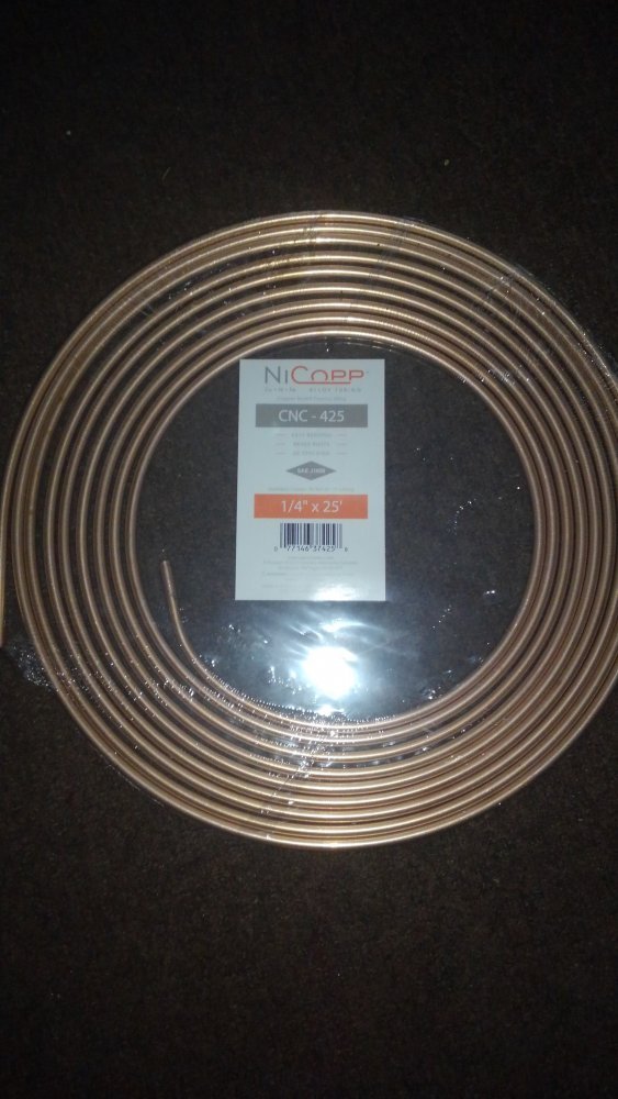

In other news I've been able to pick up alot more tree work with buddy, may actually become a full time job. But guaranteed alot more than it has been.. so I'm going to have more cash to work with then I have been having.. so tomorrow I'm going to splurge and buy new brake lines for back of truck.. already got the little hose.. and boss is going to pay to get the brake system power bleed and abs triggered to make sure there's no air in abs box.. he actually said something about that once he had his master cylinder changed and they didn't adjust the brake pedal (I believe) and it caused occasional brake drag because it wouldn't release far enough to vent or something of that nature.. does that make sense to any of y'all?? I didn't know you were supposed to adjust anything on the brake pedal.. of course it may not apply to our trucks also
