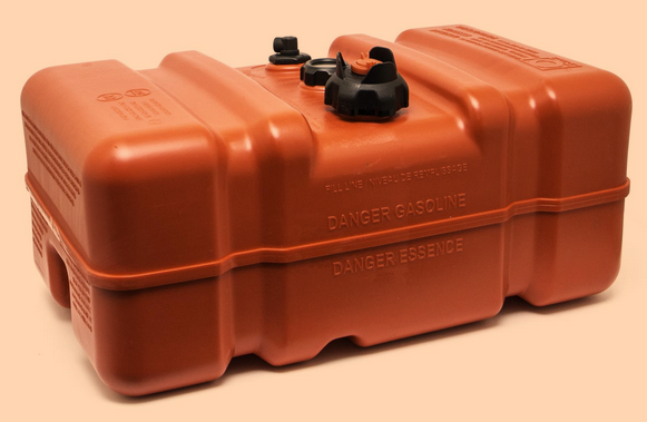

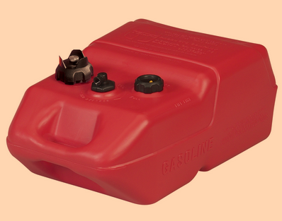

even if he could get his hand on one of those boat fuel tanks that are portable. lay it next to his aux tank, strap it down and run the hoses to it. that would work too. iirc they normally hold around 10 gallons.
this would give him a chance to still keep the truck running and be able to clean out the big tank on his truck properly.

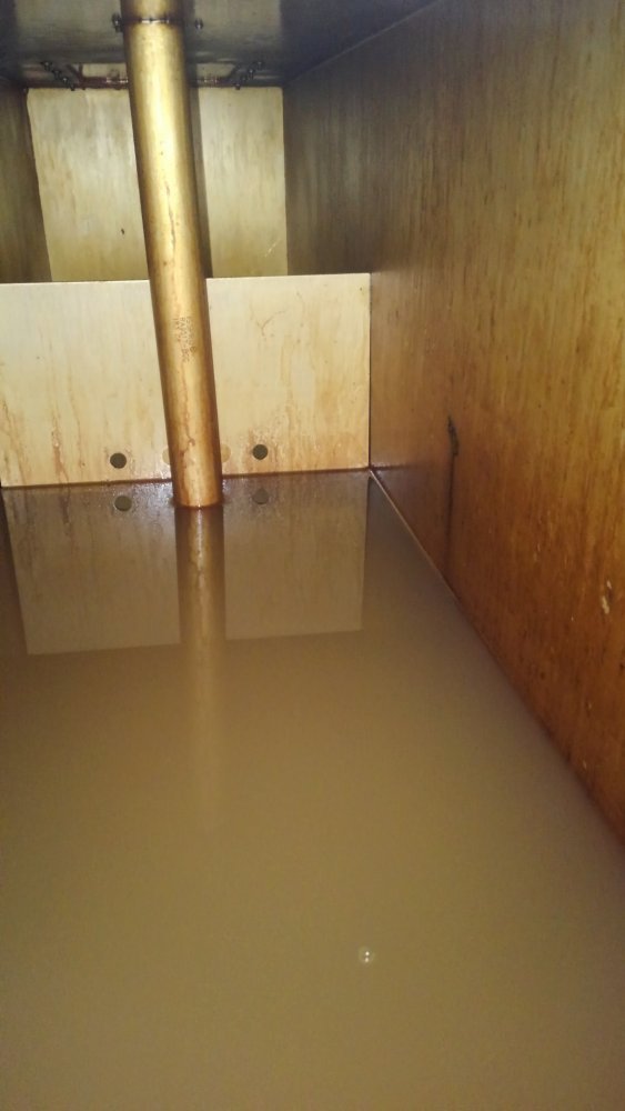

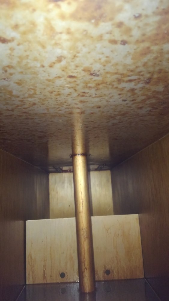

This might sound like a dumb question... The tank is solid aluminum.. why can't I just use aluminum brightness or mirac acid on the inside of the tank wouldn't that kill anything in it.. I thought about Clorox bleach but that would leave a residue
don't use any muratic acid on aluminum! that will eat the tank and make a really bad poison gas cloud!! once you are able to empty it of the fuel. wash it out with ethanol free gas and drain it. the brightener will also eat away any protective coating if it has any that keeps it from corroding.
Actually the stuff on the tank walls was in it when I got the tank.. then it sat for over a year. Maybe closer to 2 years before your it in the truck. It will wipe off if you scrub it not completely I don't think I'll have to try.... I'm almost wondering if the fuel is so Brown because I put that tank cleaner in it a week and a half ago when I filled the tank it might have removed a bunch of that staining off the tank and it's turning the fuel Brown but that's just a guess. Fuel color may also be because of all the tranny fluid in it.. again just a guess.

The diesel fuel looks to be "wet" with water or crap growing in it. The fuel tank is garbage as the bugs have corroded 'pits' in it. It's more expensive to clean the tank than it is to simply replace it with NEW. (Not some used tank that has a different infection in the tank.)
You should send the fuel out for testing to see what is growing in it. IDK and tried a product that didn't work. Several hundred in fuel filters later I tried two other products and finally got it killed. But not before it took out the entire fuel system on Patch. Me and my buddy are experts at dropping and replacing 1993 and 1995 fuel tanks quickly now. Only the newer 'plastic' tanks (say a 2005 LLY Duramax) can be cleaned as the stuff doesn't appear to stick so well.

That tank shouldn’t be that heavy to remove. Drain it out into another container. Pull it out and use the gas to wash it out. You can even get you a toilet brush and add some kind of longer handle on it to scrub with. Berryman’s B-12 that you pour in the tank will desolve a lot of crud by its self. Once it’s as clean as you can get it. Connect the feed line to the LP and leave the return going into a bucket. Run the truck or just run the LP till you have clear diesel flowing out before connector the return back to the tank.
