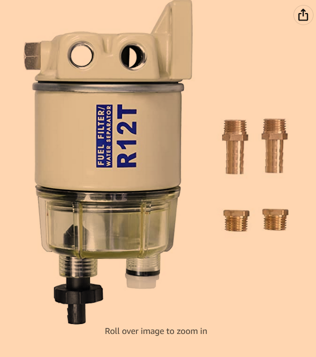

I have a 2 micron fuel filter on my truck that I got off amazon. replaced the 12 micron that it came with and installed a 2 micron. it also has a clear bowl with a water drain. I think I paid $25 for the housing and all. maybe something like this plumbed into the aux tank before the lift pump will help him?
Here is the link for the filter and housing, I have a Fleetguard FS19628 2 micron installed on this housing

On the filter for bugs- nope. 0.5 micron is size of the bugs. You would need 0.4 micron absolute- that doesn’t exist for less that THOUSANDS of dollars.
