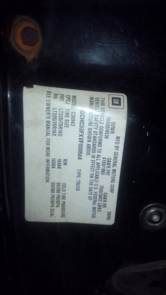

Ok now I'm confused. Ive had company truck lately so haven't messed with mine. Went and bought a roll of 3/16 nicap brake line today to redo the fronts. As I've said before I'm going to delete the ABS in the process. I ordered front brake hoses awhile back from R.A....and just compared the passenger side one to old one. It seems that the actual rubber hose part is smaller around on the new one compared to old one.. it's also smaller around than the driver side new hose.
I'm thinking something is wrong here. And also the truck is a 8,700 . Does that mean it's actually a HD. ? Someone ( @dbrannon79 ) I think.. said the the hd ones are different.. I don't want to put them in if there the wrong ones
What is important is the INSIDE diameter of the brake hoses and the hose's burst strength, not the outside diameter. Also, it is easy to tell if your 3500 is an HD - it will have a solid, one piece front axle, it will have straight frame rails with no drop for the cab - with a filler panel between the bumper and grille and will have 19.5" wheels on it. ALSO, the C3500HD was ONLY available as a cab & chassis and NOT for direct sale to the general public, rather it was designated for either fleet sales or to upfitters for installation of a dump bed, flat bed, service box, bucket platform, etc.
Read what I posted. What makes it an HD is its straight frame, solid front axle (one piece I-beam with leaf springs on each side) raised cab with the wide filler in the space between the bumper and grille because its raised and 19.5" rims.
The picture of that door sticker is for a plain old 3500, NOT a 3500HD! First dead give away is look at the factory tire size, 16" rims!
@Husker6.5 is right for a true HD. your's shows 10,000 lb gvrw which is the heavy version of the standard 3500 series. they made three versions of the normal 3500 series, 8700, 9000, 10,000lb. Mine is a 9000lb
Are the ones you bought from RA AC Delco? if so they should be the right ones. ones you have on the truck now if they were from "Vato"-Zone they most likely are aftermarket and are made a little different. most important thing is the length and inside diameter. I recall you mentioned that the ones on your truck now seem to stretch out when you jack up the front off the ground. they should not do that. there should be enough hose to allow the front suspension to move full travel up and down without stretching or kinking the hose.

Thank you @dbrannon79 . That's what I was trying to explain was that it's the heavier duty version. Until you pointed that out I didn't know there were different versions.. this is a problem because before when if buy parts at AutoZone, there computer does differentiate .. some of their parts will say except 10,000 pounds. We never knew there was a difference so we always got the others not the 10,000. Which Now can be one hell of a problem. I'm 5 years of buying parts I have to wonder what all is not the right parts that I have put on that truck.
