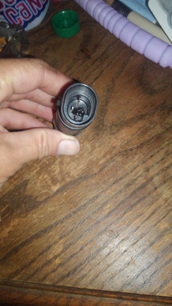

Or maybe not.. the ops only has 3 wires evidently judging by this plug... You were talking about the pump 5wires not the ops.. my fault

no the relay you add to the mix will have 5 wires. the ops only has three. to add the relay you will only use one of the wires from the ops and run it to the relay by cutting it into two (one from the ops and one to the pump) bringing them to the relay you add. iirc its the brown wire.
to explain it better, the one wire you cut on the ops plug will make two, one going into the ops with the other side going to the pump in the harness. you would splice a long piece of wire to both ends you cut and run them over to where you decide to mount the relay.
the relay is like a switch but will only use the power from the ops sensor to turn on the relay.
the relay also receives a hot wire from the fuse box ( 3rd wire ) which when turned on by the ops, will send power from the fuse box down to the pump.
the relay also needs a ground for it to operate as a switch. that is you 4 wires.
the 5th is for extra function like the ability to manually turn on the pump or have it turn on and prime while the glow plugs are warming up.
I hope that makes better sense.
the ops plug has three wires. wire 1 is hot. wire 2 is going into the dash for the oil pressure gauge. wire three goes to the lift pump. internally in the ops sensor it does two things. it sends signal to the gauge to show pressure and it also sends power to the lift pump when oil pressure is above iirc 5 psi by a couple of very tiny contacts that tend to burn out and stop working.

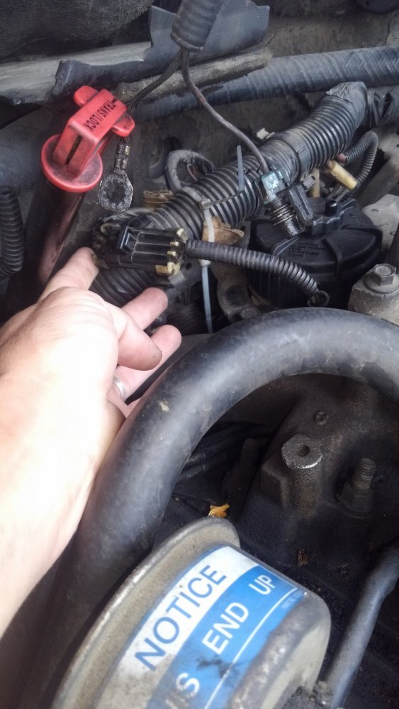

From what I saw online. I've got to remove the ffm to get to it.. which I have in order to do the fuel lines anyhow... I'm going to go buy long black fuel rubber hose. Not the metal . That way it's plug and play.. so when I have the ffm off I'll change the ops. And put in the one sent to me.. don't know if this is actually the problem or not but worth a shot. Unless the wires got damaged.. that would be harder to figure out

If your going to replace the steel lines with rubber going from the FFM back to the lift pump be sure to get diesel rated hose and make sure they are secured along the inside of the frame like the steel lines are. Keep them away from heat sources like the exhaust pipe and manifold too. You might need to get some heat resistant covering for it up near the engine. That will help greatly for heat and for rubbing in vibration areas.
Replacing any of the hoses from the FFM to the ip will require you to remove the intake. I would suggest re-routing them over the intake. The one supply line under there that feeds the ip is a preformed hose and trying to use regular fuel line will cause kinks where it bends.
The drain hose to the tee will need to remain under the intake so it’s lower than the filter and will drain properly
HVAC rated copper tubing from the hardware store? just thinking outside the box here, but it's easy to bend and shape, resists heat, and will hold the pressure from the LP easily. won't rust out ether. others may chime in on this, but I think considering the cost of a 25' roll of diesel rated fuel hose it's probably about the same price and will last longer! you'll only need hose and clamps at the connections. keep a short piece of the factory steel line that has the fitting on it to connect to the lift pump connecting it with a short section of hose and clamps!
