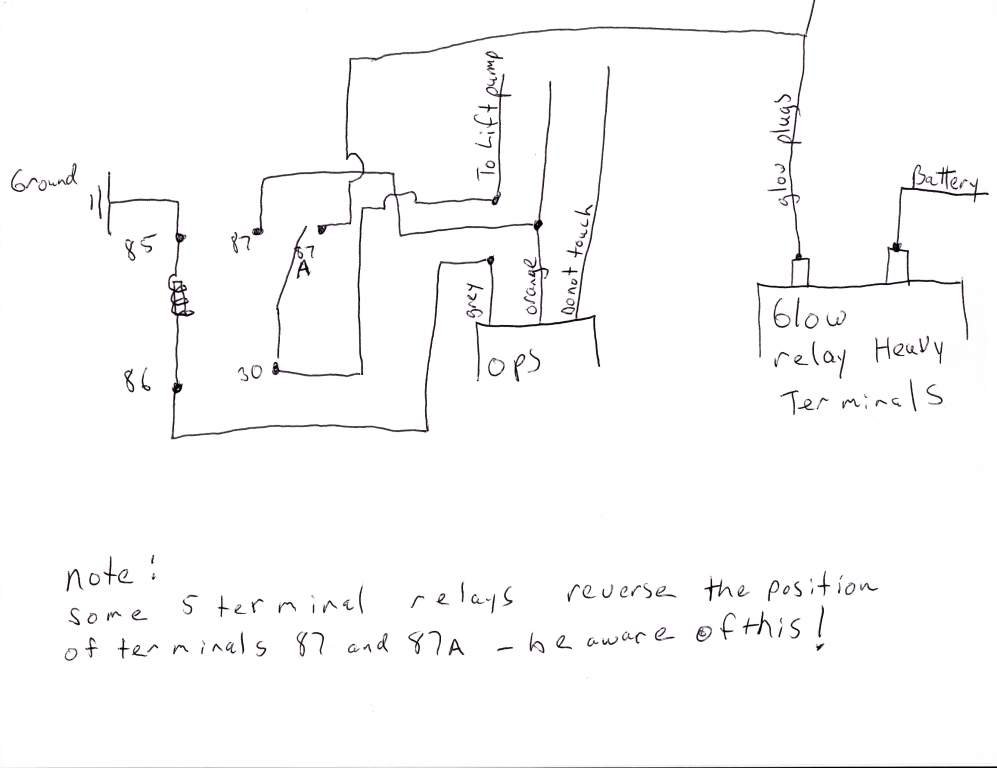

If the lift pump is running I wouldn't fire the lift pump relay upgrade canon unless it's 1995 or older. If it's 1995 or older I would definitely do the relay upgrade@jrsavoie I agree but the problem comes and goes.. it will run great one minute and then like shit the next.. that do testing it might show fine at that moment but 10 seconds later it's shitty again.. I can turn the key on and get under the truck and feel the lift pump running. And most of the time I can hear it from in the cab before I start the truck. Because it runs for 8 or 10 seconds while the glow plugs are warming up. .. honestly at this point it's seriously a matter of addition firing the parts cannon at it constantly until I happen to get it right
