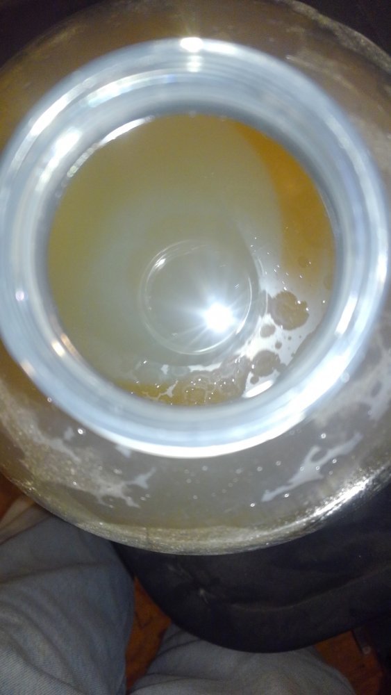

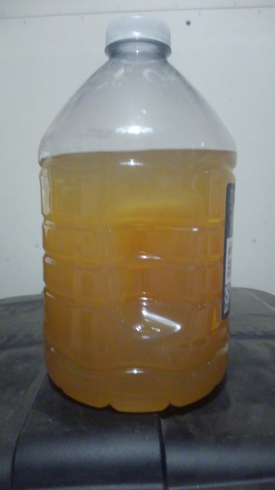

ok that makes sense. next question... lol@dbrannon79 it's in the scrap yard.. I took it out because the liner was flaking apart in it.. I kept finding shiny little flakes in the filter when I'd change it. Pulled the sending unit and looked in tank. It was full of them. I think I posted pics of it inside on another thread.
