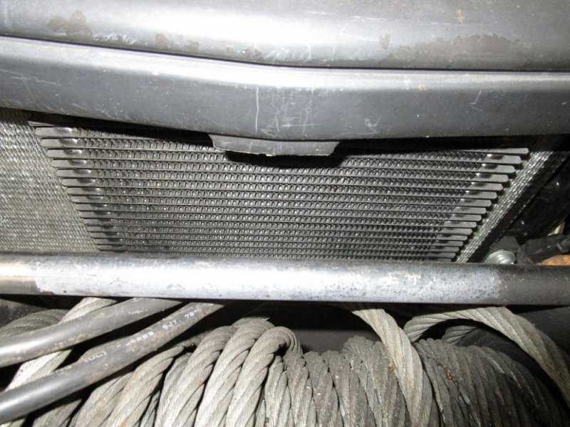

@FellowTraveler Nice setup! I'm defiantly gonna have to try rearranging my oil and tranny coolers to fit one of those in there!

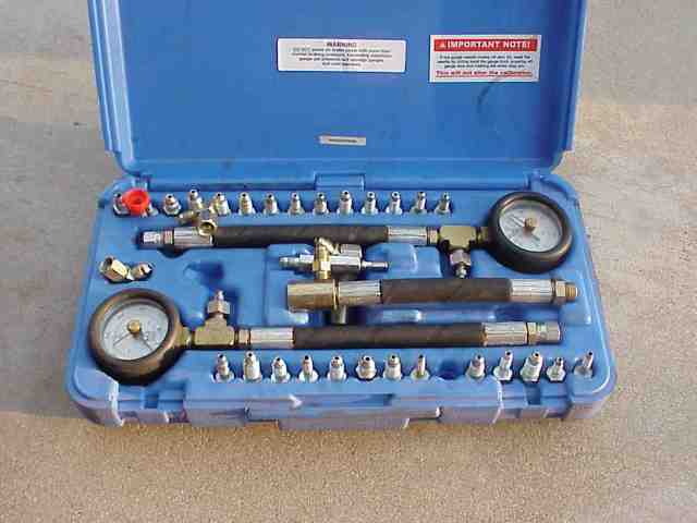

I'm a little nervous about disconnecting the HB and dead heading my pump! they use this gauge testing the big rigs and stetting pressures on equipment hydraulic pumps. at least my head won't be under the hood when it cranks up lol

Just got back from running errands. I figured this thing is gonna nag me in my mind so I grabbed the gauge. disconnected the line going into the HB and hooked up to the gauge. and stuck the hose in a spot so in case it whipped out with the pressure (me being nervous and paranoid) cranked up the truck and looked at the gauge. 1700psi... and the pump didn't make any growling. hmm.
this is interesting to me. connected the line back to the HB and worked the steering and the growl came back.
ok, I guess since the pump is putting out more pressure than I expected and I'm stumped over it, Ill just leave it and let it howl till it dies i suppose.

That is high PSI and requires a good sized cooler...

I can get some fittings to connect a gauge inline but I know we don't have a flow gauge here at work. I'll talk to one of the hodraulic shops and see if they have one possibly. what kind of pressures should I see with a gauge inline?
I'll also order a filter for the return PS hose and look into a larger cooler. braking seems to be ok now. allthough if I have my food on the pedal and shut the engine off, the pedal will fall to the floor. otherwise it stays at about half when holding it.
Generally,1.2K to 1.5k or 1.7k+ p/s performance psi & 2.0k to 3.0k psi @ caliper...w/foot into it.

when I connected a gauge to the pump outlet it deadheaded and held steady at 1700 psi and didn't seem to howl but that was at idle.
