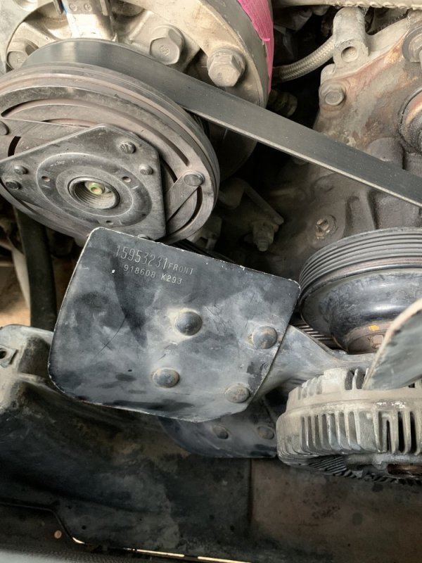

Thanks guys. I have another question while screwing with my truck. Take a look at this photo of my fan blade. Is it installed backwards???

I think on my last post I figured it out. It’s installed correctly.
No. it's not installed correctly! Remove it and place the 6 blade fan and the 6 bolt fan clutch in the Scrap Metal Pile!
Get a 9 blade fan from a 1998 model year and four bolt fan clutch. Or a 2002 Duramax fan and 4 bolt fan clutch, but, you may have to trim the shroud. I have recommended Kennedy Diesel's low temp clutch in the past as it helps.
If you want to go further replace the water pump with a HO balanced flow pump thread on fan clutch style. You will need the thread on fan clutch as well.
Now is the time to make the call on the water pump being four bolt to fan clutch or thread on. The thread on is the better pump for balanced flow.

Oh my! I didn’t know anyone still had that fan around. WW is right, get that fan in the recycling can asap.
6 blade fan is a joke. Get a 9 blade fan on there at minimum.
My opinion is to do balanced flow spinon with AK dd shown electro viscous. But short of that at least get a good fan on there. Make sure the direction is right because the original 4 bolt pumps were v belt and opposite direction of serpentine belt

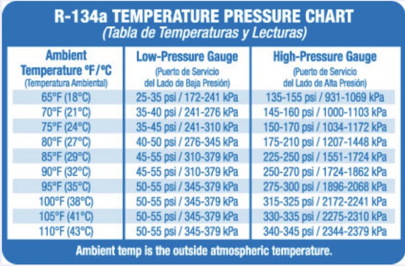

I’m testing my ac right now to see how much the condenser fan is helping. About 87 degrees outside At idle fans on max. Ac pushing 53deg. Condenser inlet temp is about 125. Condenser outlet at 118. Low pressure 34 high is just under 200 and the evap drain pushing water out like there’s no tomorrow! Trying to determine if I need a little more 134

Remember the 9 blade that fits the spin on clutch does NOT fit clutch for the 4 bolt.

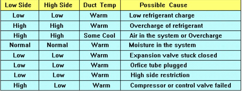

So you said 87 outside, 37 low,200 high. Look at chart above. You are low on 134a, most likely. If charged by weight is correct then you have one of the lower problems listed. But since you have such a spread between high and low pressures- i think low on 134a
Ok- your post popped up same time as mine.
now 90% convinced you are low. 10% chance the blower is not moving enough air across the evaporator inside the dash. Does the airflow blow your (or your wife’s) hair back like it should?
Like in your house if you don’t change the air filter, everything else can be perfect- but plugged filter will cause an evaporator to freeze up. Guessing your evap isn’t plugged because you said you recently replaced everything.
on edit- by time I finished typing, my odds went up to 94% low on 134a, 6% other.

You will need a new fan clutch. It's 6 bolt fan 4 bolt water pump: 4 bolt fan 4 bolt water pump: 4 bolt fan thread on water pump.
Pictures and count the bolts holding the fans on the clutch.
