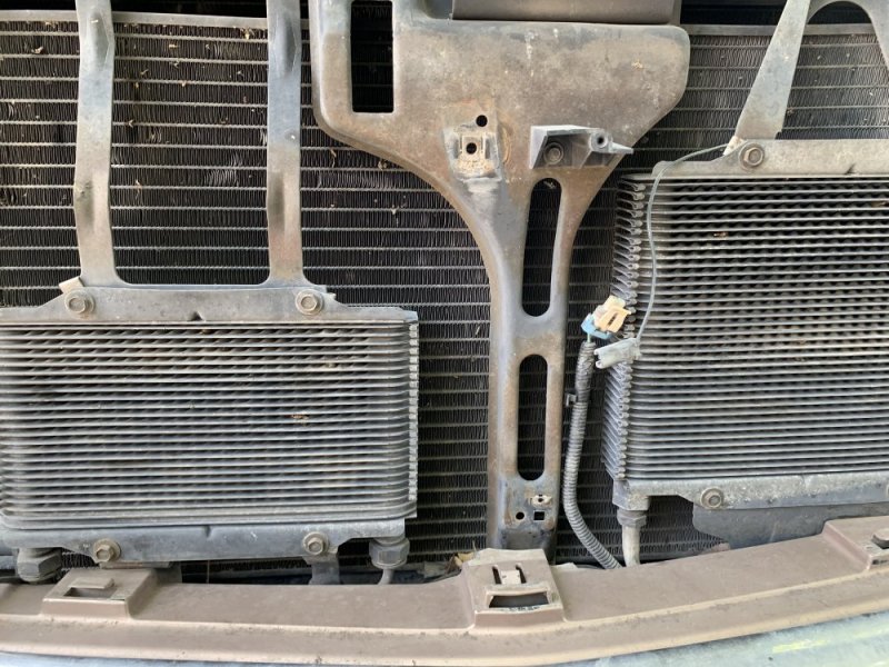

Hey guys. I was just fooling around today. Had ordered a condenser fan that I think should be slim enough to fit behind the grill to help the AC out while sitting in traffic. Also to do something with the stock PS cooler. But I have a question. I removed the grill and the horn to make room for the fan and discovered this two wire connector here between the oil and trans coolers. Does anyone know what it’s for or should be connected to?
