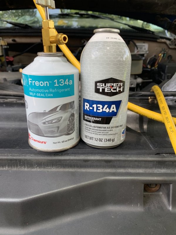

Make damn sure the can doesn't say anything about a leak sealer!!! Return it and DO NOT USE IT if it does! Open the system with a leak sealer and you throw away the entire system, evaporator, hoses, everything.
Don’t see anything on it to mention leak sealer. Here’s a photo
