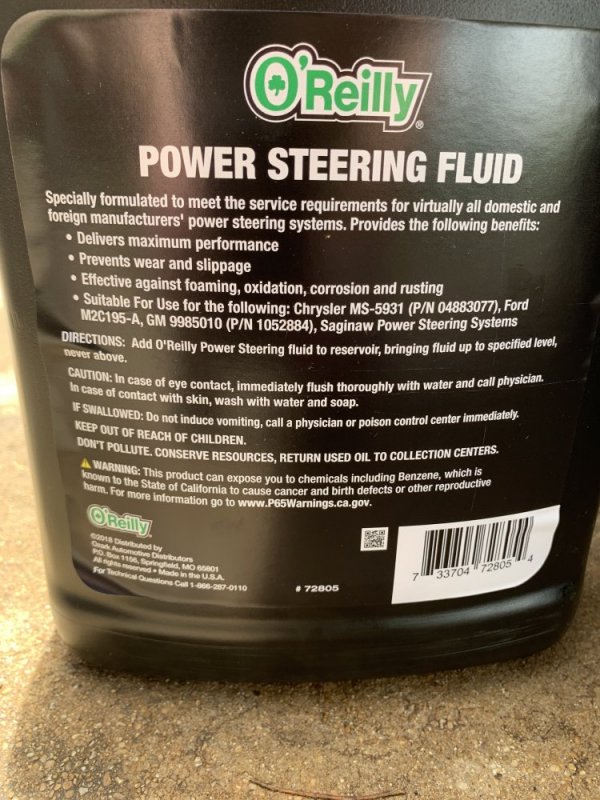

About to get started on flushing the PS fluid. Went to pickup a gallon in town. All AAP sells is Fram and I’m skeptical of it, stopping by Walmart and all they have has stop leak in theirs, so I settled with O’Reilly’s since their bottle actually specified the GM part number 😀. Also grabbed a short wide opening funnel to help pouring from the gallon jug!

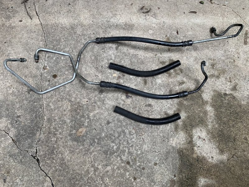

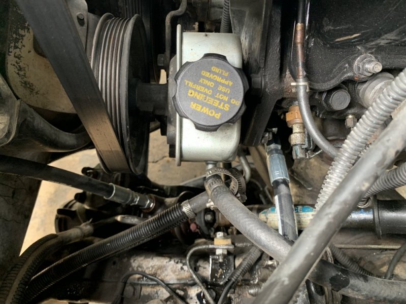

I just got the new lines I had made installed. Topped off the pump and tried it before I started flushing. The steering actually feels a little better! I reay won’t know till I drive it and get things warmed up though.

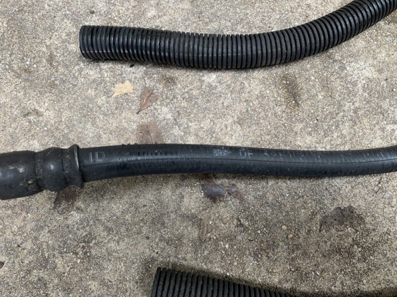

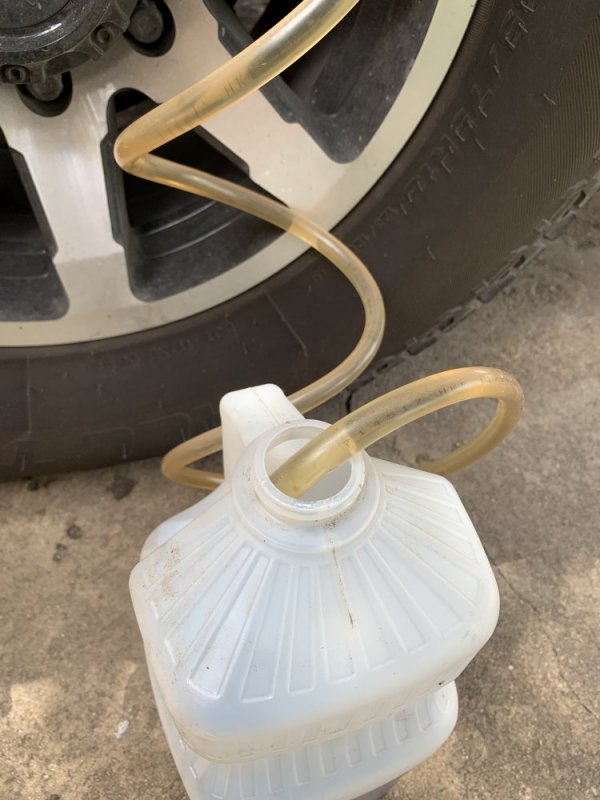

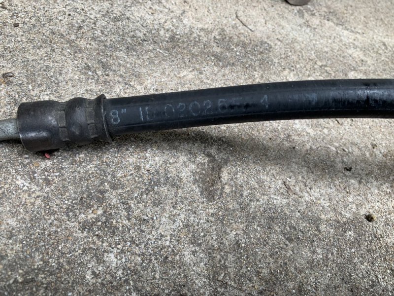

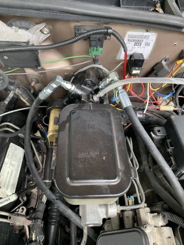

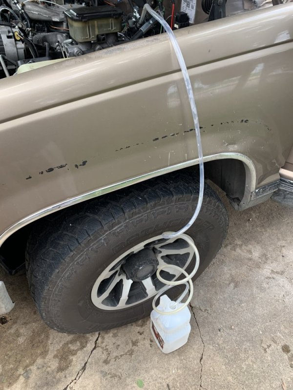

I took some photos of the new hoses installed and some of the old ones. Can y’all tell if these are the original ones? The rubber is very flexible as if there swelling from the oil. Also a photo of the bottle of fluid and my flushing setup all ready to go!
I just came inside to cool off, drink some iced tea and re-read the flushing procedure posted by btfarm

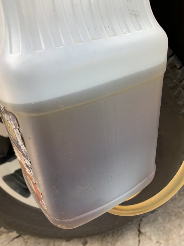

Got is all flushed. I followed the instructions in btfarm’s how to thread (thanks for providing the info). The fluid came out had a reddish brown color but didn’t seem terrible (photo attached)
upon following the instructions it was said to start the engine and press the brake pedal down holding it and turn the wheel 1/4 turn in ether direction stop, refill and go again. During that process I noticed that at about the 1/4 or so turn my steering would lock or seemed to bind up. Releasing the brake the binding was gone.
Is this normal for the steering to do that?
after I went through about 3/4’s gallon flushing. I but everything back together, topped off the pump and tried the steering and pedal in the driveway. Flushing didn’t seem to change anything but it seems better with the new hoses
I also repeated the pressing on the brake and then turned the wheel and again at about a 1/4 to 1/2 in both directions the steering wheel would lock up where I couldn’t go any further unless I let go of the brake!! Is this a sign of low volume flow from the pump?

Brakes are more important than steering. The hydrobooster gets the PS flow and pressure FIRST. It can hog it all and leave NOTHING for the steering box. Air won't compress and flushing the system can put air in the system. Further attempting to charge up a bad accumulator in the hydroboost can screw the works up as it takes all the flow and pressure to charge up regardless if you are on the brakes or not.
