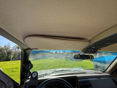

A friend has one of these in his wehicle. I so much would like one of these units after seeing the one he has and how it functions.
Seems they are for now NLA.
Has the CD/DVD slot too.
