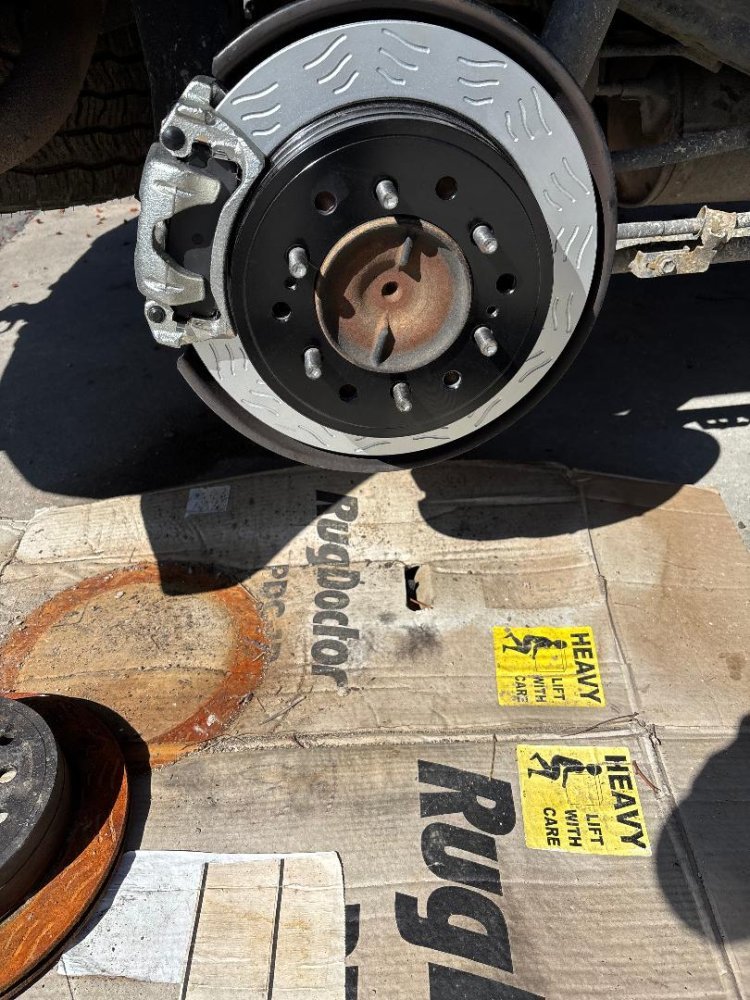

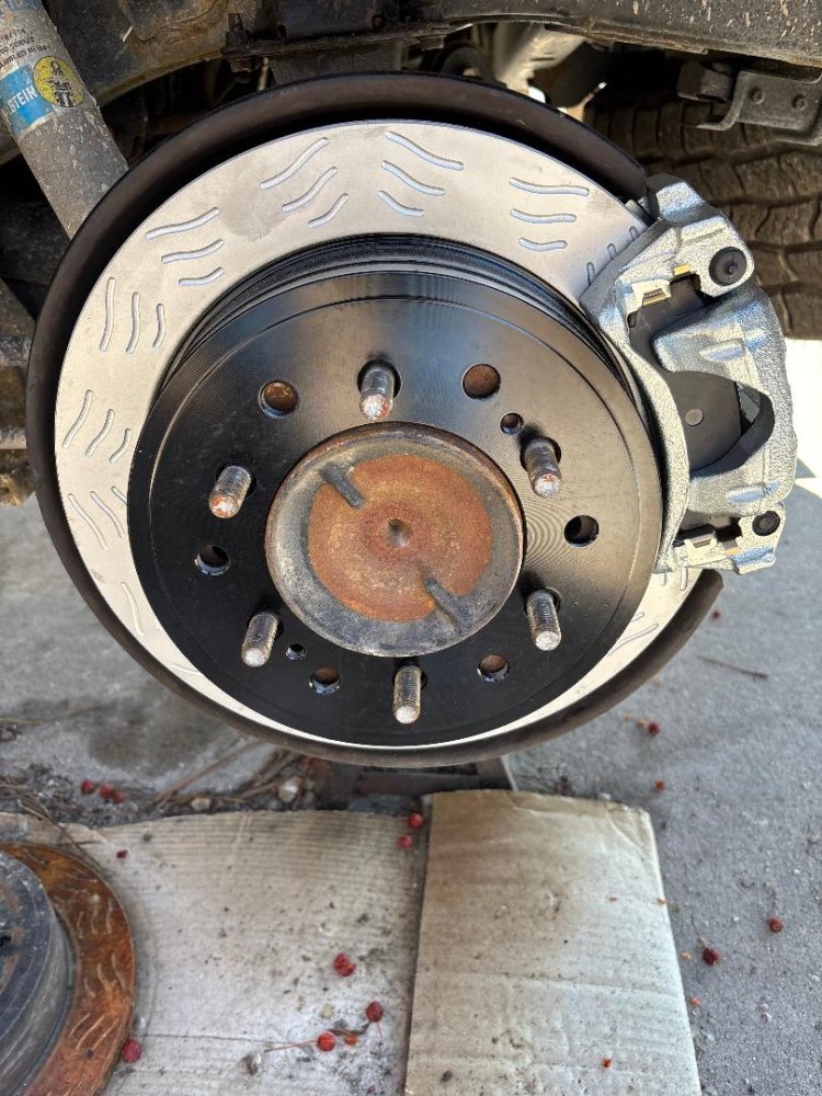

Started on rear brakes on the 2014 4Runner after arriving at our Montana home. Encountered problems loading the pads into the calipers and ended up breaking off half the friction material on one pad. The tabs on the pad just would not go in on the piston side of the caliper. The calipers are Raybestos remans. Probably should have ground material off the tabs on the pads.
I have new pads ordered at the local Napa which opens at 10:00 am.

Nope!! Full stop! Post pictures, preferably video. You should never have to grind away material to make it fit. Something is wrong and needs correction.
I once had a car that I installed some aftermarket pads on that had little rivets in a slightly out of position place. It destroyed both calipers.
If you try to grind away pad thickness you will not get it truly square to the backing plate without using a milling machine. This will force the pad at an angle and will side load the piston of the caliper. At best you wear away more of the pad having less stopping capacity until it is all flat again. At worst the sideload of the piston will score the bore and you get to buy new calipers, or need to panic stop before the pads is even and use your bumper to complete the stop.

YUP, with Will L on this. If left as is bad things could happen.
I got one set of pads loaded into the calipers. Should not have been doing this after 12 hours of travel by air and car from SoCal.
Calipers came with spring clips as did the pads. I went back and forth with the clips to see which would work. Went back to the caliper clips this am and got a set of pads loaded. Doesn’t help as I only have 3 pads from that set. I’ll bring picking up a set of pads from Napa in 1/2 hour. I’ll try to return the set with the broken pad to RockAuto.
