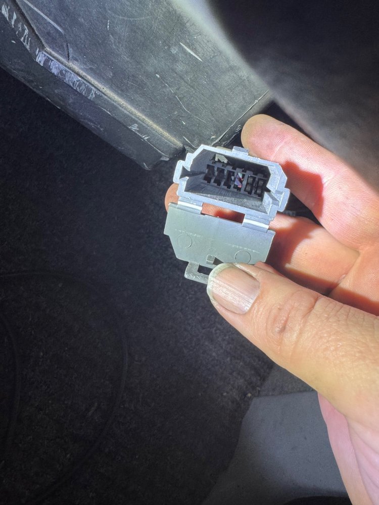

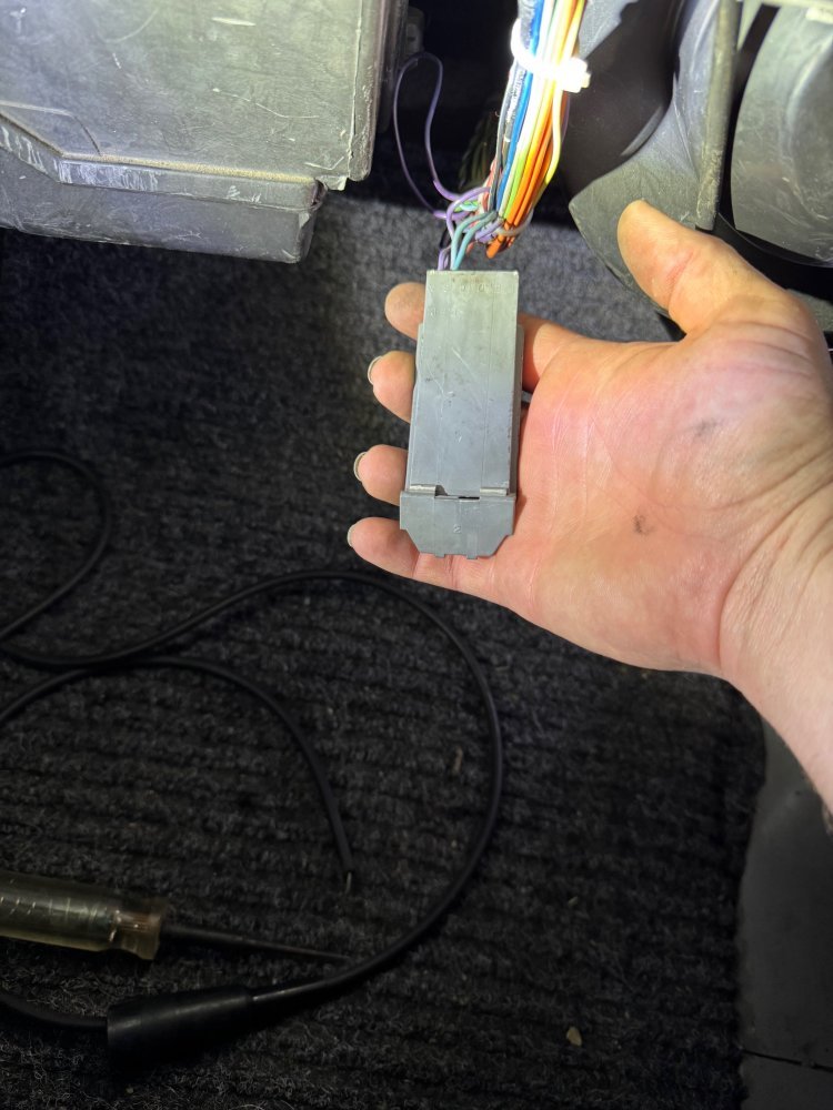

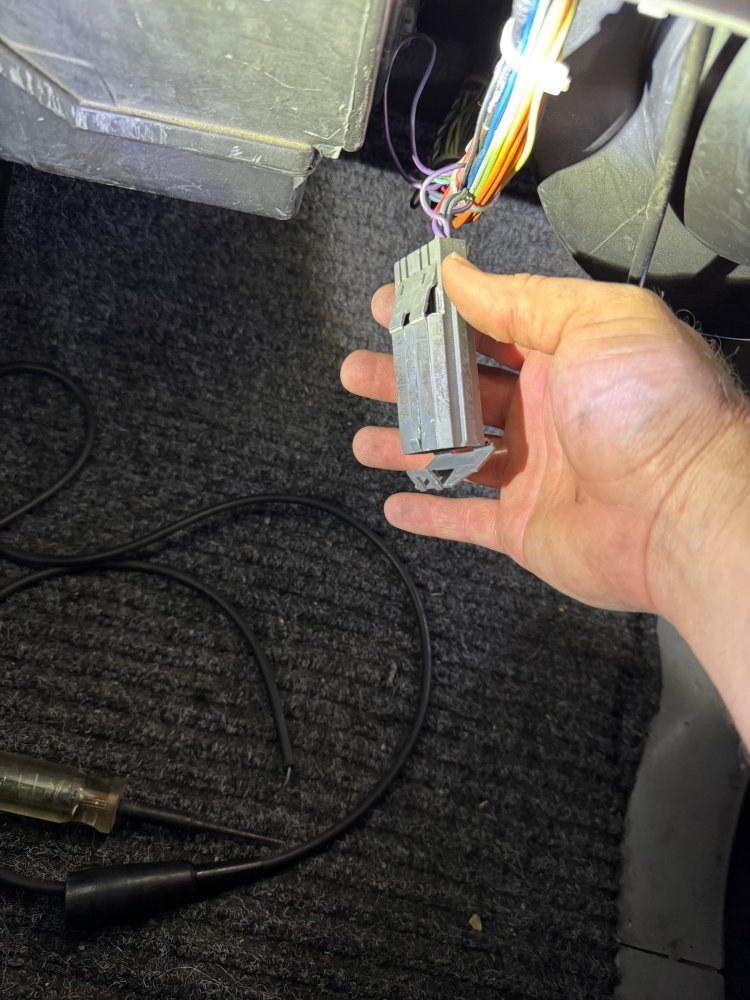

while I was in there I found this little grey long box of sorts with two pins as if something slides in there and plugs in to it. it located in the harness down by the blower motor. anyone know what this thing-a-mobob is or what it was used for?

Did some other minor repairs on the 93 prepping for the trip next weekend. my blower quit working on medium speed. checked all the relays and finally deemed the resistor at fault. got that fixed.
View attachment 93499View attachment 93500View attachment 93498
I believe that is referred to as the vent box.
When it becomes necessary to let smoke out of the wiring then You open that lid and let it flow. 🫣😹
Found it. did some searching on the innerwebs and apparently it was for a diode back that has something to do with 4x4. one wire comes from the brake switch and another to the 4x4 switch, rear ABS and TCM. all the wires are there but no diode back inside. this truck is a 2x4 so I guess that makes sense the box is empty
