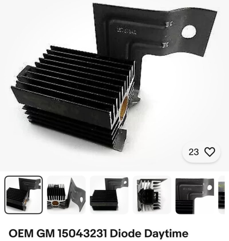

This evening on eBay I purchased a new daytime running light module for my 96 Chevy truck.Total cost was $96 delivered.I bought the same module for my 96 gmc truck last year and the new replacement made the daytime running lights function again for the first time in years.
