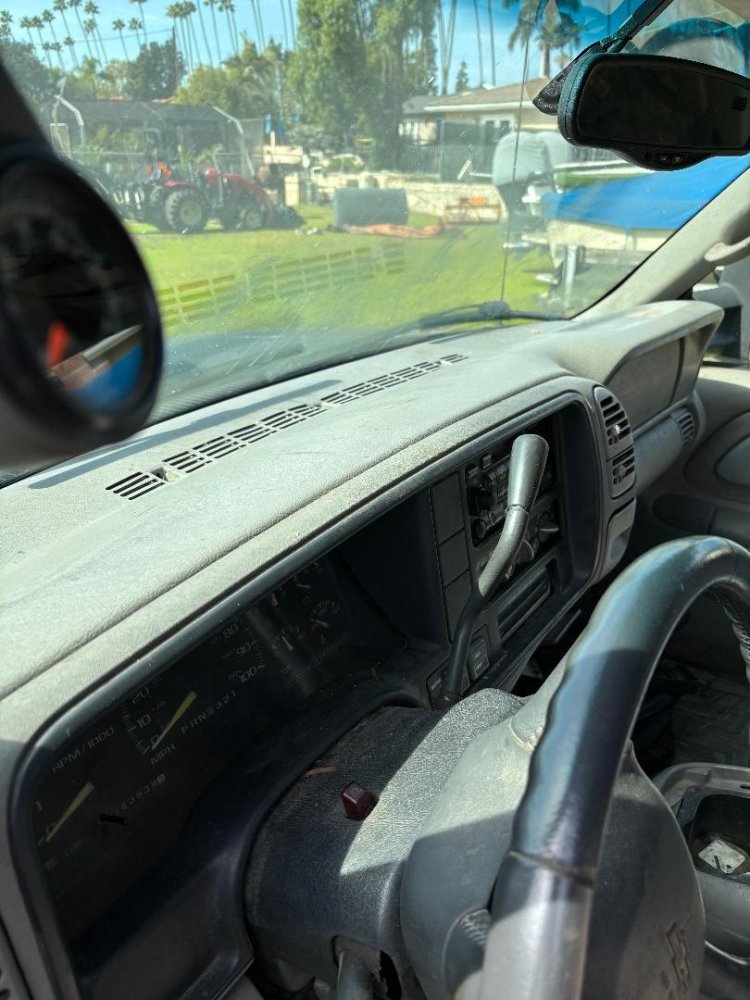

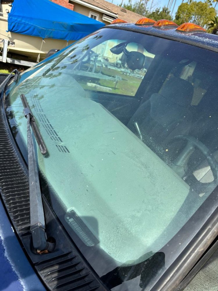

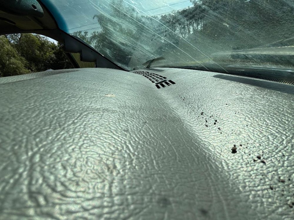

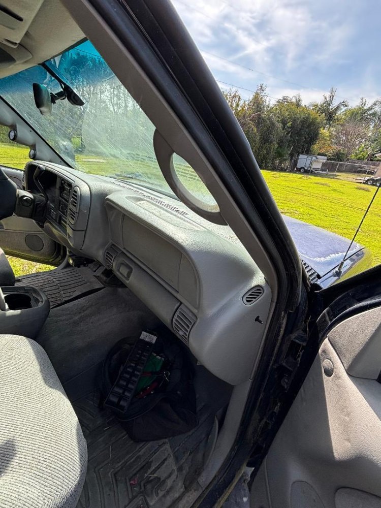

Installation of the Dash Skin is completed on the ‘99. I tried to fit the suggest 3D printed carbon fiber fiber strengtheners over the Dash Skin, but they never allowed the attaching screws to bite, so they were not usable. That was $40 plus $24 for the can of great paint wasted.
The Dash Skin came w/o holes for the screws, so it was not designed for the screws to go through it. As all three of my screws had broken through the original dash, I needed something to hold it. So I drilled the Dask Skin and was able to get 2 of 3 screws in. I will revisit the third.
The Dask Skin does as billed, but it is no the structural end all solution for the dash. For that I think you’d need a replacement dash. It looks good, but not sure it will stop the rattling.
