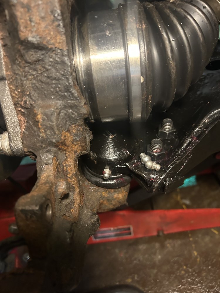

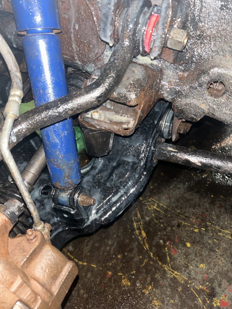

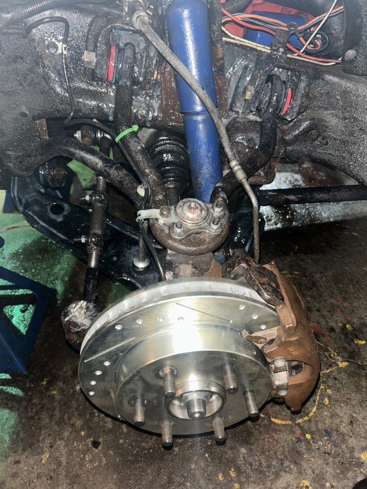

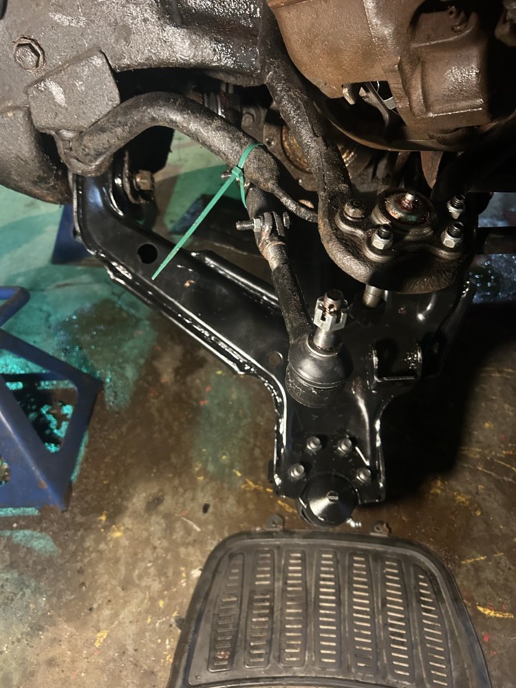

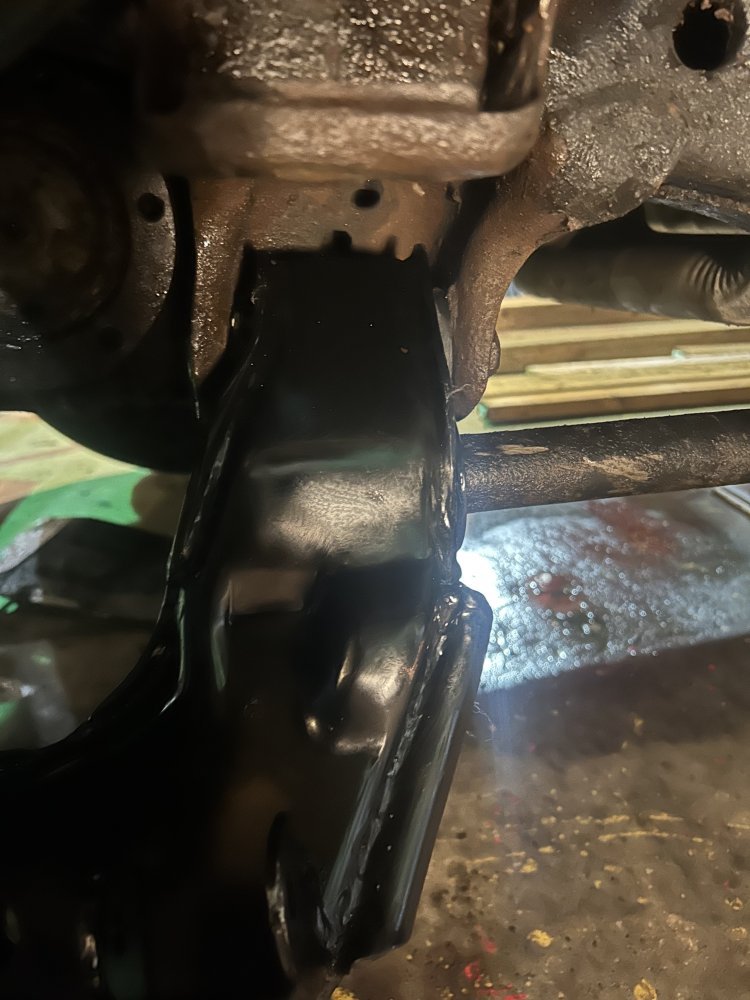

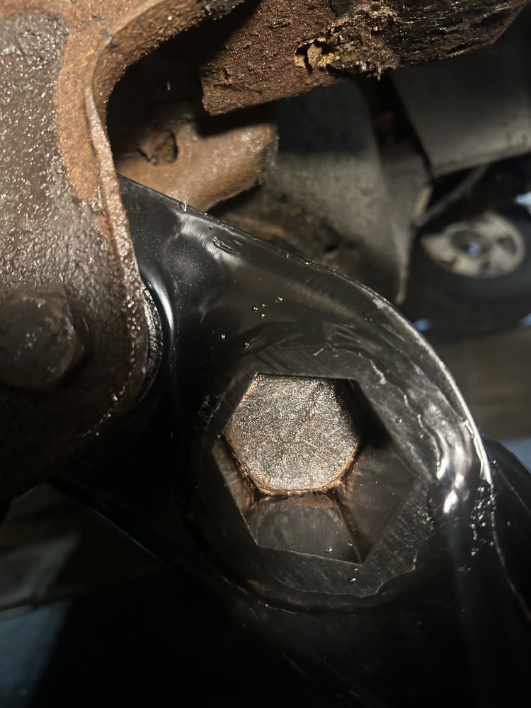

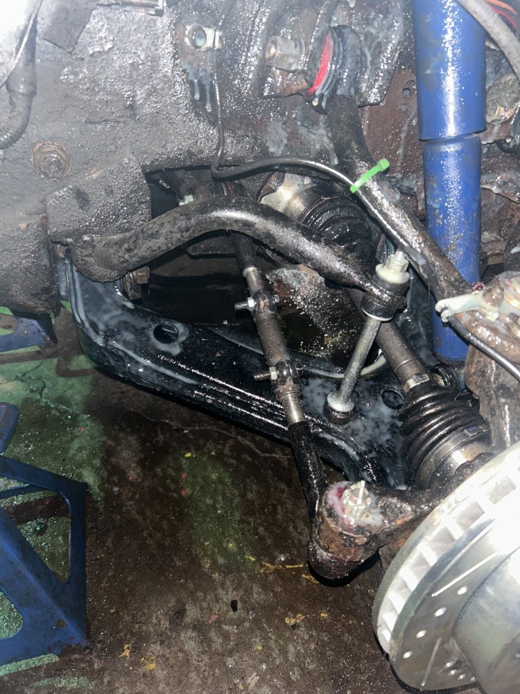

I’m going to talk to you about doing Energy Suspension bushings in the uppers.The lower control arm is in along with the energy suspension bump stop.I have to say this control arm fit beautifully.Absolutely zero issues overall.One of the easiest I ever installed.No need to hammer anything in place.It fit like a glove.It just glided into position.
The only thing I had to change was the grease fitting that was supplied.I simply changed it out.The reason being was I could not make a complete left turn because the fitting was sticking out too much.Now there’s no interference.I put some rust check on the areas after it was assembled.Its the coat and protect product sold here in Canada.Its very similar to fluid film.
I didn’t mess with the bushings in the new control arm.I had prothane poly bushings here that would fit but I just decided to leave well enough alone.
