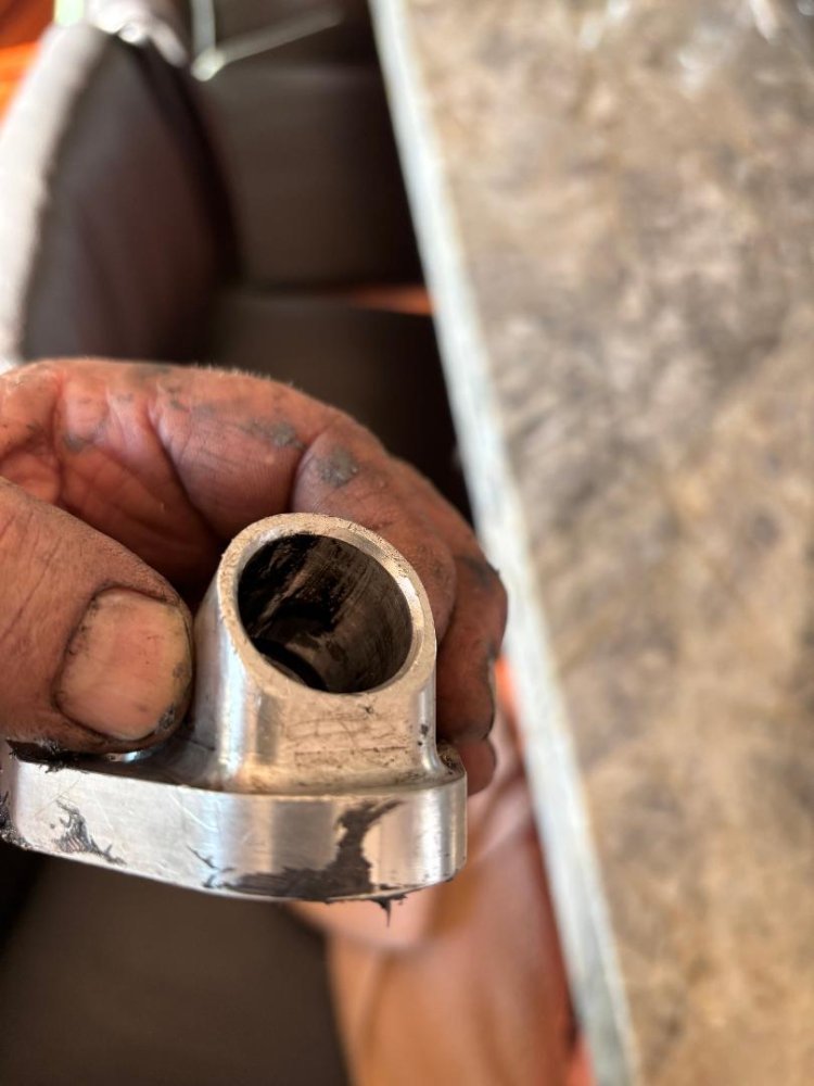

It was made for the GM turbo charger. Easy enough to make the adaption, bored the oil return flange bolt holes a size bigger. Maybe now 5/16ths or 3/8ths.
The bore does have a chamfer in it:
Spent 5 hours on the turbo drain line tube install. Had to use a second drain line because the pre-bend in the first was never going to allow the install. Ended having to build the tube assembly from the engine up to the turbo. Install new tube to plate. Install plate to engine. Install tube to turbo.

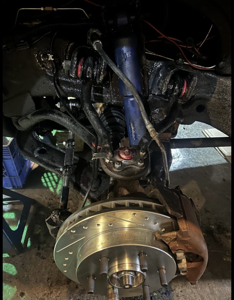

A few nights ago I finished up the driver side ball joint's on my 96 Chevy K1500 with the 6.5 along with tie rods,cv axles on both sides among other things like control arm bushings,eccentric bolt kit,wheel bearing and new rotors from Amazon.Acdelco brake pads were used as well.Thedirt/dust seal on the backside of the steering knuckle is also in place.Its a SKP seal.The ball joints are Delphi brand with prothane control arm bushings.
The last thing I need to do is install the new pitman arm,idler arm with idler arm bracket.It’ll probably be another couple weeks before I get to do that.This truck also has the stainless steel brake line kit that I bought from eBay a few years ago.This truck just needs the body prepped for paint and then it’s road ready.

Looking good.
Thanks Big T.I have the Napa fleet brand pitman arm and idler arm.Looks to be way better built than their proformer line.
I used a product similar to fluid film in around the back of the upper control arms where the bushings are.I figured it would be easier to apply the product on the chassis with the control arms out ahead of time.
