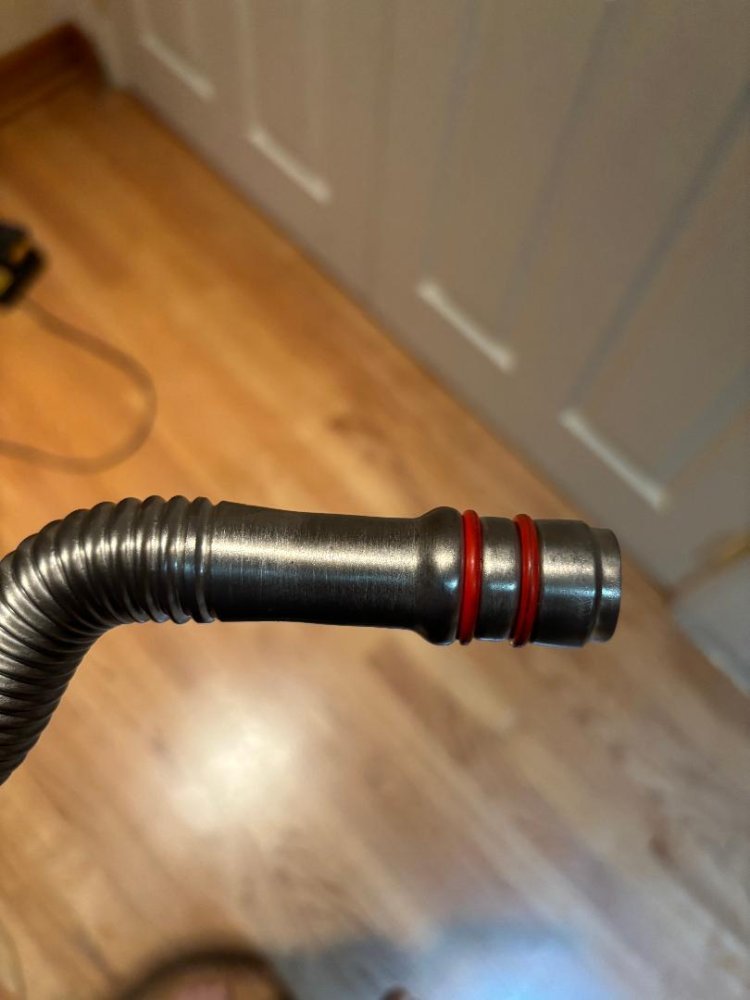

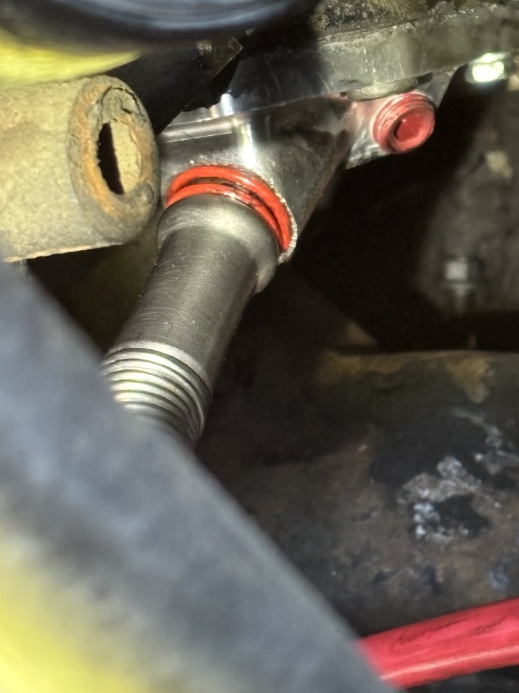

Installed a turbo oil drain kit from Quadstar on the ‘94 K2500 Suburban. Mostly went well, save for the final step of installed the tube into the block plate. There are two o-rings and the first one kept sliding up out of its groove when it should go into the block plate. I think I should have first installed the tube in the block plate, then install the block plate onto the engine.
Spent hours on this and finally gave up. I’ll have some rework to do down the road after this brief trip to Montana. The intention is to finish this with a Pro Vent catch can that continuously drains into the engine. It also cleans up a chronic oil leak on this truck.
it kinda looks like that o-ring might have swelled up or is slightly too large. try using a smear of di-electric grease on them when going in.
I greased it with Honda special grease. It looks swole because it is no longer in its groove. It is on the wider part of the pipe. The other o-ring is in its groove.
The issue is angle of attack. I’m not getting a truly straight shot into the block plate. The tube is bending around the exhaust manifold which makes it near impossible to get a straight push into the block plate. The result is the o-ring gets pushed up the tube.

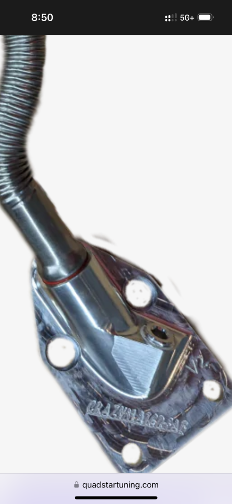

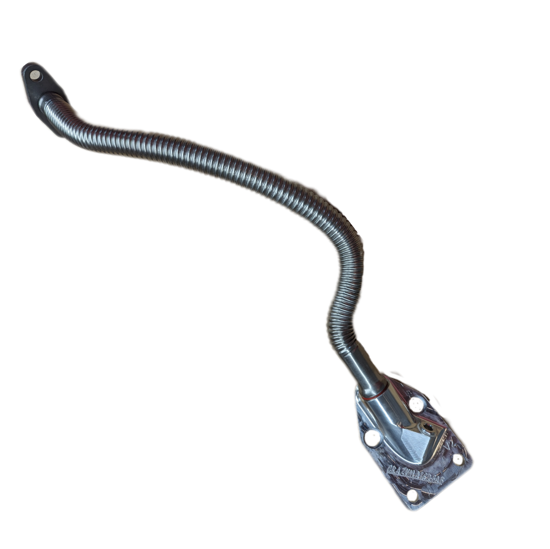

I have two kits. Here’s what another pipe looks like:
How does that pipe fit the installed receiver ?
Another alternative would be to remove the receiver plate and die grind a chamfer in the top of the bore.
I have the earlier kit installed on My truck.
The receiver on Mine is a rigid pipe mounted to the plate. It sticks up and out away from the exhaust manifold.
It was made for the GM turbo charger. Easy enough to make the adaption, bored the oil return flange bolt holes a size bigger. Maybe now 5/16ths or 3/8ths.

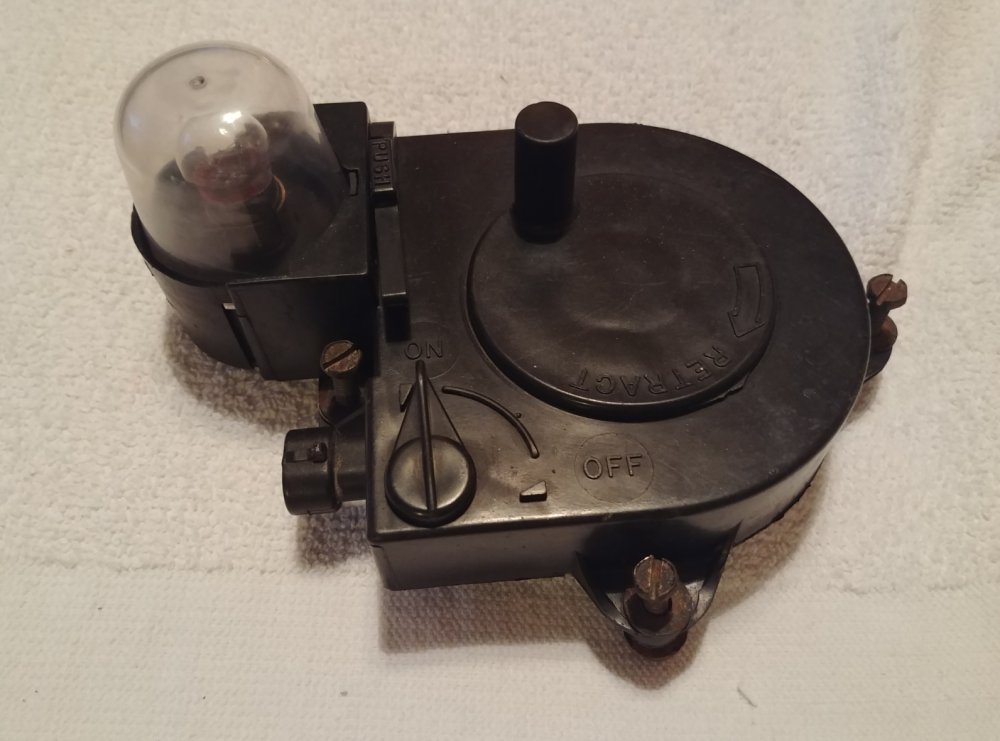

Hey all: idk where else to ask this but since it is a gmt400 part I figured here is ok.
Do you guys know what years this under hood light was on? I remember them on gassers and iirc diesels too. It mounted on the fender well iirc. The light is on a cord that unrolls and turns on automatically when you unroll it.

I robbed one from a 1988 K1500 and My 1993 had one.
I’m not sure about the 95 year trucks. Seems I seen on a little newer and it was a little different.
Maybe if there is one at the JY I’ll get it and find a position under the hood of the2000 K3500 to mount it.
I never did use the one on the 93, I just thought it was a mighty cool accesory.

1996’s had them mounted on the firewall next to the Coolant bottle.
If the sizing works out right, I've had good luck with a unibit/step bit or countersink bit for chamfering a hole.
I've never gad much luck with those rings not leaking. On similar stuff I welded a coupling or nipple on or threaded it.

It seems that it was on 88-95 GMC's from what I can tell. I found this thread on the innerwebs about them
I have one under my seat I'd like to install at some point, just haven't gotten around to it. I wonder if this was an optional package from GM or if we can find a GM part number for it.

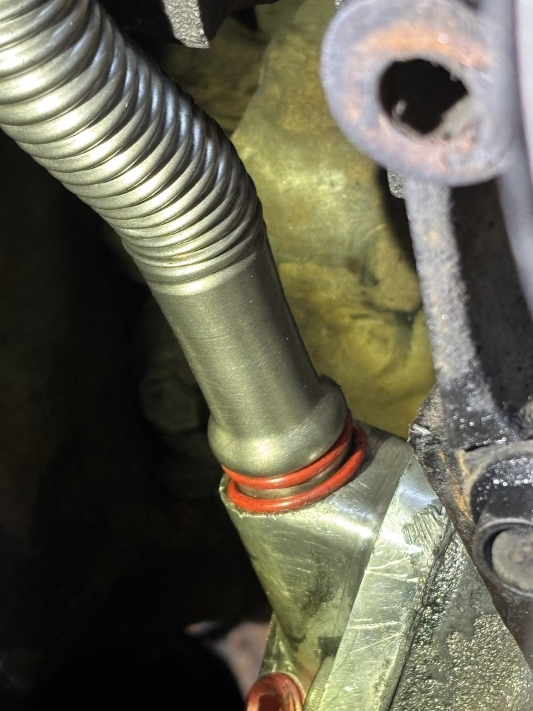

It fits snugly into the block plate. It takes force to get it in. On my ‘99 it was a PITA. The second o-ring never goes in and simply rests on top of the block plate. The first one does need to be pushed into to the block plate which is where I’m having trouble.
which oil drain kit is this one?
Here’s a pic showing how the tube should sit in the plate:
