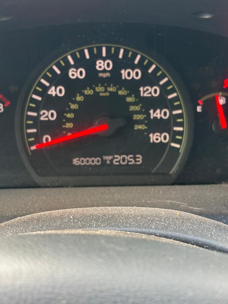

Yesterday I reached 160K miles on my 2005 Honda Accord:
I use this car to go 3 miles one way to the train station when I go into the office. That and errands to the supermarket. So it’s hard to get a lot of miles on this car.
